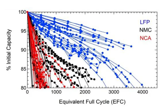

I typically charge to 70% daily, though infrequently to 85-94% (or even 100% if I actually need it) for the odd longer trip. Most days I don't dip below 50% and I charge daily. As someone else mentioned in this thread, Engineering Explained and others have some good videos talking about various lithium battery chemistries and the smaller the range of the battery typically used the better and somewhere around 50-70% is kind of "good for it". But you paid for the whole battery, so if you actually need the range, use it and don't overthink it. Just don't leave it at high (or low) state of charge for long periods of time, especially if it's very hot or very cold.
If you occasionally let it go lower in the pack, 10-20% or something and charge it up to 100% or closer to it than the daily 70% it can help the BMS recalibrate itself. For the folks with an LFP battery vs the NMC, you actually need to go to 100% somewhat more frequently because the voltage doesn't change significantly with LFP until you're near a full charge, so the BMS can get "confused" after awhile if it doesn't frequently get past the sharp transition in voltage. Currently, the only LFP Rivians are going to be the Standard pack trucks. That's why I mentioned that I had need to do a deeper charge, in this case I went to 94% because I live on a hill and beyond that you lose most of your regen until you discharge below 94% again, and the ElectraFi data did show an "increase" in battery capacity after I exercised more of it over the past few days.
