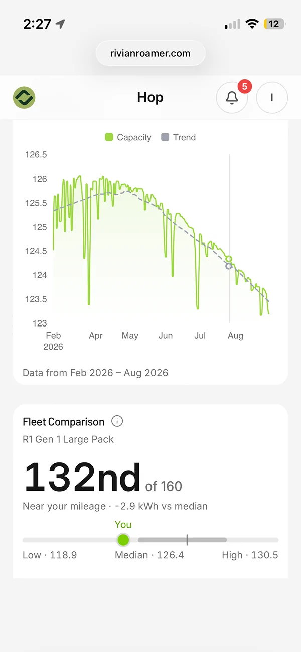

I just looked and this is what I saw:
Rivian R1T R1S Battery capacity questions IMG_6084
The only reason I think this is worth my time posting here is because it’s outside the bulk of other vehicles’ data. What is up with the decline starting this last spring?
An artifact of something? Charging habits are the standard ~20-70% on L2, up to 100% a couple times a month, DCFC once or twice every couple months.
An interesting note there was an update around May that gave me regular “regen limited” warnings in conditions it had never before occurred, then the warnings just went away after a few weeks. Related? This is all nothing?

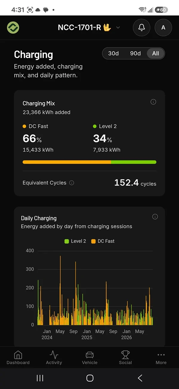

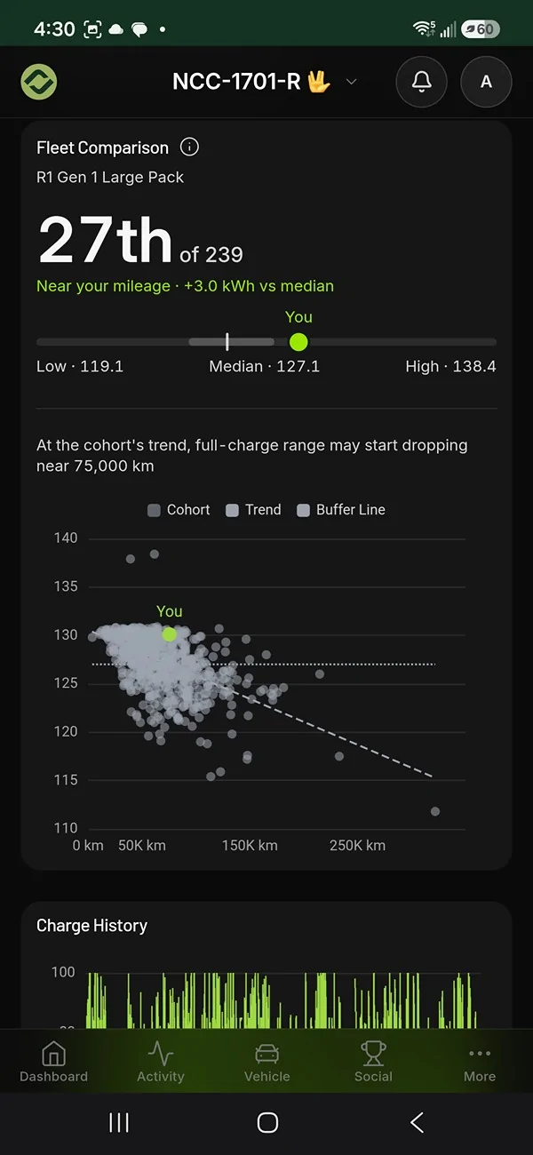

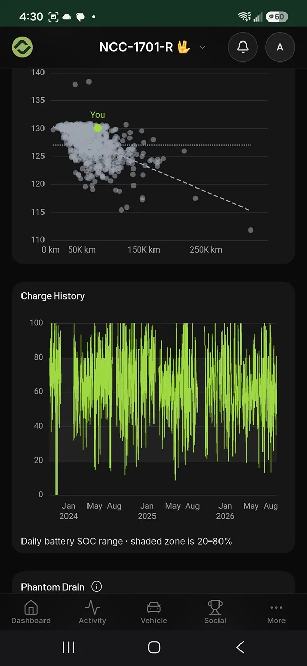

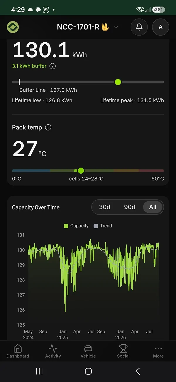

Just for comparison sake, '23 R1T 75,000kms data was originally tracked via Electrifi, and added to Rivian Roamer.
Rivian R1T R1S Battery capacity questions Screenshot_20260830_162921_Chrom
Rivian R1T R1S Battery capacity questions Screenshot_20260830_163041_Chrom
Rivian R1T R1S Battery capacity questions Screenshot_20260830_163051_Chrom
Rivian R1T R1S Battery capacity questions Screenshot_20260830_163119_Chrom

Plotting it as a zero-suppressed graph exaggerates the change. 123.5/125.5 is only like a 1.5% drop in efficiency over that time. While not nothing, it's also not really significant unless it keeps going down uniformly.
