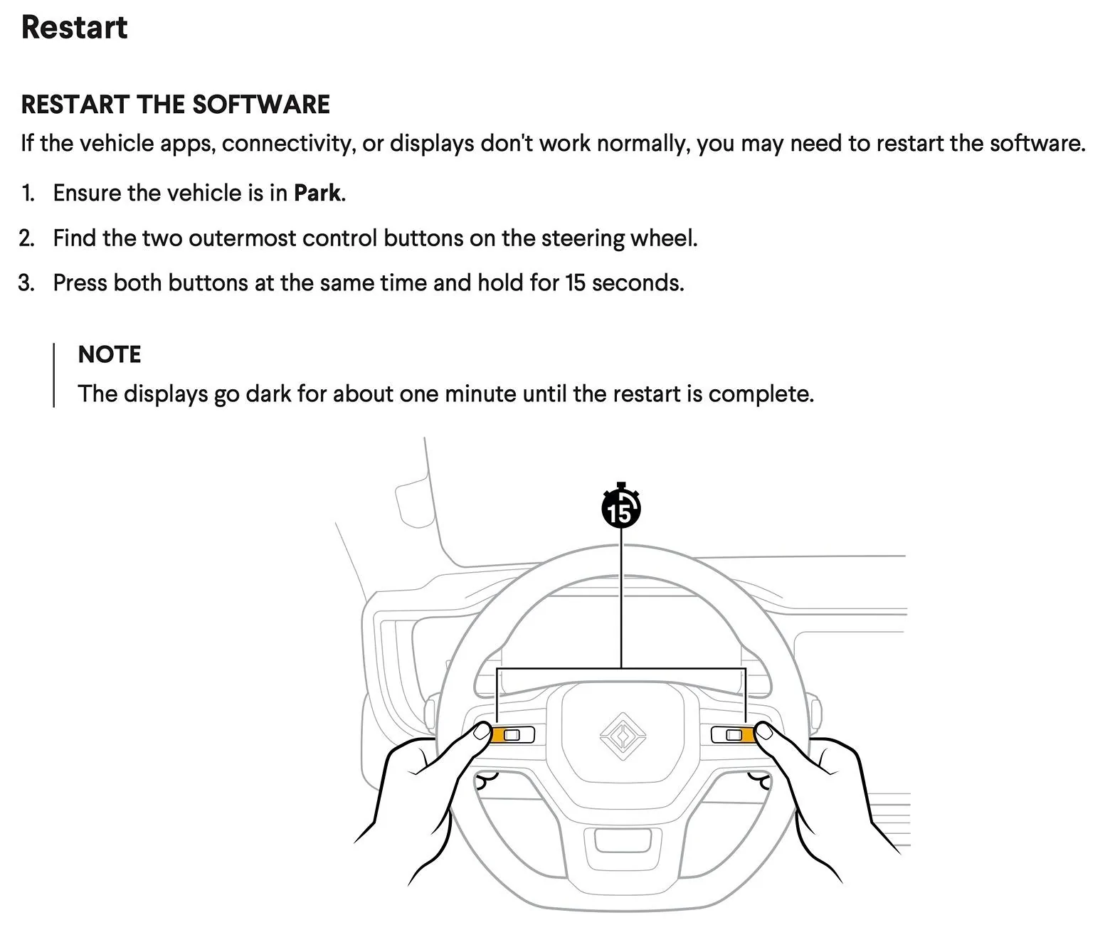

Did anyone try a software reset?
Rivian R1T R1S Apple Music volume not working properly Image 1-30-24 at 10.50 AM

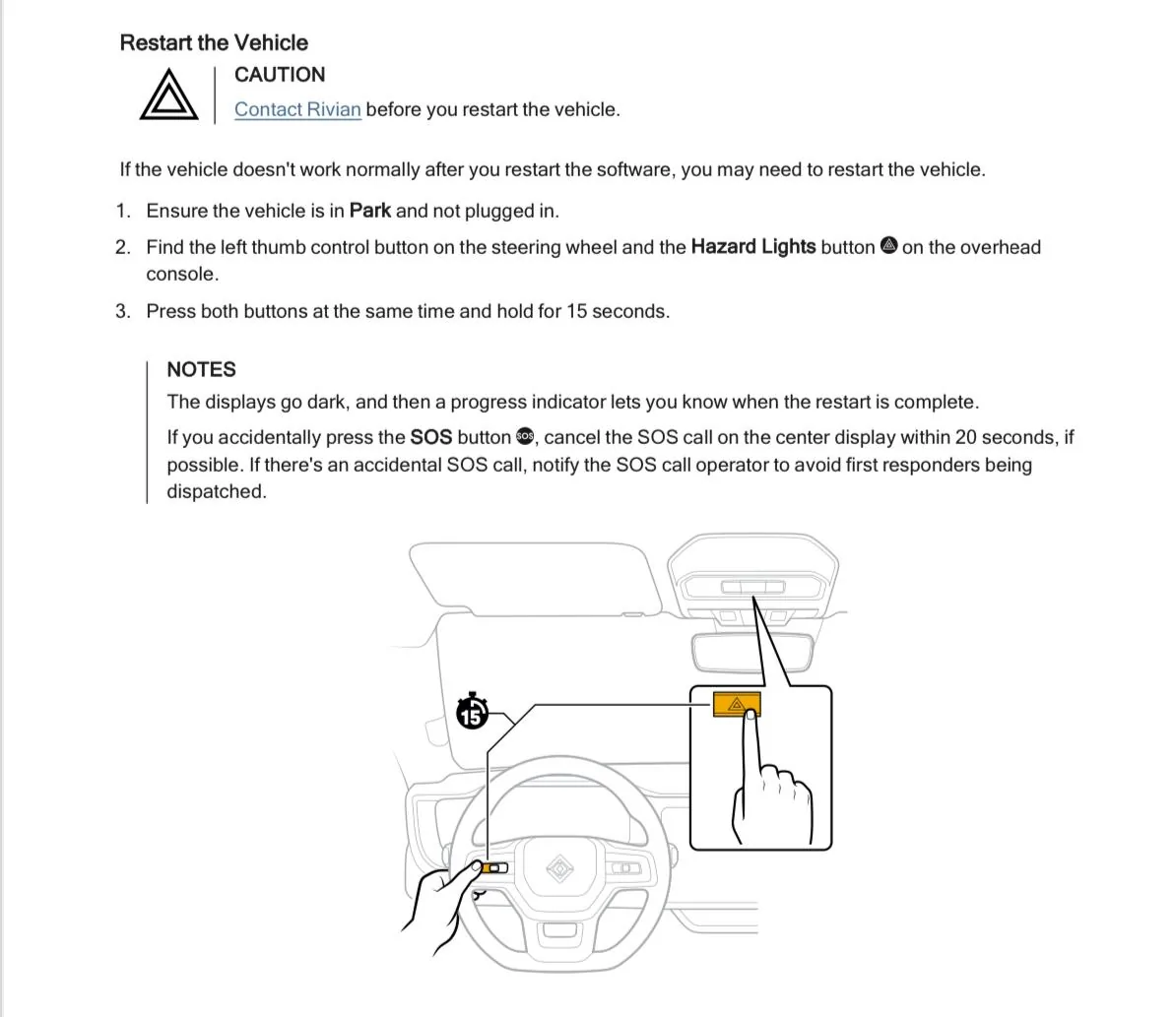

I tried a soft reset and it did not help. I did a vehicle reset and that fixed the volume issue. Not sure why a vehicle reset for this but it worked for me.
Rivian R1T R1S Apple Music volume not working properly IMG_2157

Correction - my volume hasn’t changed. It’s still on the louder side. I believe what I experienced was a volume difference sitting in my driveway vs. driving. When driving the volume increases by design.
