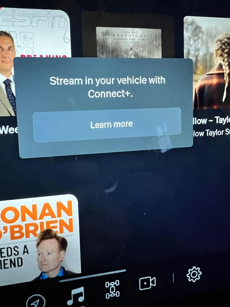

Anytime I try to access any of the connect + features, I keep receiving the following message even though I have the trial period and have signed up for the annual membership. It initially worked but randomly stopped working.
Yeah - that sure looks like a bug to me.
Rivian, please start testing these releases before clicking the publish button.
