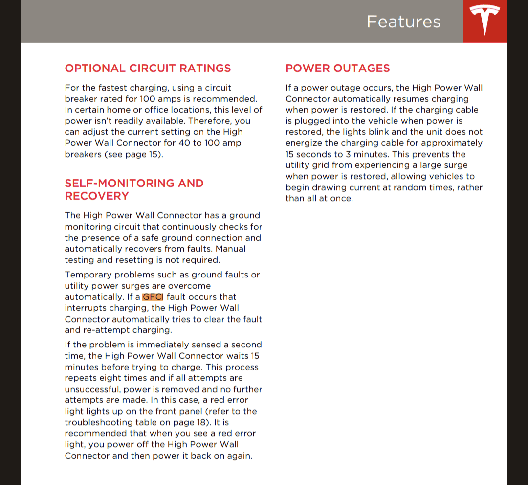

This is one reason I always recommend people use electricians with EVSE installation experience as electrical codes are still catching up with the available technology.
@EdgarD there are no test/reset buttons on any EVSE that I am aware of and they are all required to support GFCI.

Thanks. Sorry if I've spread any mis information.

Code requires one in the circuit.
Code requires a GFCI for a 14-50 outlet, but does not require one for a hardwired EV charger.
A GFCI breaker should not be used for the Rivian Wall Charger.
Bonus, a standard 60A breaker will save you something like $100 over the GFCI - make sure you get some money back when your electrician swaps the GFCI breaker for a non-GFCI one.
