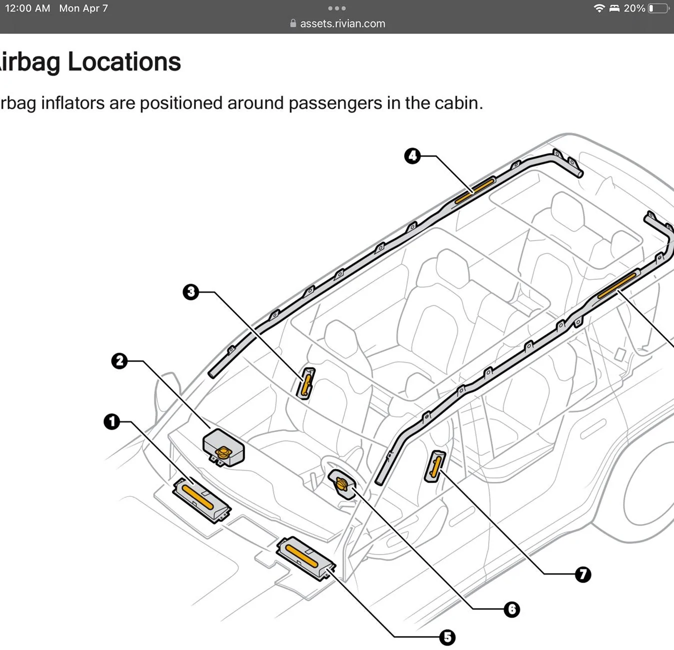

R1S and R1T owner's guide list the airbag locations and there are none on the A-pillar. I would be very interested in an aftermarket option.
That’s incorrect! The manual clearly shows the side curtain airbags extending one third to one half down the A pillar.
You're talking about #4 and the cut off number (presumably #8)? What does the gray versus yellow indicate here?
Also wondering, assuming gray is indicating part of the airbag system, how the situation is different for the A pillar versus the existing OEM grab handles above the driver and passenger doors. If it's possible there, maybe it's possible on the A pillar as well...

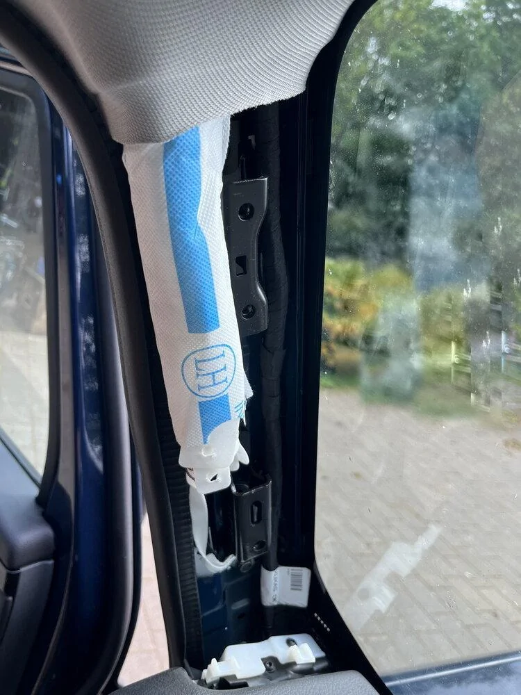

A-pillar grab handle and side curtain airbags can co-exist (see photo of Ineos Grenadier). @Zoidz is spot on...the issue for us Rivian owners is mounting the grab handle securely to the a-pillar. See that pic of the Grenadier -- it has OEM mounting brackets under the trim for pillar grab handles.
Gray is the airbag, yellow is the explosive charge module.

I came from a 2500HD Silverado and I had an aftermarket grab handle installed. I asked for the same on the Rivian and was told no dice b/c the last thing you want is have a handle come at you at speed b/c the airbag was deployed. FUDGE!
So for this disabled guy, I grab the a-pillar itself and climb into the cab. Even in kneel mode. Hoping like hell that it will support me over the years.
Exactly. The only way to do this is to fabricate a hidden foundation steel bracket that attaches to the lower half of the A pillar, and then attach a handle to the foundation bracket. I've been looking at this for a while and ruminating on it, as a result of complaints from my wife. :D
