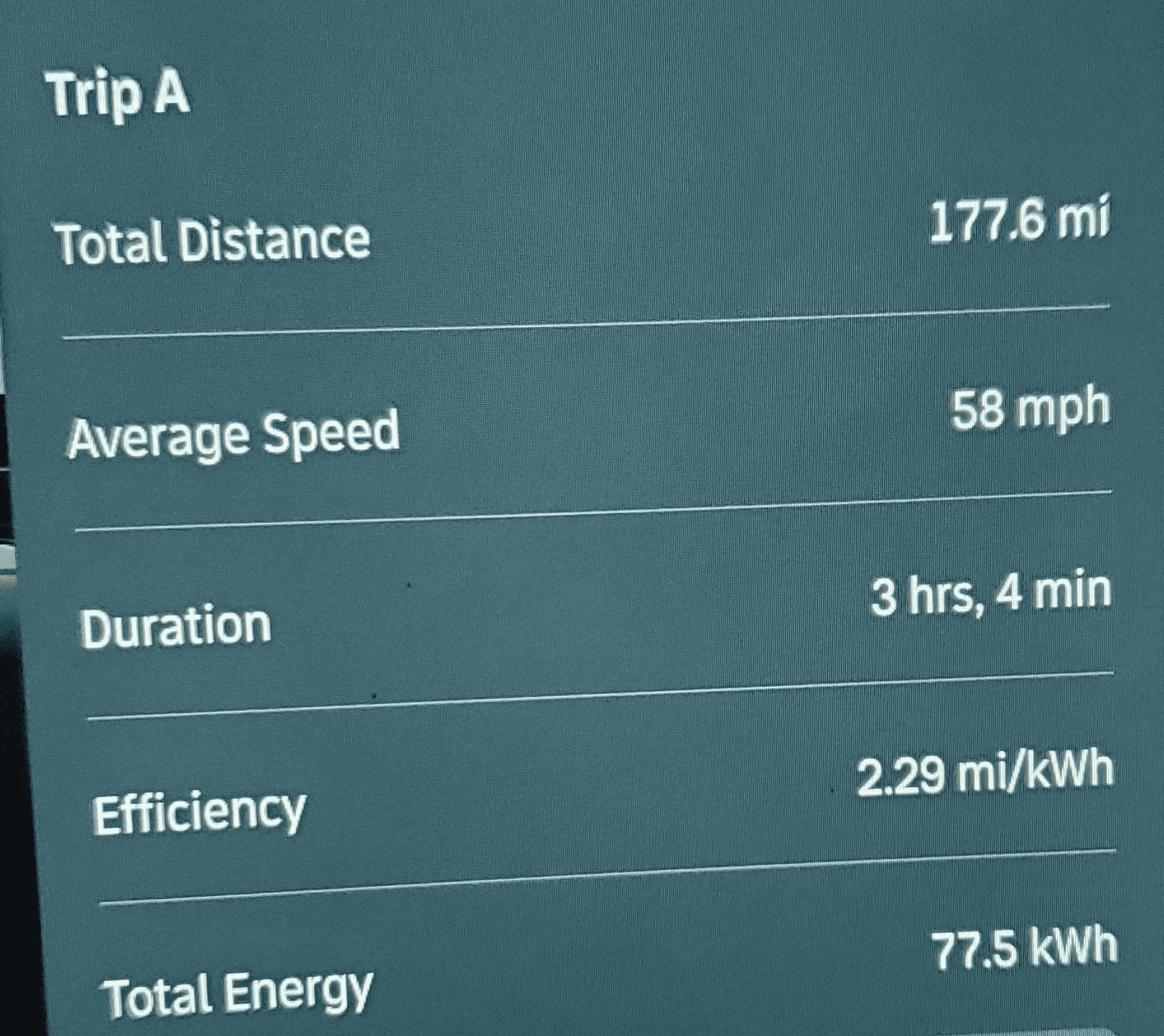

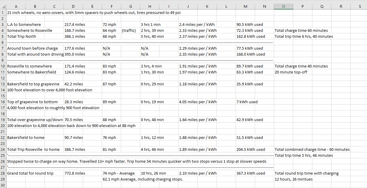

Finally got around to putting together the details of my last road trip. Conserve mode the entire way. 21" wheels with 5mm spacers and no aero covers.
This truck still blows me away at how well it performs on road trips. Give me the choice between a Tesla and the Rivian, absolutely would take the Rivian with one caveat.....

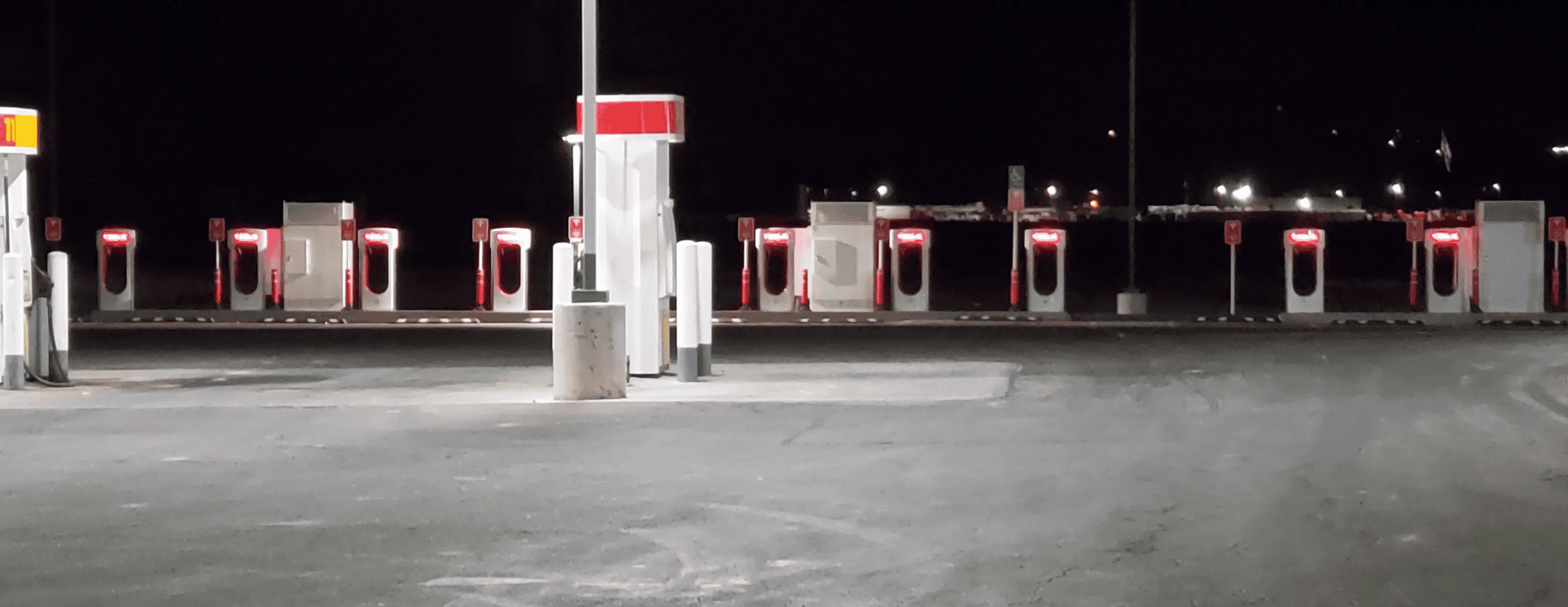

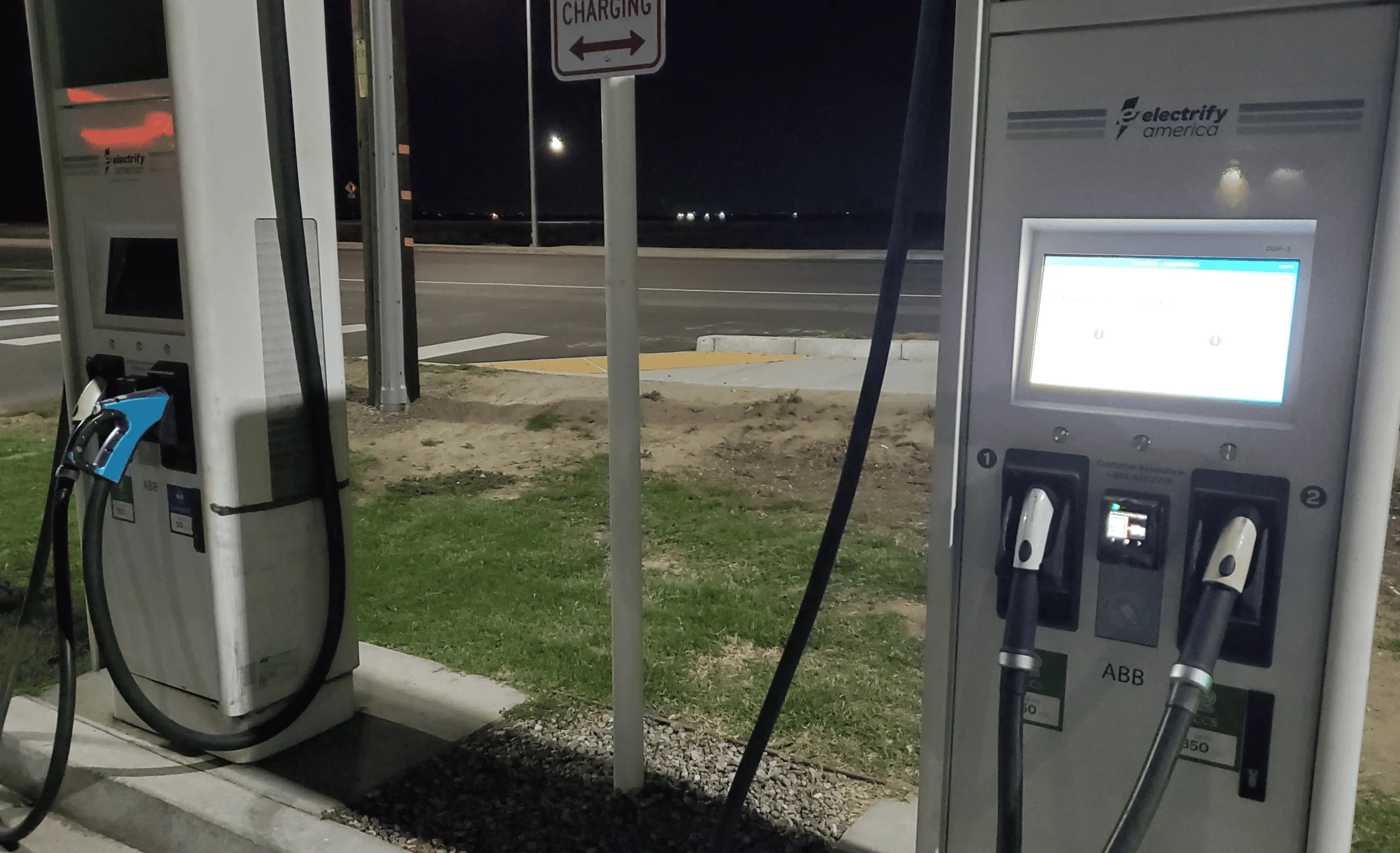

CHARGER TROUBLESHOOTING TIPS: The ONLY downside is the less than 100% reliable charging network. Fortunately, the only problem I had charging was at my destination. Wasted about 45 minutes before finally figuring out that the truck itself needed a hard reboot. 6 different chargers, nothing happened when plugging in on the truck side. Charger said it was trying to start a session, but the truck showed nothing. Called EA. They gave up after around 45 minutes, which is when I decided to try a reboot. That worked. Had charged 3 hours earlier with no problem, so not sure why it was an issue. Prior issue, the charger had to be rebooted by EA, so that's what I figured the issue was this time around. So, if you ever have issues charging and the truck doesn't show any response to a charger having been plugged in, start with the hard reboot and save yourself some time. If the truck shows some activity and charging session won't start, then EA charger probably needs the reboot. Call them right away to save yourself some time, if there's not another charger available to try
My trip back was from 12:00 AM to 5:00 AM, so no traffic. One charging location had 4 chargers (8 plugs). 3 of the chargers were not working. Fortunately, it was around 2:00 in the morning, so nobody was there. Feel bad for the Sunday travelers that choose that stop as it will be a long wait with effectively only one charger working.
I looked over at around 10 Tesla chargers across the parking lot when I was having issues getting my truck to charge and was envious. So, my caveat is, with the public charging network working properly, yes I would absolutely choose the Rivian to road trip in over a Tesla. BUT, with the unreliability of the public network at this time, the Tesla is probably still the better road trip car. At least in terms of charger reliability.

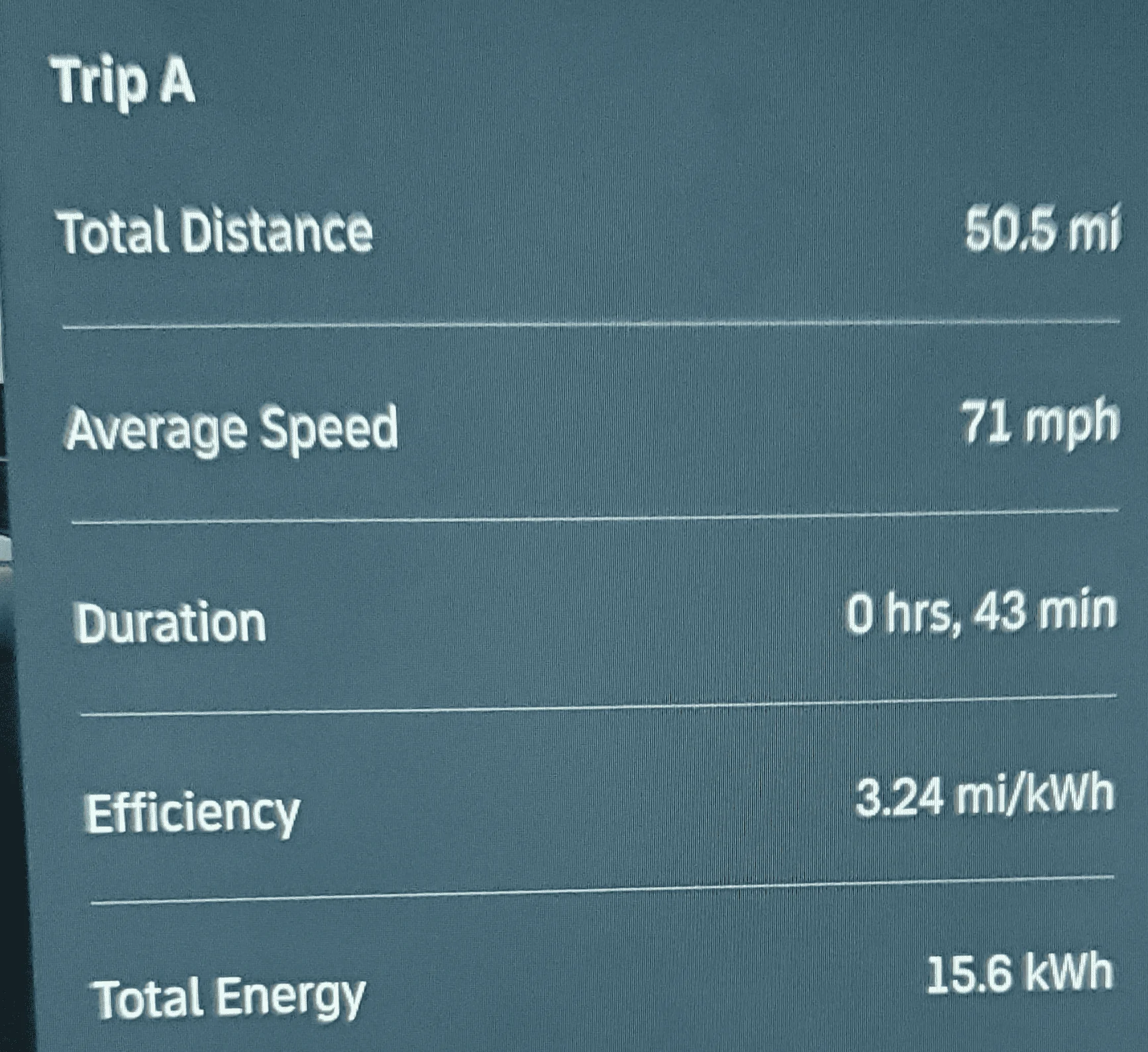

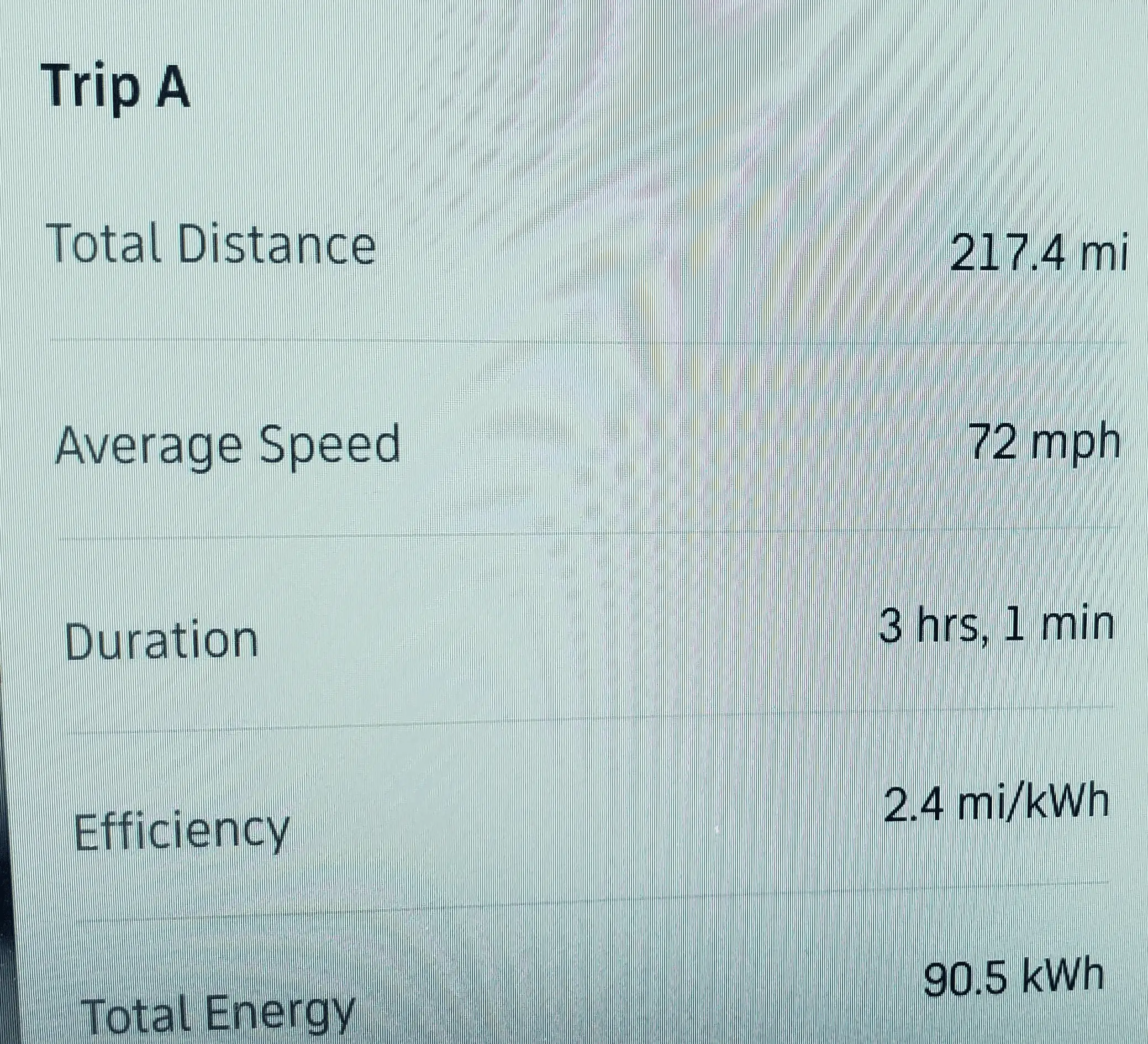

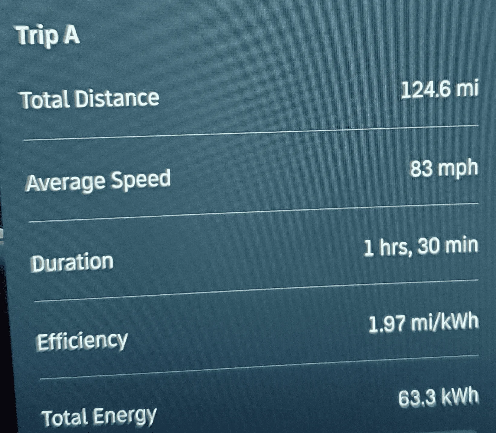

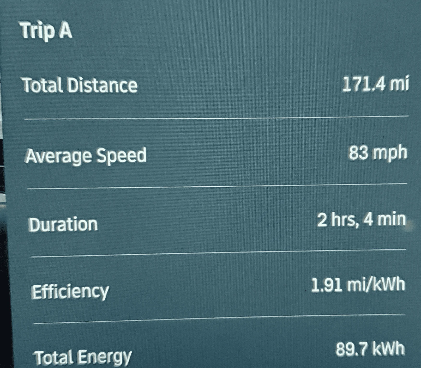

Also, for many questioning whether you should drive slower to charge less to get to your destination faster, my figures below clearly reflect that driving faster and charging more is significantly quicker than going slower with fewer charging stops.
Just did the math, actually, my total time spent at the charger was 60 minutes for each trip. Remembering that the truck chargers quicker at lower percentages. On the way up, I stopped once and charged from 16% to around 90%, which took about 60 minutes.
On the way home, I stopped once for a 40 minute charge, then a second time for a 20 minute top off charge. Two stops, but same total charge time. I guess getting on and off the freeway a second time took an extra 2-3 minutes. But, total drive time, going 13 mph faster on the way home than on the way there, was 54 minutes less. So, got home at least 50 minutes quicker than it took me to get there.

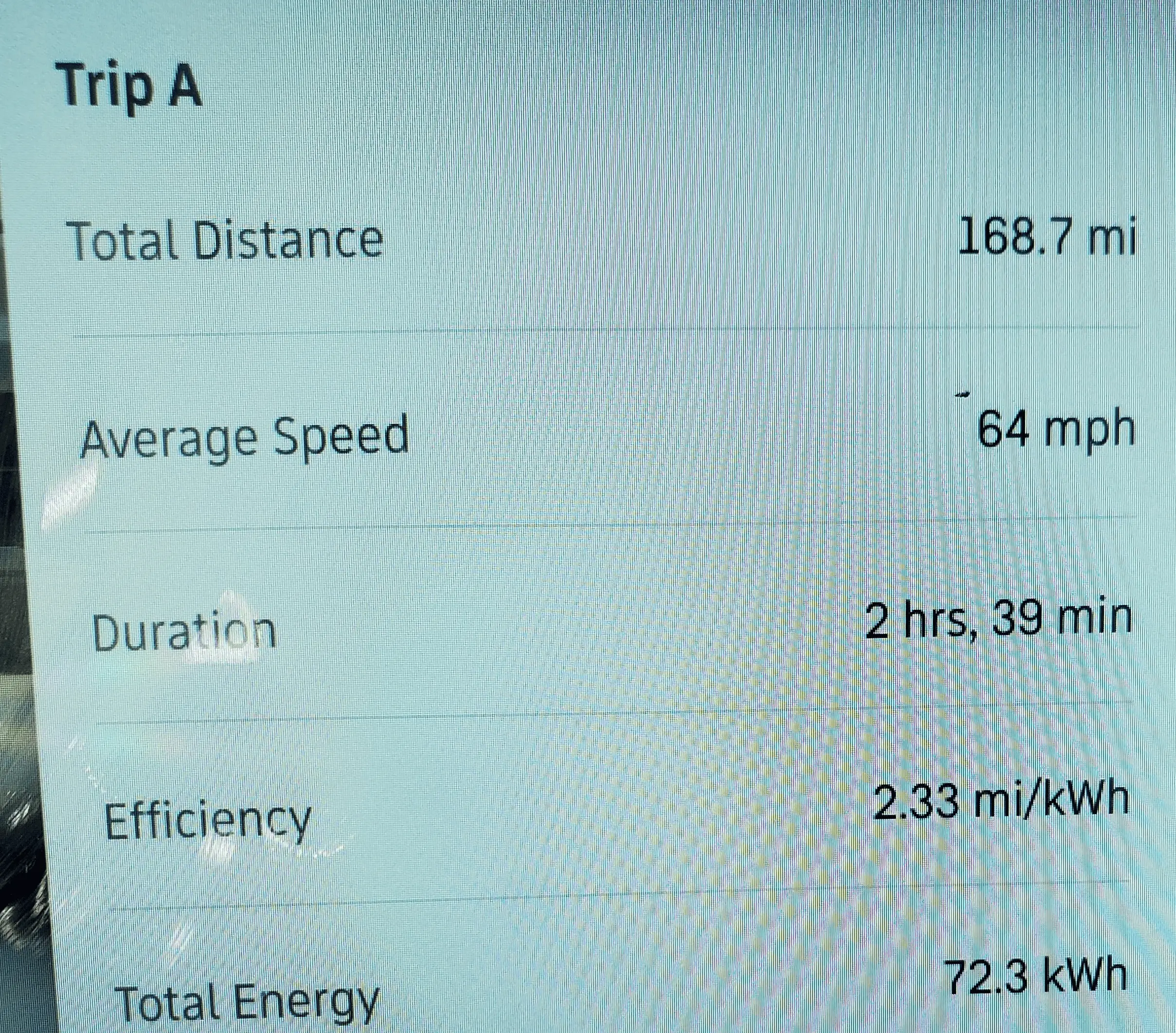

Rivian R1T R1S Detailed efficiency for SoCal to NorCal road trip - 773 miles @ 2.10 wh / mi - Over 80 mph most of trip 1665219076030

RETURN TRIP...................
Rivian R1T R1S Detailed efficiency for SoCal to NorCal road trip - 773 miles @ 2.10 wh / mi - Over 80 mph most of trip 1665219481211
Rivian R1T R1S Detailed efficiency for SoCal to NorCal road trip - 773 miles @ 2.10 wh / mi - Over 80 mph most of trip 1665219515175

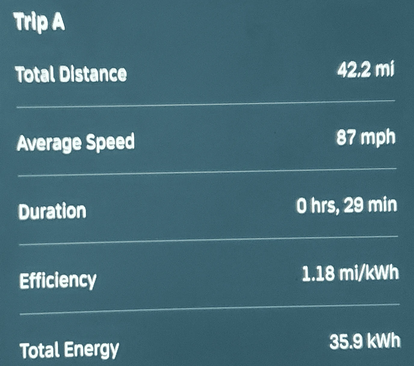

BOTTOM OF GRAPEVINE TO TOP - 900 FOOT ELEVATION TO OVER 4,000 FOOT
Rivian R1T R1S Detailed efficiency for SoCal to NorCal road trip - 773 miles @ 2.10 wh / mi - Over 80 mph most of trip 1665219702721

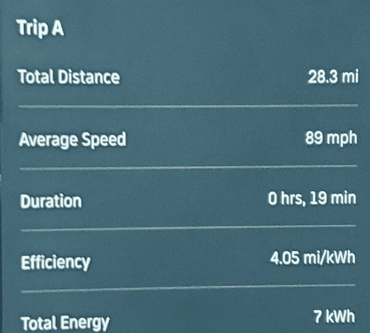

TOP OF GRAPEVINE (4,000+ ELEVATION DOWN OTHER SIDE TO AROUND 900 FOOT ELEVATION)
Rivian R1T R1S Detailed efficiency for SoCal to NorCal road trip - 773 miles @ 2.10 wh / mi - Over 80 mph most of trip 1665219628948
TOP OF GRAPEVINE TO HOME - ALSO 4,000+ ELEVATION TO AROUND 900 FOOT ELEVATION

TWO ELECTRIFY AMERICA CHARGERS. ONE SAYS NOT IN SERVICE, THE OTHER POWERED OFF COMPLETELY. ONE OTHER UNIT (OF FOUR TOTAL) WAS ALSO NOT IN SERVICE.
Rivian R1T R1S Detailed efficiency for SoCal to NorCal road trip - 773 miles @ 2.10 wh / mi - Over 80 mph most of trip 1665219914816
WHEN I WAS HAVING ISSUES GETTING THE TRUCK TO CHARGE, LOOKING OVER AT THIS WAS NOT FUN!!
