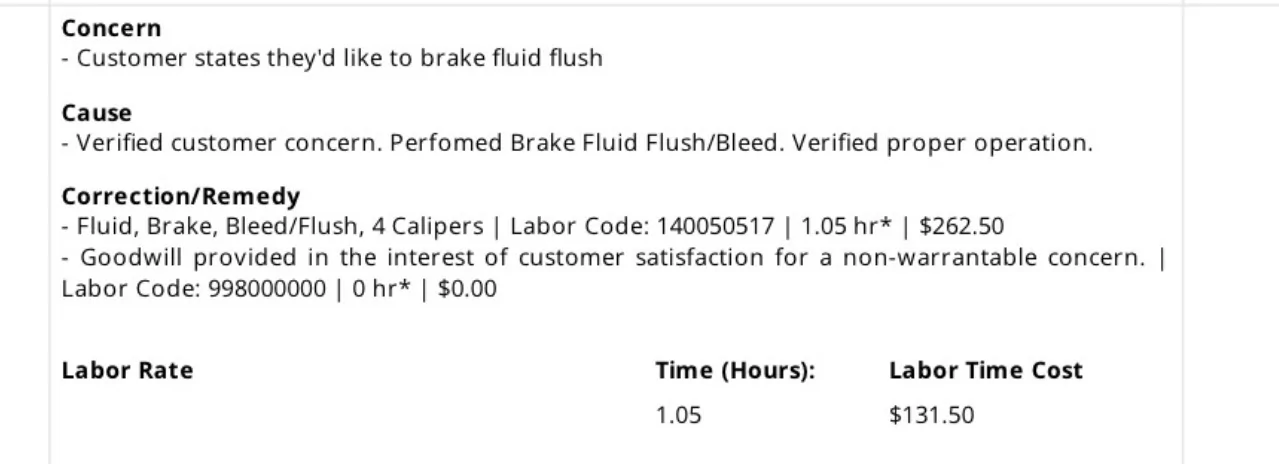

There’s no way that the brake fluid would be the same in every climate. If three years is good in FL then I should get 5+ in AZ. Does anyone know the cost and how long it takes?
Rivian R1T R1S New R1 (R1S / R1T) Maintenance Schedule IMG_1813
