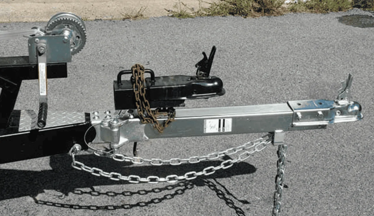

That tall tailgate means you need a very long hitch extension when it's lowered and you're towing something.
Simple solution. Install a Fulton FoldAway Hinge kit. Extends the hitch when towing, but shortens the trailer for storage. Just pull the pin and fold the hitch back. I have one of them on my boat trailer, it's fantastic.
Picture shows original hitch location vs. folding extension.

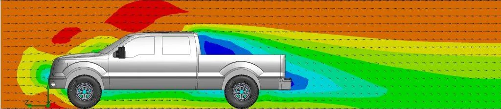

Isn't that the case with every hitch mounted bike rack in the market?
The answer is yes but with my VERY rudimentary fluid dynamics experience in play here I think the wind stress would be much higher on the tailgate then when stored behind a closed tailgate.
Rivian R1T R1S Tailgate Bike Rack Patent Truck CFD

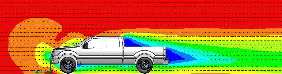

You can see the negative pressure zones in blue. If the tailgate is open that flow coming off the top of the vehicle would I THINK be blasting right at the area on the tailgate where the bikes would be.
As in this picture...
Rivian R1T R1S Tailgate Bike Rack Patent Truck CFD taigate open
Source is not exactly super scientific but is accurate for these purposes I believe.
https://xplrcreate.com/2019/08/08/aerodynamics-of-tailgate-closed-vs-open/

If I read this correctly, the bikes are carried sideways. I’m not sure that I like that. They’ll have a lot of lateral stress.
Far far less lateral stress than being ridden in a lot of situations.
We're talking about bikes that are designed to handle impacts from 250 lb riders for thousands of miles. They'll be fine, especially because the lateral force is just going to be pressing the frame down onto the axles. Range impact is a different story--carrying a 29er MTB on my Model Y can be up to a 30% hit on range depending on speed. And the bike may have even more of a sail effect sitting way out at the back of the tailgate on the R1T.
