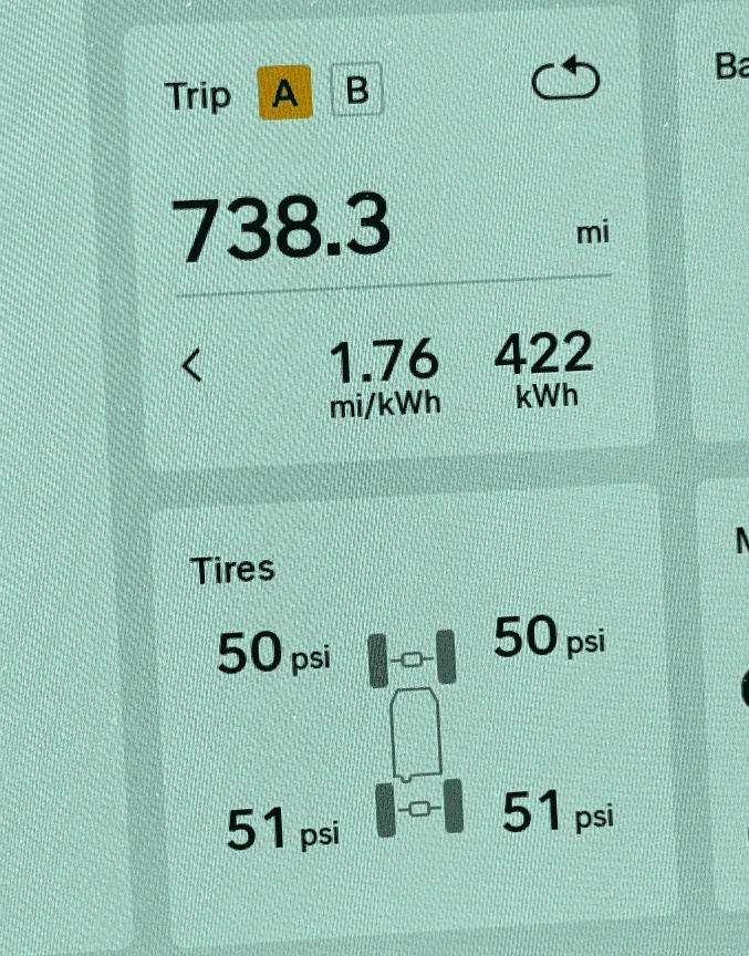

Thought to share bit related to Rivian about the short getaway.
Total energy used: 422 kWh
Total miles driven: 738.3 miles
Average mi/kWh: 1.76 (hitch mounted RockyMounts bicycle rack with part of the wheels and handle bar exposed beyond the rear R1S body from 2 bikes)
Route taken: 5-55-91-15-395-203 and reverse
Charging stops (RAN): Inyokern and Bishop (both directions)
Started 100% SOC from home and stopped at Inyokern. Rivian nav planned a stop at Olancha but at least there is a clean bathroom and a burger place at Inyokern AND more terminals to charge than Olancha so we stopped earlier than needed and had lunch.
Charge to 90% SOC at Bishop. We were in Mammoth for 3 nights and needed to drive up to Mammoth Mountain Bike Park as well as some in town driving. Left Mammoth at 40% SOC and got back to Bishop RAN at 28% SOC. Charged to 80% at Bishop and picked up two loafs of bread (Rye and Asiago-JalapeƱo) at Shat's.
Final stop at Inyokern and charged to 80% SOC and got home at 9% SOC.
Most of the drive, with exception of going through communities and single lane construction zone on 395 was at 80~82mph.
I realize the winter range and ability to skip charging in the winter will be different. Still, its a reference point for anyone who feels uncomfortable not having DCFC option in Mammoth (unless you have NACS adapter).
Final screen upon return:

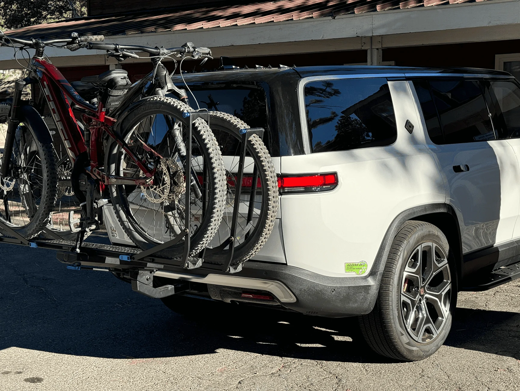

Two eMTB (~55 lbs each) on RockyMounts:

Cool! Sounds like a good trip overall.
do you mind adding time spent at those stops also? I think we are missing how much SOC you left Olancha at.
battery? DM/Quad etc?

Yeah sorry about that. It used to be the only discriminator was T or S, and tire/wheel configuration. Now we have G1, G2, QM/DM/TM soon, and Std, Std+, Large, Max and additional tire/wheel choices....
Our R1S is G1, QM, Large on 275/50/22 OE tires.
Never stopped at Olancha. We stopped at Inyokern both directions.
Time spent...hmmm, I didn't pay attention because it's a function of how much I needed to charge rather than how long.
On the way up, it was long enough to use the bathroom and eat lunch (we always plan nature/food breaks with charing) at Inyokern. We had packed a sandwich from home. At Bishop, to get to 90 took a while. Maybe 45~50 min?.
On the way back, at Bishop, around 30 min at the most. We went in to Schat's bakery, had sandwich made for lunch to eat at Inyokern.
Last stop at Inyokern was about 30 min again.
Like I'd said, really didn't keep track to time since I have no control how long it takes to charge to a desired SOC. That part is it is what it is....

Considering you spent significant time at 80-82mph, I'm actually impressed with your efficiency with two bikes hanging off the back. Granted, they are mostly in the air pocket formed behind the R1S anyway, but the handle bars and tires do poke out into the airstream.
