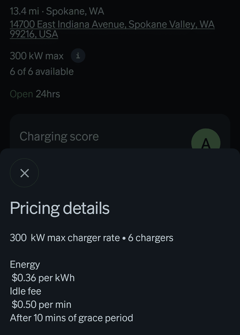

Does anybody know where to look up what a specific RAN charger costs per kWh?
The Tesla app tells you how much each Tesla Supercharger costs per kWh. The Rivian app, apparently not.

All RANs are $0.36/kWh. I have been using the BlueDot app recently which has many EVgo and ChargePointe stations at $0.30/kWh. Nice chart on the SC’s. It varies by location. In April I found a SC in Salt Lake City for only $0.18/kWh.

"Cup of coffee" is how marketers lie to us by saying something meaningless. In Kingman, we recently used RAN in one direction, and SC in the other. The latter was due to amenities; we paid more to enjoy the stop more. The cost difference without membership is 23 cents per kWh and with membership it's 18. So that's more like the cost of a small road meal. On a full road trip it will be a hell of a lot.
Edited to add: The idle fee policies are also very different and harder to figure out with Tesla. As far as I can tell, RAN will always charge you the fee after ten minutes, no matter what, and it's 50 cents per minute. Tesla ONLY charges you if the SC is busy, but then it's a dollar per minute after five minutes. If I want to walk away from the car for a while, this matters a lot. Again, Kingman being an example, the SC was barely used so no fees applied and we walked around the city without a worry.
