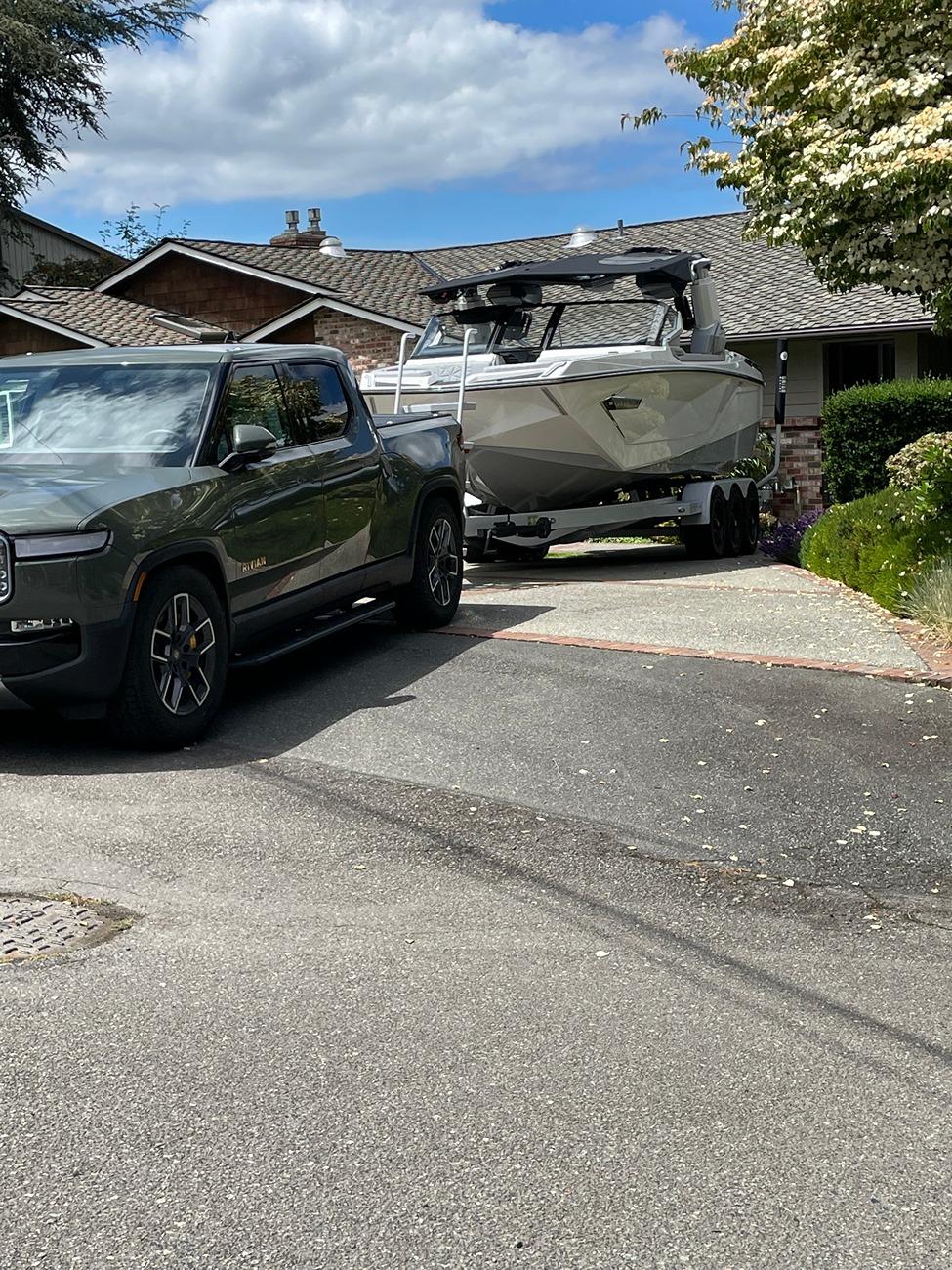

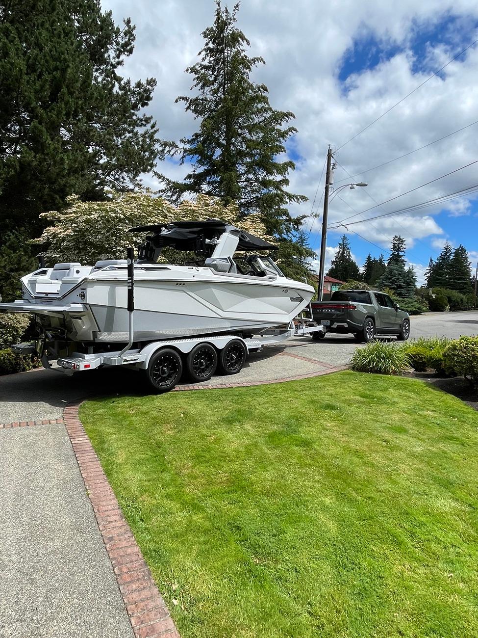

Towed my boat to our summer lake. Plugged in the trailer, range cut in half. My trip was 65 miles, 80% charge, truck said I would have 43 miles at destination. Handled the boat well on the freeway and back roads. Elevation gain was 1000 ft on the trip. Once launched, and trailer disconnected, range showed 120 miles. All in all a great experience. R1T Quad.

That boat doesn't look that big in the front view, but once you see it from the side... it's a whole different story.

Jesus.....that's an aircraft carrier.......?

Rivian recommand using weight distribution hitch for towing over 5000 pounds. I know weight distribution hitch are not ideal on Y frame trailer,...have you consider weight distibution hitch for your setup or it tow well?

Most boat trailers have surge hydraulic brakes, and you need a specialized WD setup for it. A normal one would be deadly. Also, boats have a far lower ratio of tongue weight for trailer weight, as compared to any other type of trailer. So the recommendations need to be adjusted upward for them. I've towed boats up to 18k on the road for short trips, and 12k cross country. It's very different from a travel trailer, and handle better than a TT at much lower weight.

Yes indeed most boat trailer have surge brake but some weight distribution hitch are compatible with them, my issue is that my boat trailer manufacturer recommand against using one because of the Y tongue type of my aluminium boat trailer, they say it would put to much stress on it. But at the opposite RIvian recommand using one at that weight rating and I don't know if it is for the same reason reducing the stress on the rear axle, suspension. For the weight balance my boat is well balance and have tow hit without weight distribution system, but I am just worry about the air suspension/rear axle of the rivian....

I would have zero worries about the suspension, assuming the trailer has the correct tongue weight. I would definitely measure it. One time I ended up with a very unbalanced setup because I bought it from a moron. I knew it was out of whack, but the scale was scary. It was around 2500 pounds on the hitch. Insane.

Great comments on the WDH. You are correct, most boat trailers are not set up to accept that type of setup. This trailer has electric over hydraulic, which was new to me. When I plugged in the boat and pulled a few blocks, the truck recognized the load to be 10,000 lbs. Also the proportional breaking adjustment worked great. By pressing on the right scroll wheel, there was about a two second delay, then the brakes applied smoothly. I will never be pulling the boat over 100 miles, just happy I can. I felt the whole setup was safe. I think the brake setup as well as the Rivians integration with the trailer are the secret. Again, great experience. Now for the fun, Surfs Up!
You may already know this, but it means you can use any WDH that works with that trailer style. But if it rides level without it, I wouldn't bother.
