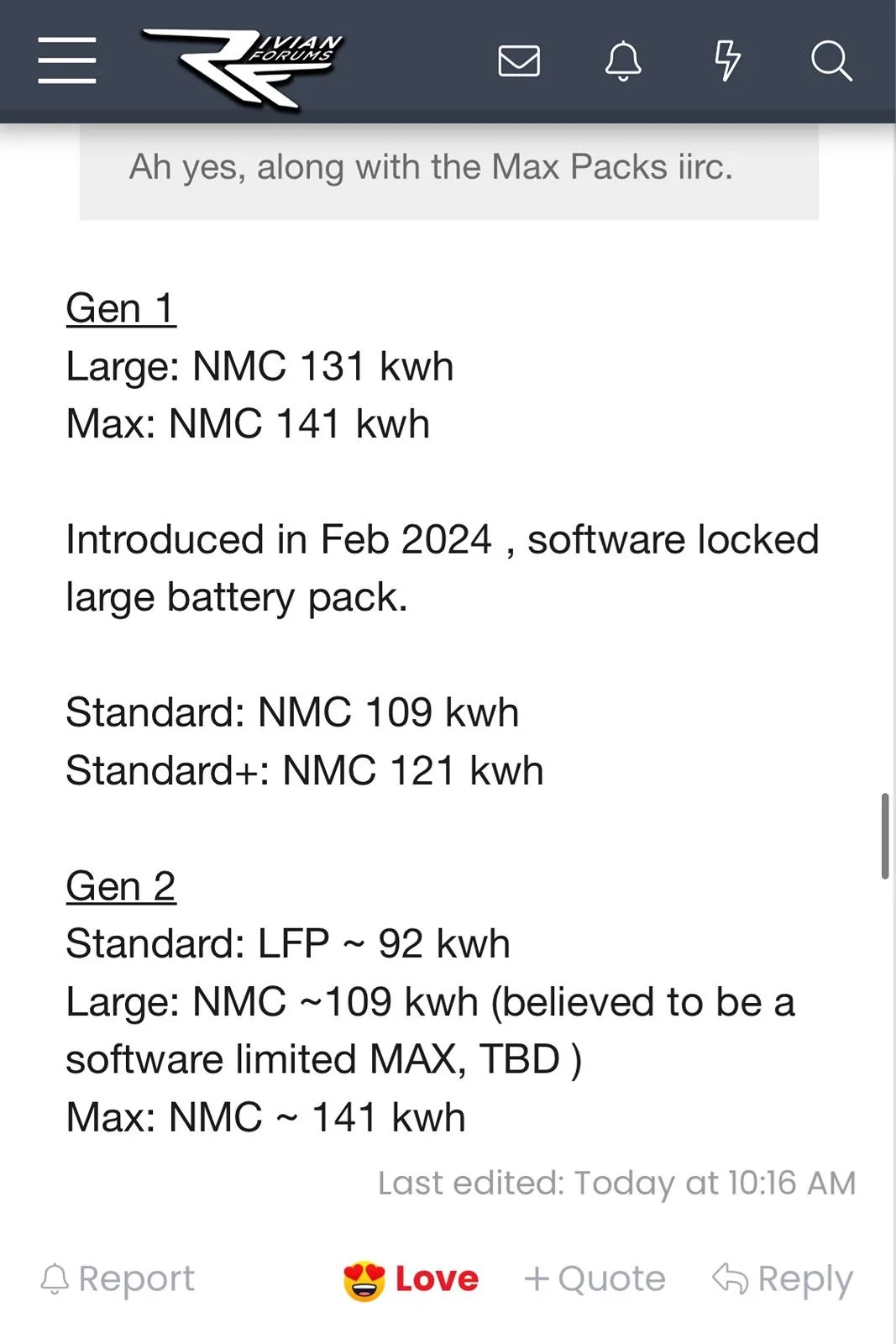

Ah yes, along with the Max Packs iirc.
Gen 1
Large: NMC 131 kwh
Max: NMC 141 kwh
Introduced in Feb 2024 , software locked large battery pack.
Standard: NMC 109 kwh
Standard+: NMC 121 kwh
Gen 2
Standard: LFP ~ 92 kwh
Large: NMC ~109 kwh (believed to be a software limited MAX, TBD )
Max: NMC ~ 141 kwh

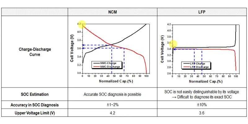

LFP has a relatively flat voltage range (3.0-3.3). Tesla has users charge to 100% to calibrate the BMS due to this. We don't know what information Rivian needs for their BMS, maybe they don't need to see the entire range. Nominal is supposed to be 3.2 and 80% would be close to nominal, so maybe that's what Rivian is planning their packs around. NMC has a larger range, largest could be from 2.7-4.2 but I am not familiar with the Samsung battery so it might be 3.1-4.0.
LFP max voltage (3.3) is less volatile than NMC at max voltage (depending on chemistry this could be 4.0-4.2), but it is still volatile. On NMC being at 100% state of charge frequently will accelerate battery degradation.

Great information, I just want to add why you should keep LFP pack at 100%
All of those batteries have computer that monitors their health (BMS), and part of the process is battery balancing, it is important feature to keep all cells in "sync" if they are not, the entire pack would prematurely fail even if one cell starts to drift.
It is done by monitoring voltage and adjusting charge current, usually retarding charge on that particular cell to bring it back in sync. And because LFP has relatively flat charge curve, it can only be done at very high state of charge or very low:

Gen 1 Rivians used Samsung 50g NMC cells on the R1T and R1S since 2021.
2. LFP (Lithium Iron Phosphate) have a long life cycle that can be regularly charged to 100%, cheaper to produce, good thermal and chemical stability (can fully charge and discharge without worries), with it's downfall being in cold weather performance, both in range and charging curve.
Gen 2 Rivian's (The new refresh):
Standard: LFP
Standard+: LFP
Duals: New Samsung SDI 53g NMC
Tri: New Samsung SDI 53g NMC
Quad: New Samsung SDI 53g NMC

Especially with LFP (Lithium Iron Phosphate) packs, just charge the darn thing to 100% and maximize the full range potential.
LFPs due to its battery chemistry are happy at 100%. LFPs lack in cold weather performance for sure as I've had years and years of experience with LFP EVs, so that's the trade off.
