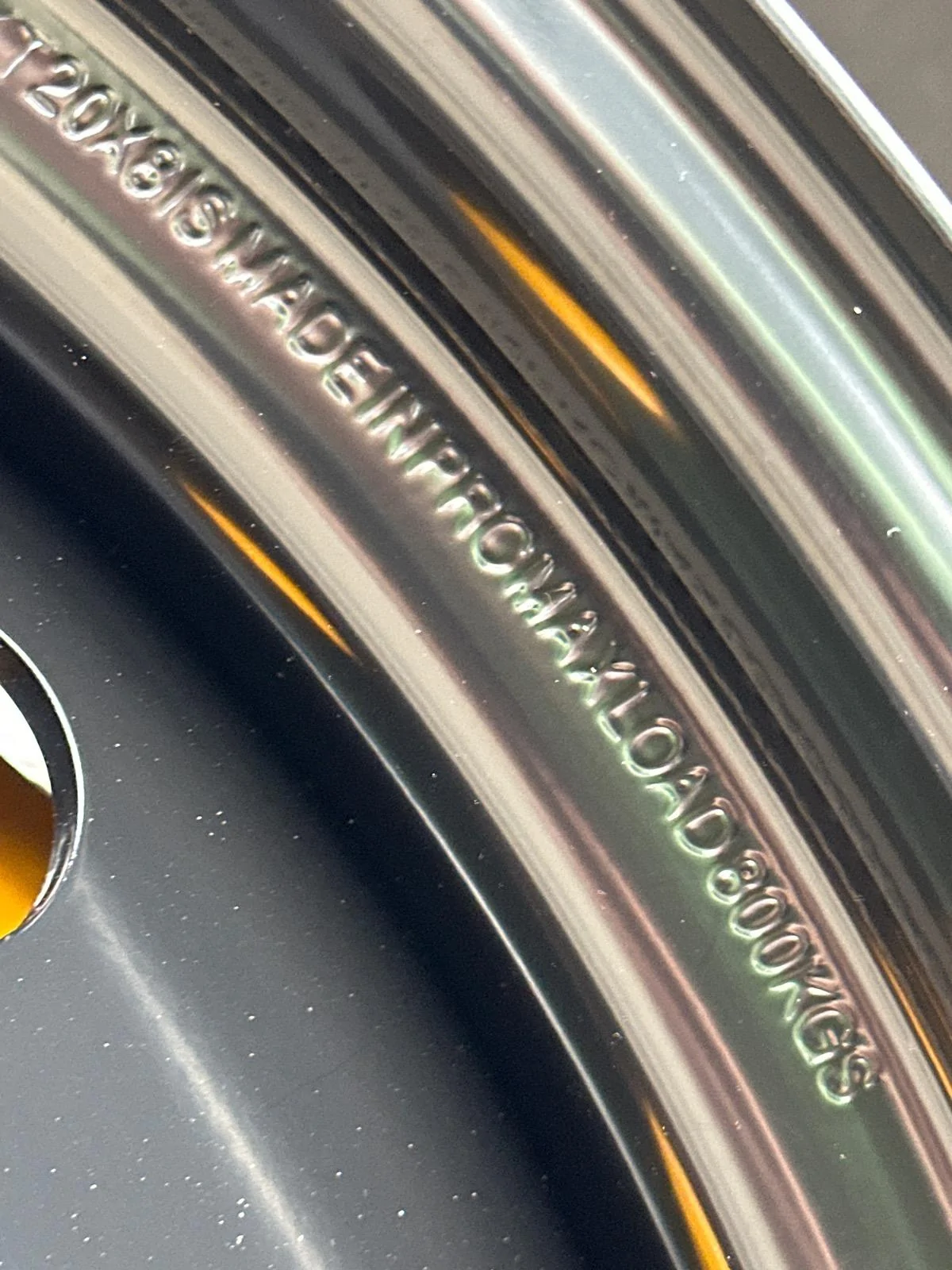

So - there will be a stamp on the rim. Like this
@HAL9000 what is the load capacity of those rims. I’m willing to be it is 800kgs per rim; math that out and it’s ~1600 lbs load rating PER RIM on a 7,000 truck. Work fine though for early ‘00 1500 Rams as designed.
@krockett - I bought and returned these rims last year, due to the low load capacity.

I did contact the manufacturer of these specific rims and was told the load rating per rim is 1800lbs.

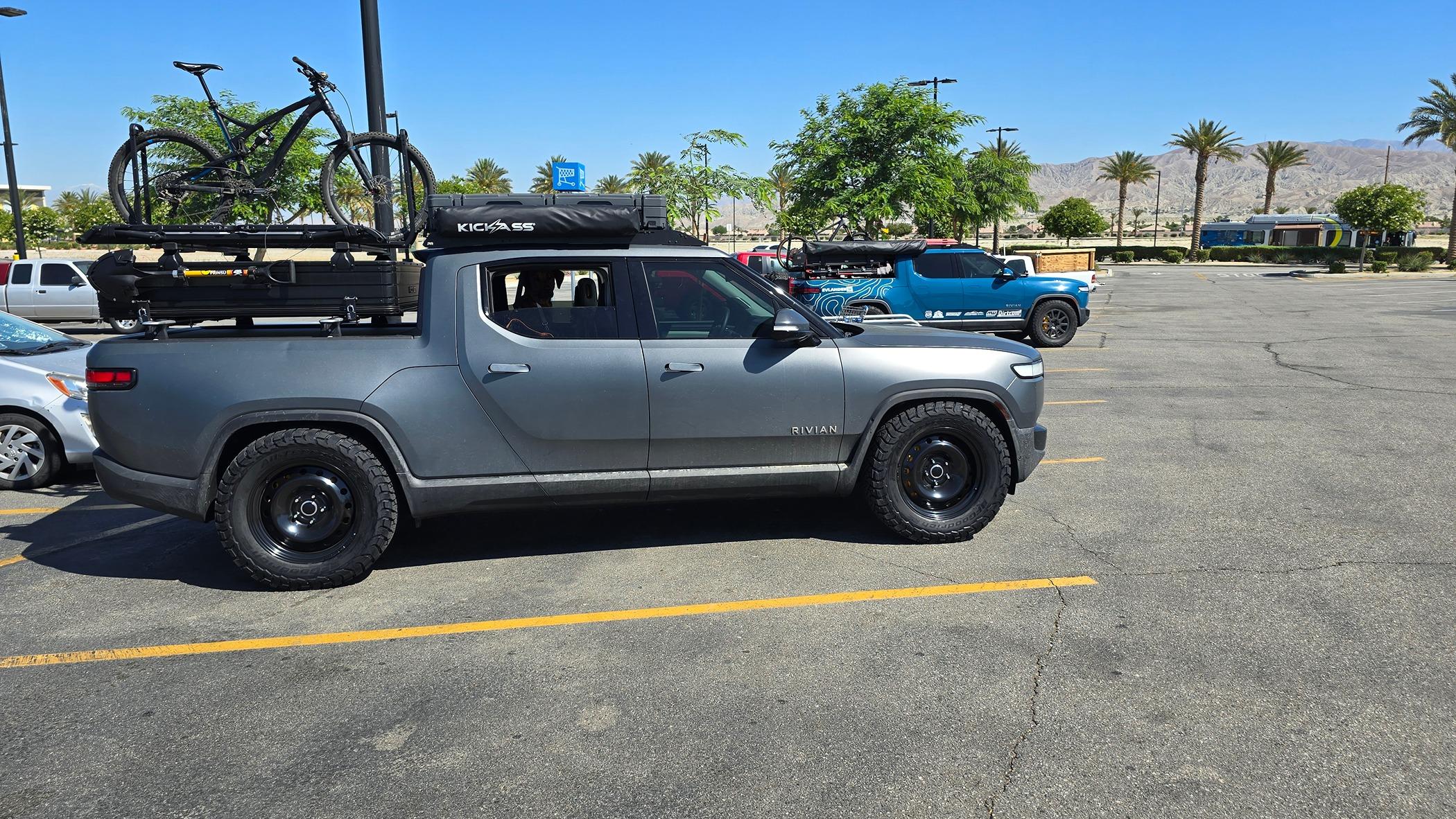

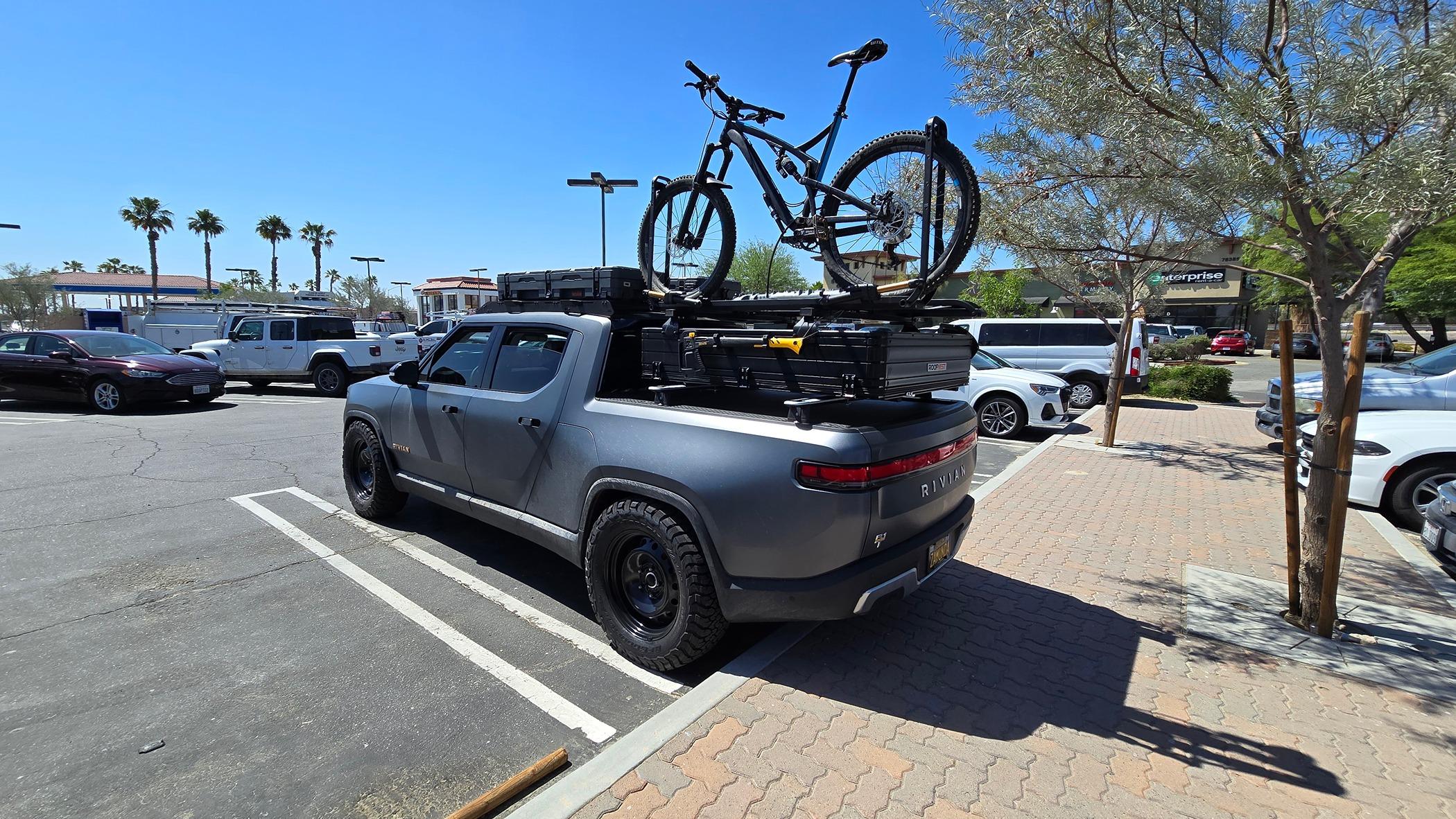

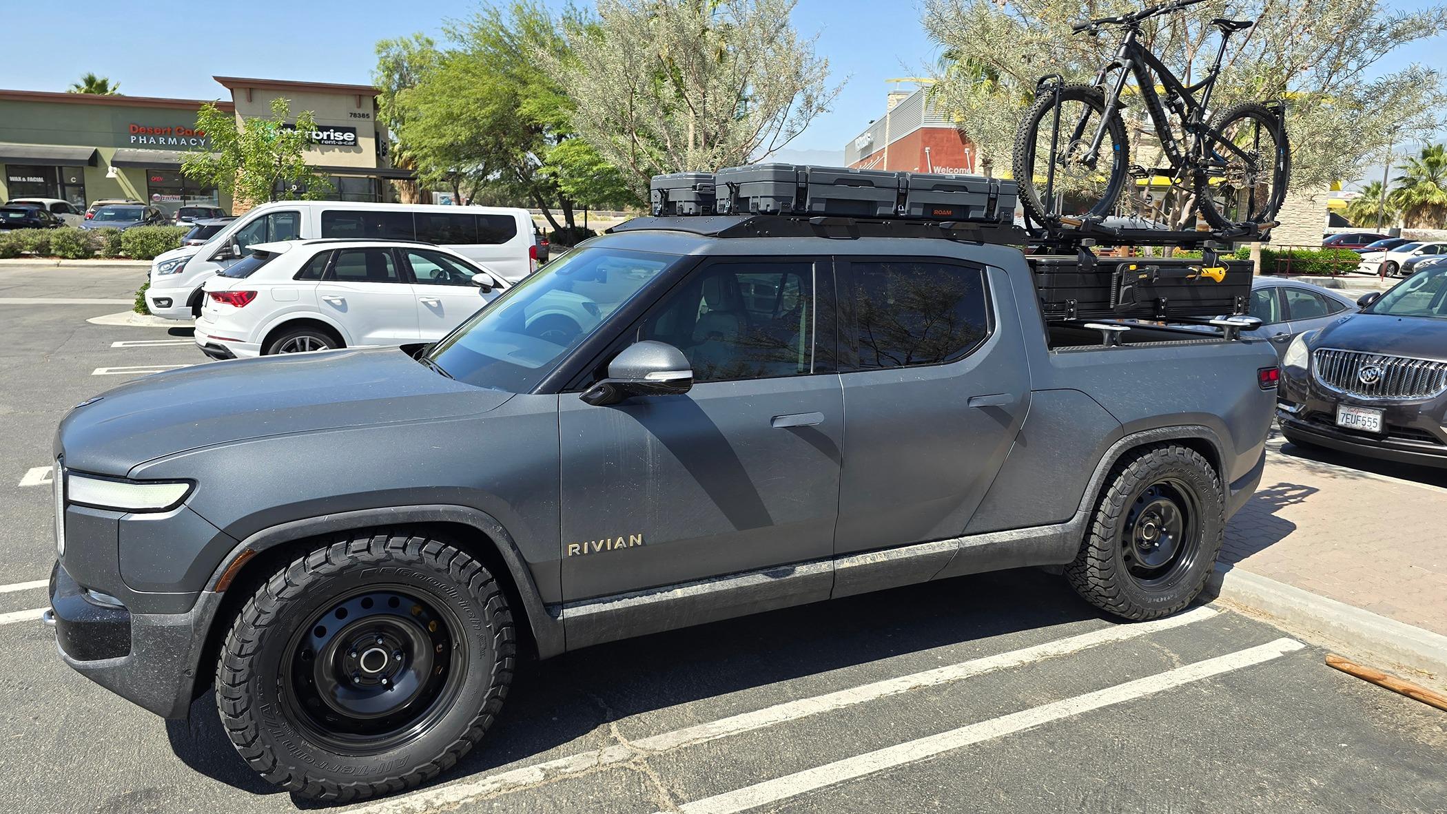

Rivian R1T R1S KO3 tires installed on 20" steel wheels rims 940x624
I already did some off road runs and the truck and rims are ok. I am not hauling or towing anything. If they fall off (as some here are hoping) I'll let you know. ?
Well, 800kg is 1760 pounds.
Maybe they rounded up?
Could be, I'll still take a pic for myself to be sure.
