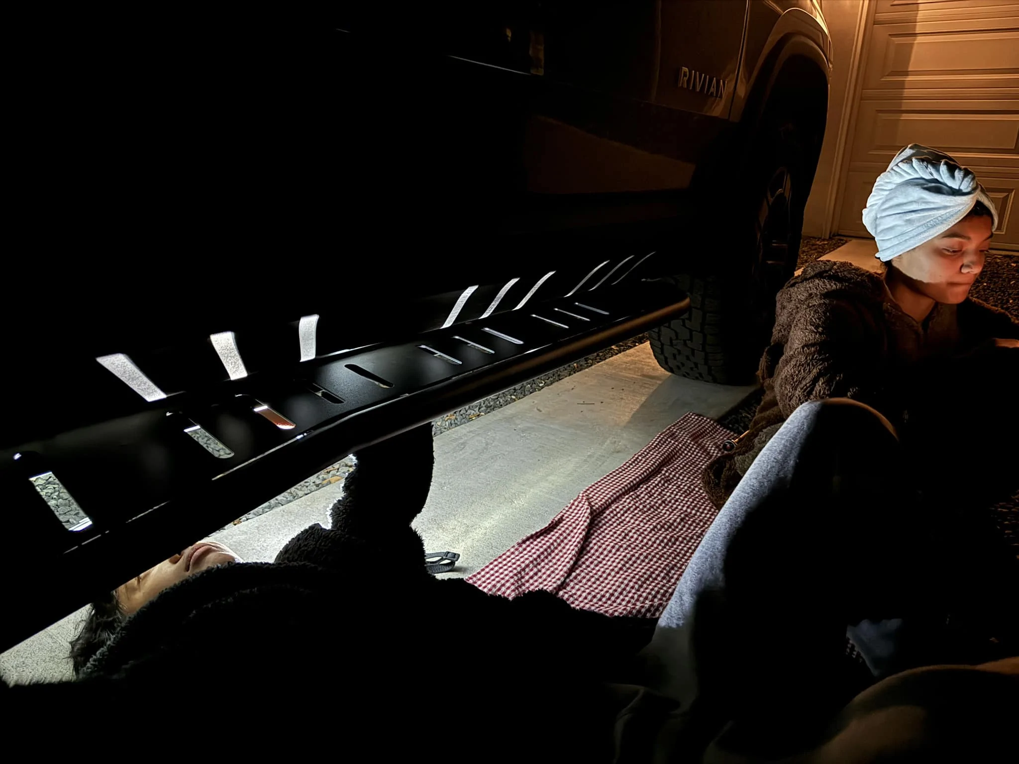

I needed six hours and two trips to Home Depot to install the Megawatt sliders. Others have done it in two hours, but I didn't have all the tools I needed and I got the wrong tools on my first trip to Home Depot. The underbody plastic panels took me much longer to remove than I expected. I also took the opportunity to teach my kids how to work on a car, a skill my dad taught me and I got to pass on.
If you have all the tools and have practice removing panels, the install will go much faster for you.
Tip: Get a 3/8" torque wrench rated in ft/lbs and a 3/8"-to-1/4" socket adapter to adapt the supplied Torx bit used to remove the Rivian's frame bolts.
As instructed, put your Rivian in Off-Road mode and the Highest ride height. That gives you the most room to work underneath the vehicle.
The Rivian's plastic underbody panels are attached with clips that take some convincing to release. I found that using a flathead screwdriver to compress the clip made the process much smoother. But I didn't figure that until I finished the left-side panels and got to the right side. You'll know what I'm talking about when you do it.
The Rivian's Torx frame screws are huge and deeply set. They gave me a lot of confidence that they wouldn't fail under stress.
Tip: The instructions I received were for an R1T. At first, I worried they’d sent me the wrong sliders. But they were the correct length. You have work out which Torx bolts to unscrew to mount the sliders onto the frame. Simply line the mounting holes up with the bolts and you’ll see which bolts to remove.
If you're installing these sliders on an R1S, you'll probably find that they extend all the way back past a plastic piece in front of the rear wheels. (I don't have pictures, but you'll know what this is when you do it.) This plastic underbody piece is just long enough to prevent the slider from mounting flush to the frame at that spot. I removed the screw attaching the underbody piece, used shop scissors to cut it into a shape that fit inside the slider, mounted the slider, and reattached the underbody piece. I put a bit of Locktite on the panel screws to keep them from rattling out. It works.
For those with the reinforced Underbody Shield like I have, the Megawatts work just fine with them.

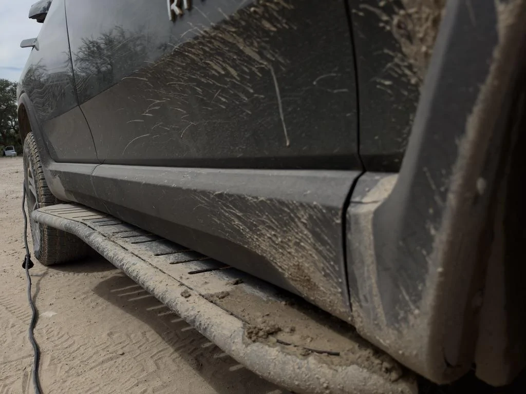

In this video, the sliders struck a rock at the 0:35 mark when I went off-camber. You can argue whether they protected my door panel or if the body would have cleared the rock if the sliders hadn't been sticking out. Either way, the sliders ate up this hit with ease. Again, you can hear how strong they are.
The sliders paid for themselves when I had my dad drive us through a dry riverbed. The riverbed was narrow, so I advised him to climb over a big rock instead of going around it. He did, but it was too tall. We jack-knifed the passenger side of the vehicle onto it. The front passenger wheel hung off the ground.
We switched drivers. Since the front driver wheel sat on the ground, I decided to continue forward instead of trying to back up in the tight riverbed. I turned driver to slide the vehicle off the rock using the sliders. The vehicle slid off the rock as I expected. But I didn't think about the trajectory of the rear passenger wheel. As I drove us forward, the rear lurched to the driver's side as the Megawatt's kick-out did its job and shoved the back out, moving the rear tire off the path of the rock. If the sliders hadn't had a kick-out, I'm sure I would driven the tire across the side of the rock and torn a side wall, and needed to learn how to extract a flat R1S out of a narrow riverbed.
I chose the Megawatts for the kick-out feature, expecting they would be useful someday. They were useful on the first day and saved me the high cost in time and money of pulling an R1S out of a riverbed. They paid for themselves.

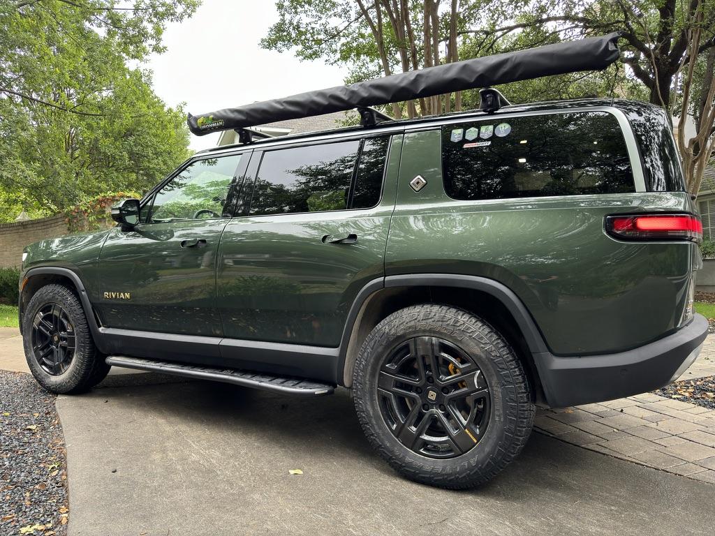

? Tell ya what, if you do any kind of off-roading, they might be worth the investment for the kick out alone. I’m a little puzzled as to why kick outs aren’t the default design for sliders…
An unexpected benefit of the kick outs are that they provide a stable platform for getting stuff in and out of a rooftop cargo box, especially heavier stuff like tables. The wider step area lets you plant your heel at any angle you need to pivot while doing that.

I'm a guy who won't do much or any off roading, but really like the idea of added comfort in getting in & out. I'm R1T guy so are my options the Megawatt, which might be more than it need/want?, meaning is there a good running board/step that is more Rivian based? I'm in a condo & don't really have good place to install without some additional doing, I'd prefer to have Rivian install. Thoughts?
I looked at a few other options before choosing the Megawatts. If I were just getting running boards instead of rock sliders, I'd probably get the EVSportline offering. I'd say Megawatts—and rock sliders in general—are overkill if you don't intend to off-road. They increase weight and cost for no benefit.
That said, the Megawatt's kick-out feature provides a nice large platform for your feet when getting things on and off the roof.

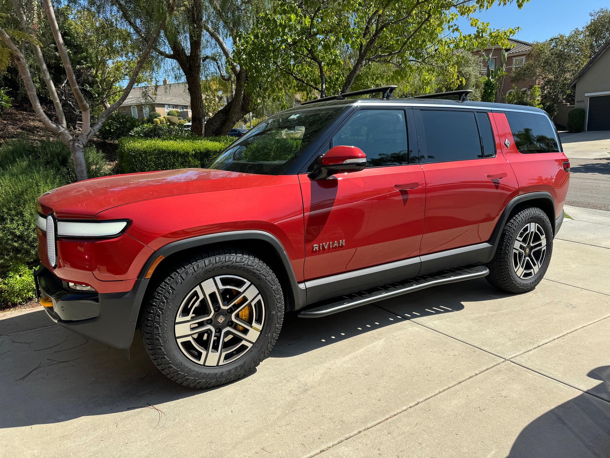

If getting sliders, Megawatt is the way (a great design with fantastic quality and welds). If just need running boards, then get those. But, if needs slider, there's not much point to the ones that don't provide full coverage or lack a bump out. The install is also relatively easy. Removing the panels with many hidden clips is the tough part.
