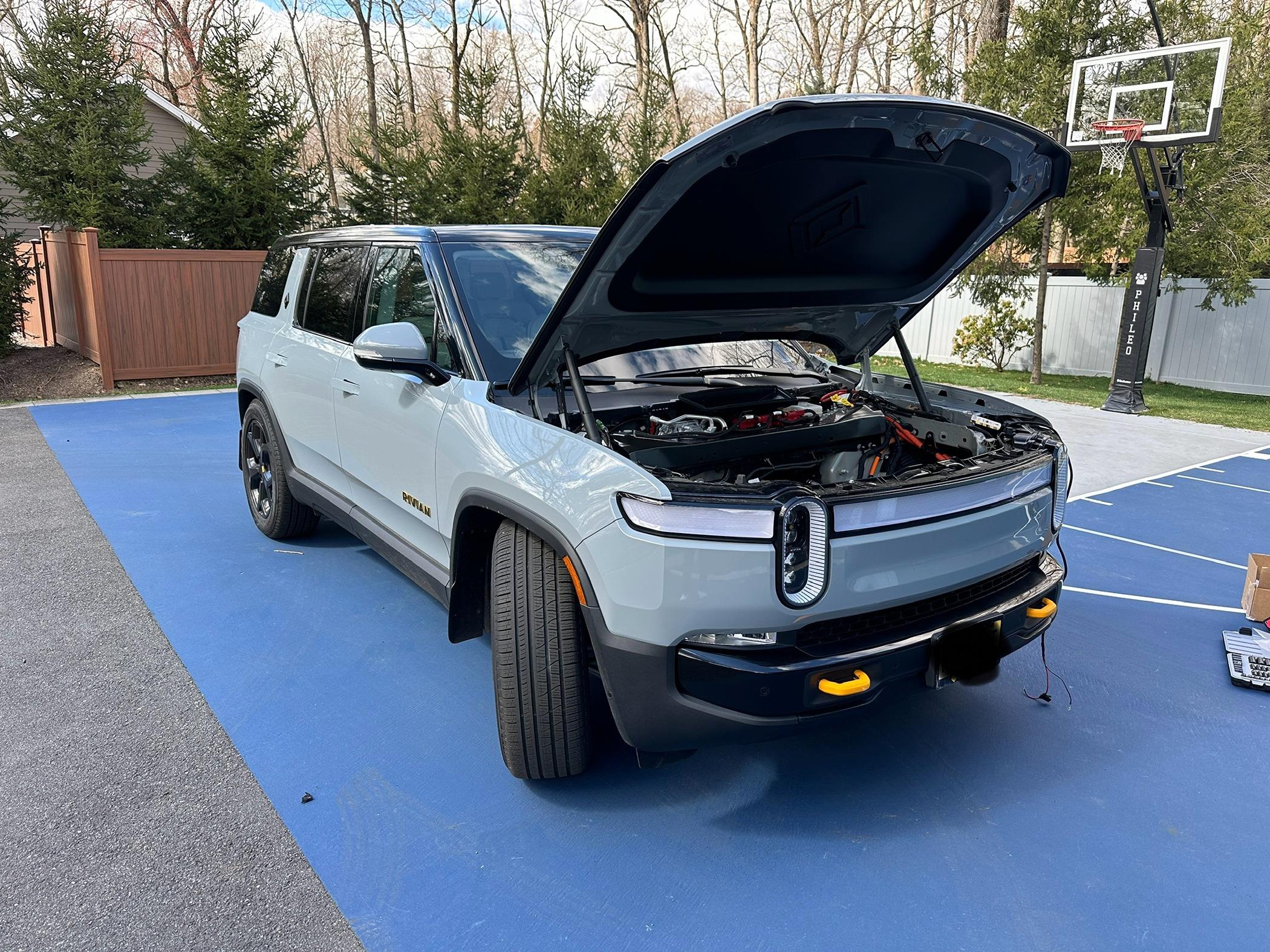

Here's the before:
Here's the after:

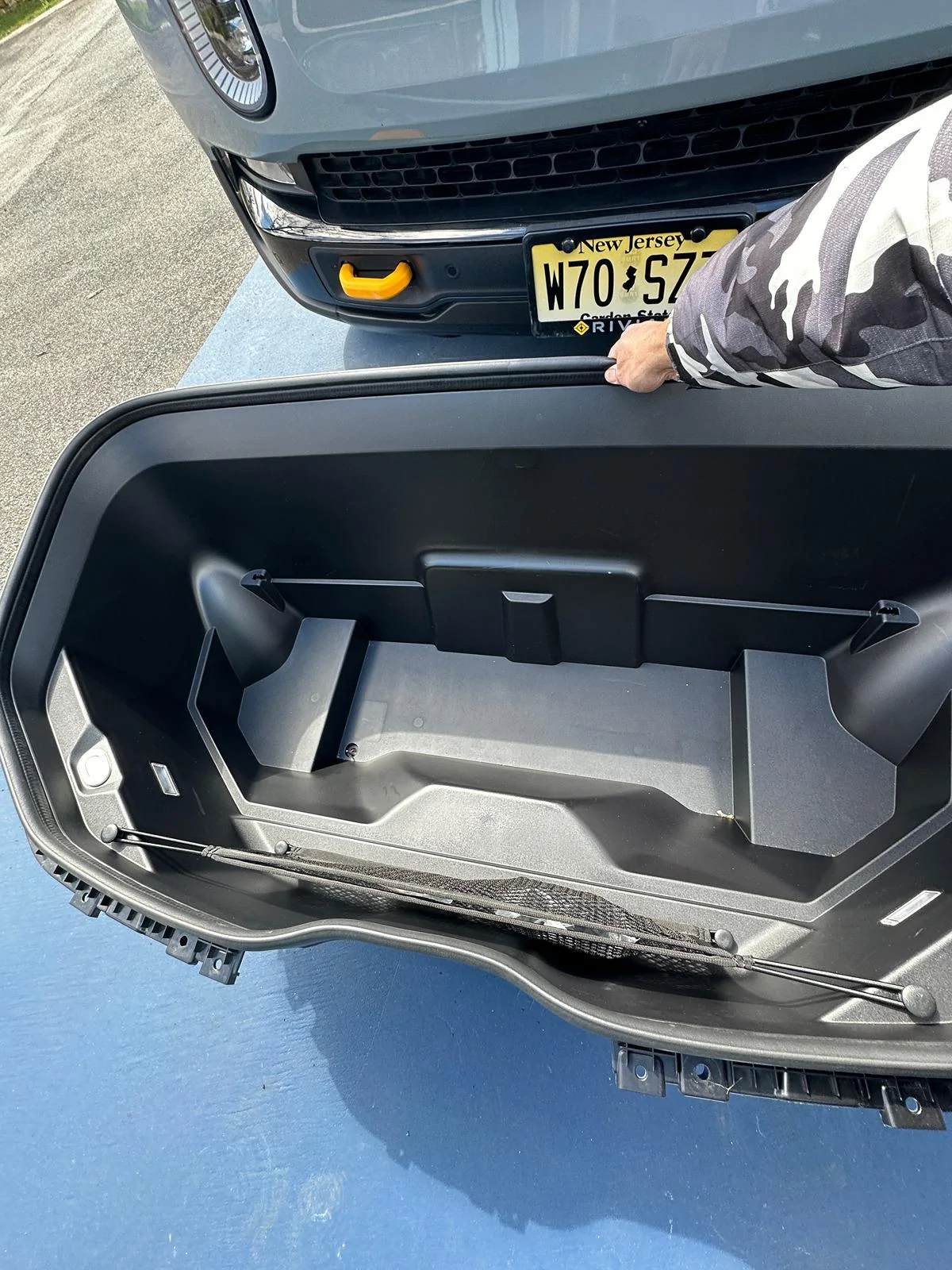

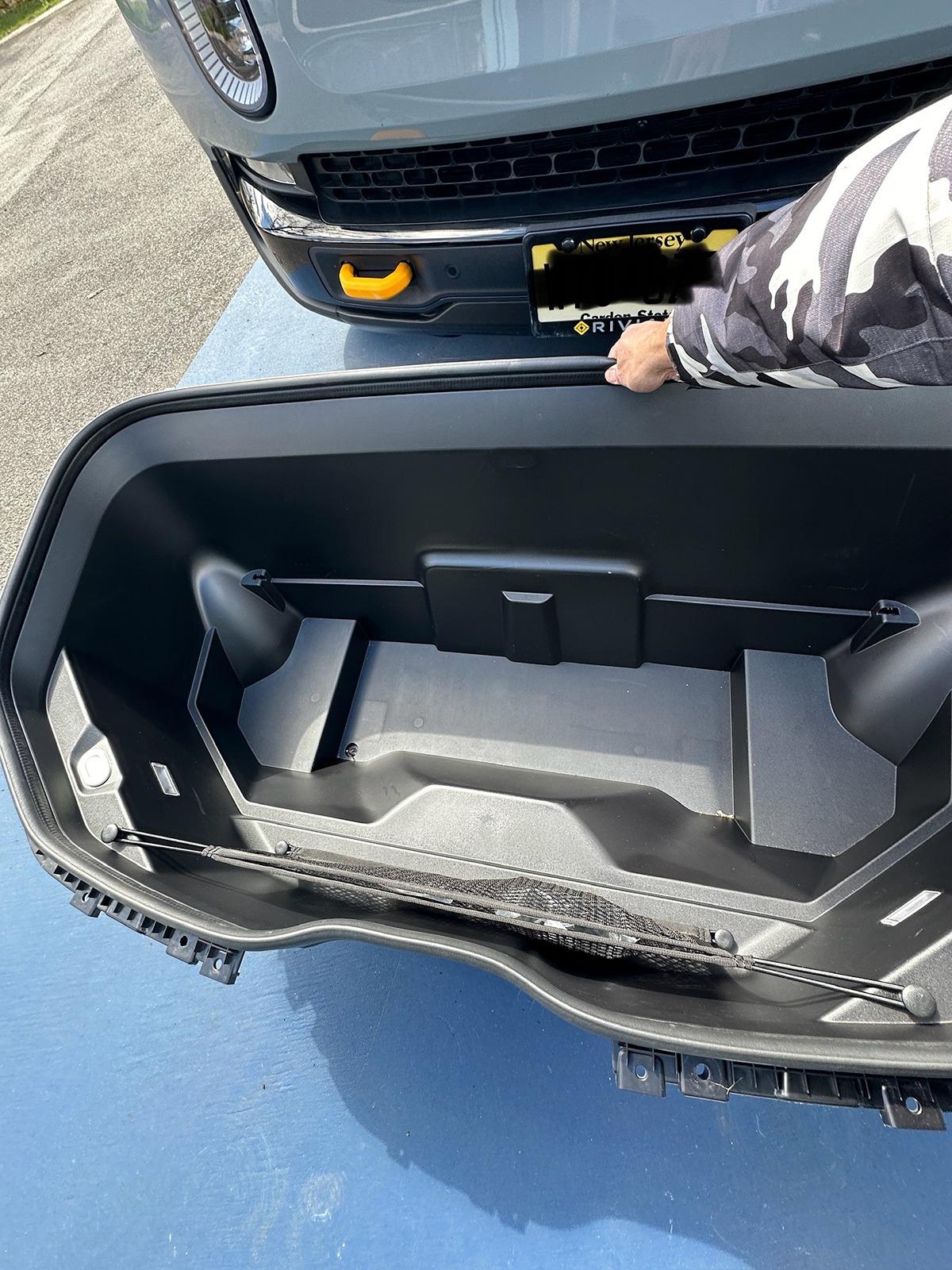

The instructions recommend two people to help remove the tub, but one person can do it (I didn't have anyone around to help) if you grab from the middle.
Rivian R1T R1S Horn Upgrade (Passenger Side) by RealWheelsEV -- install instructions, before & after video sound clips IMG_9635 2

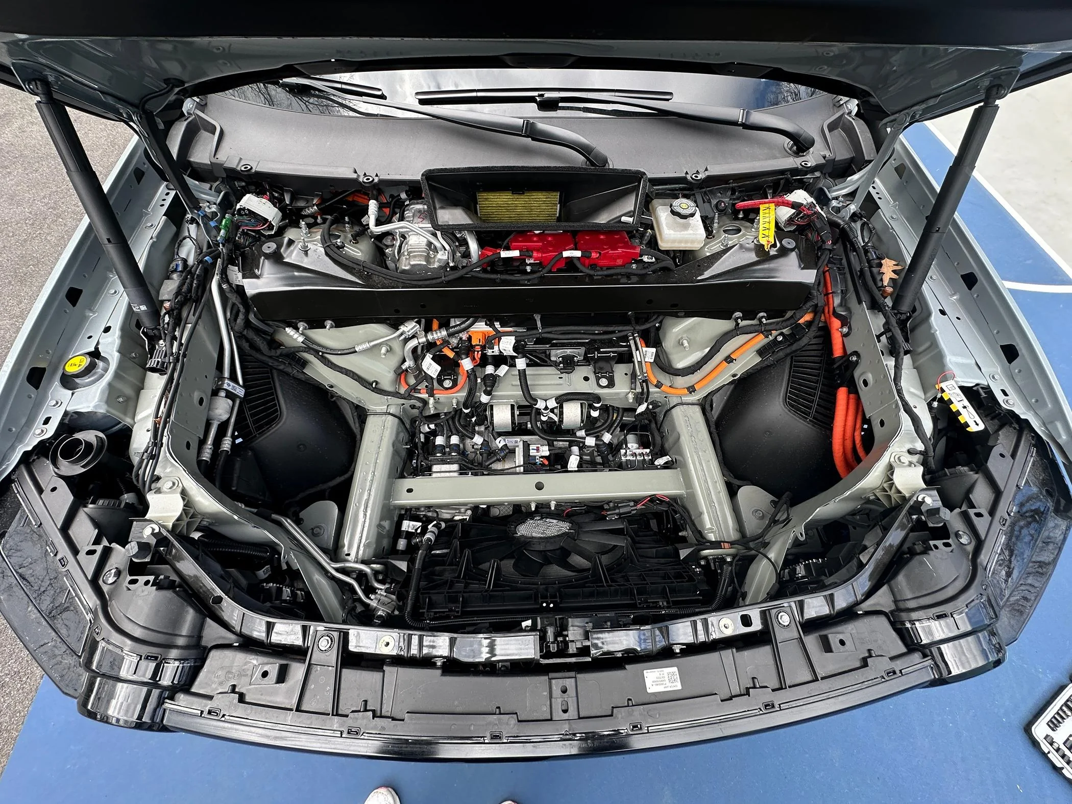

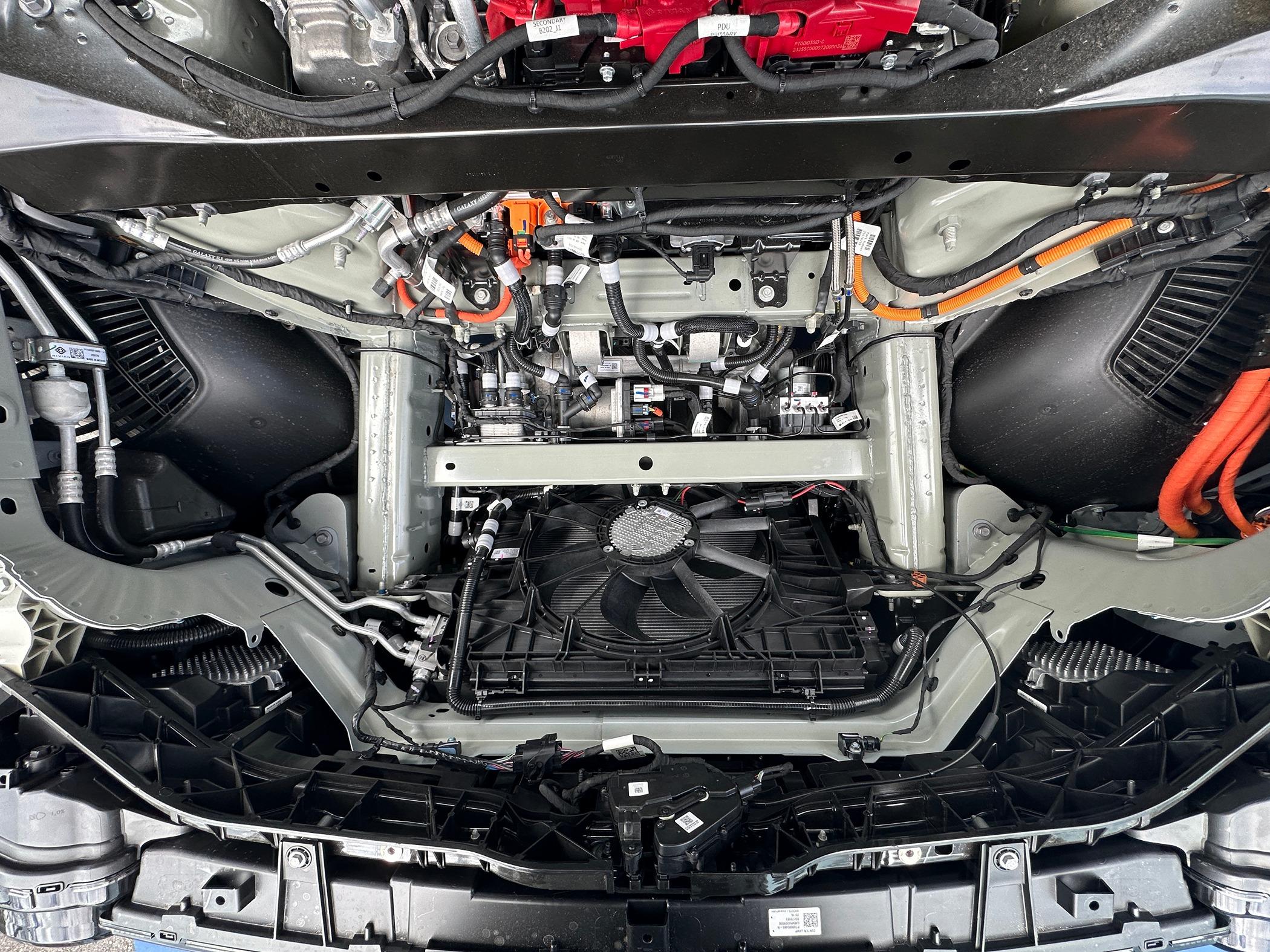

Here's the inside of frunk area of the Rivian with the tub removed. Once the trims are removed, there are 8 bolts that need to be removed and two LED wire connectors that need to be unplugged and the tub comes out.

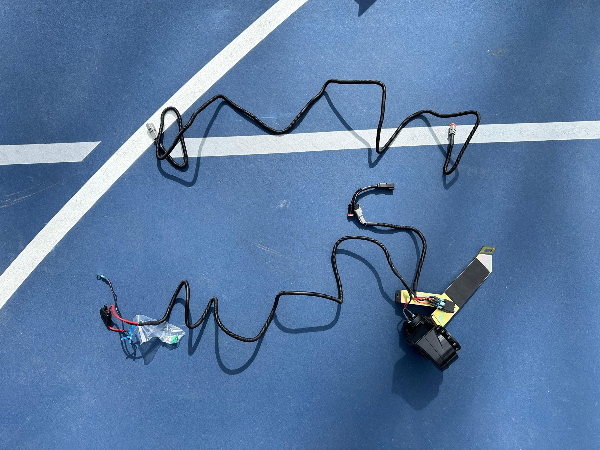

Rivian R1T R1S Horn Upgrade (Passenger Side) by RealWheelsEV -- install instructions, before & after video sound clips IMG_9623 2.JPG
The difference with the passenger kit is the additional extension cable (top).

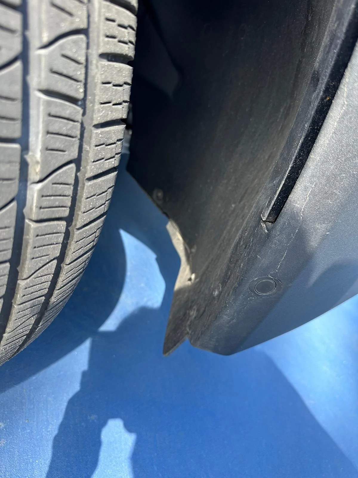

To access the passenger side wheel well it's recommended to turn the steering wheel all the way to the right. There are 6 torx bolts in the wheel well that need to be undone to reveal the passenger side horn.
