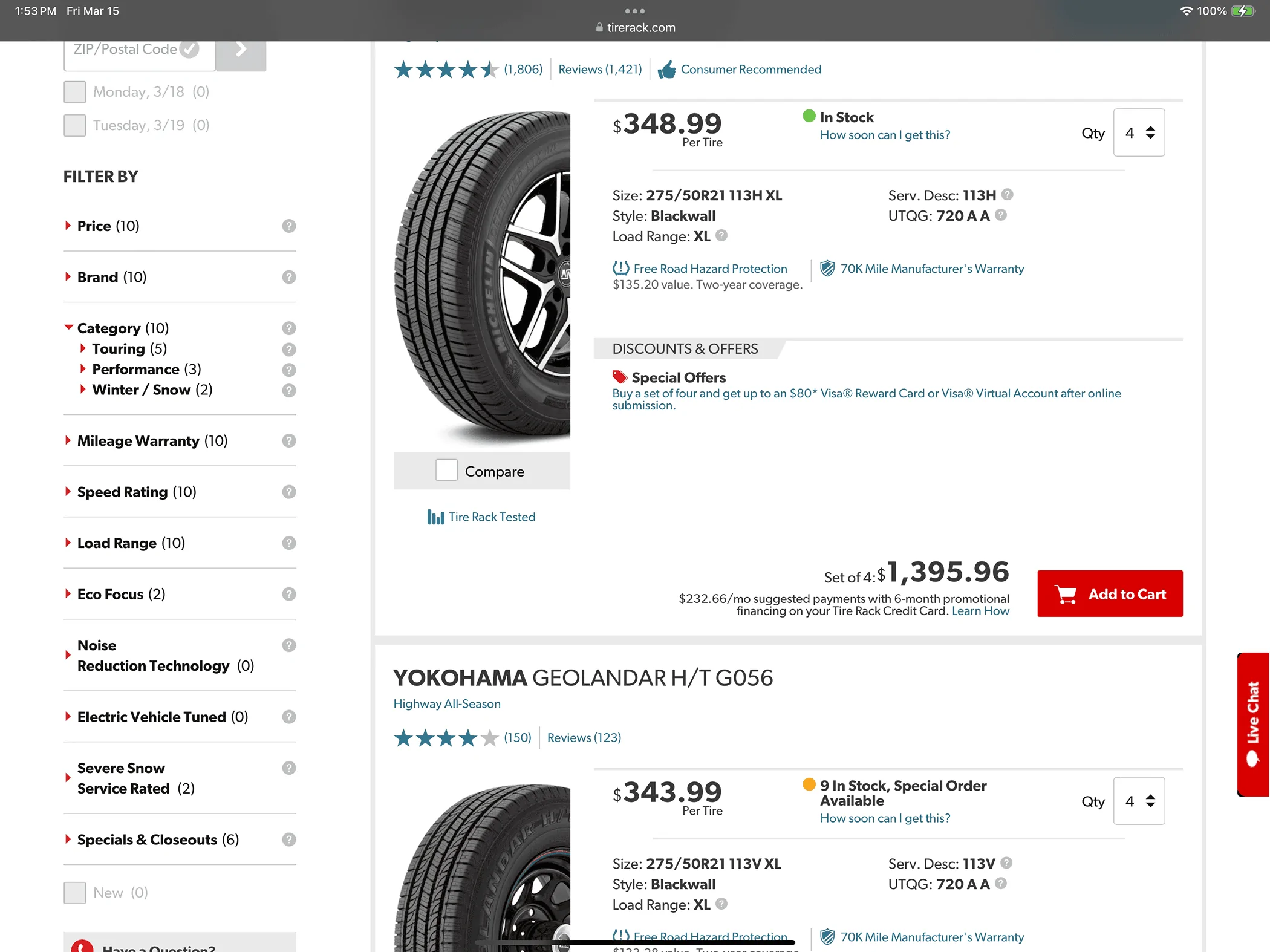

No AT tires on TireRack in that size?

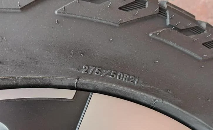

Rivian R1T R1S R2 Tire Size = 275/50R21 IMG_0114
Probably going to need to go to 275/55r20 or maybe 275/65r18 if the calipers allow it.
