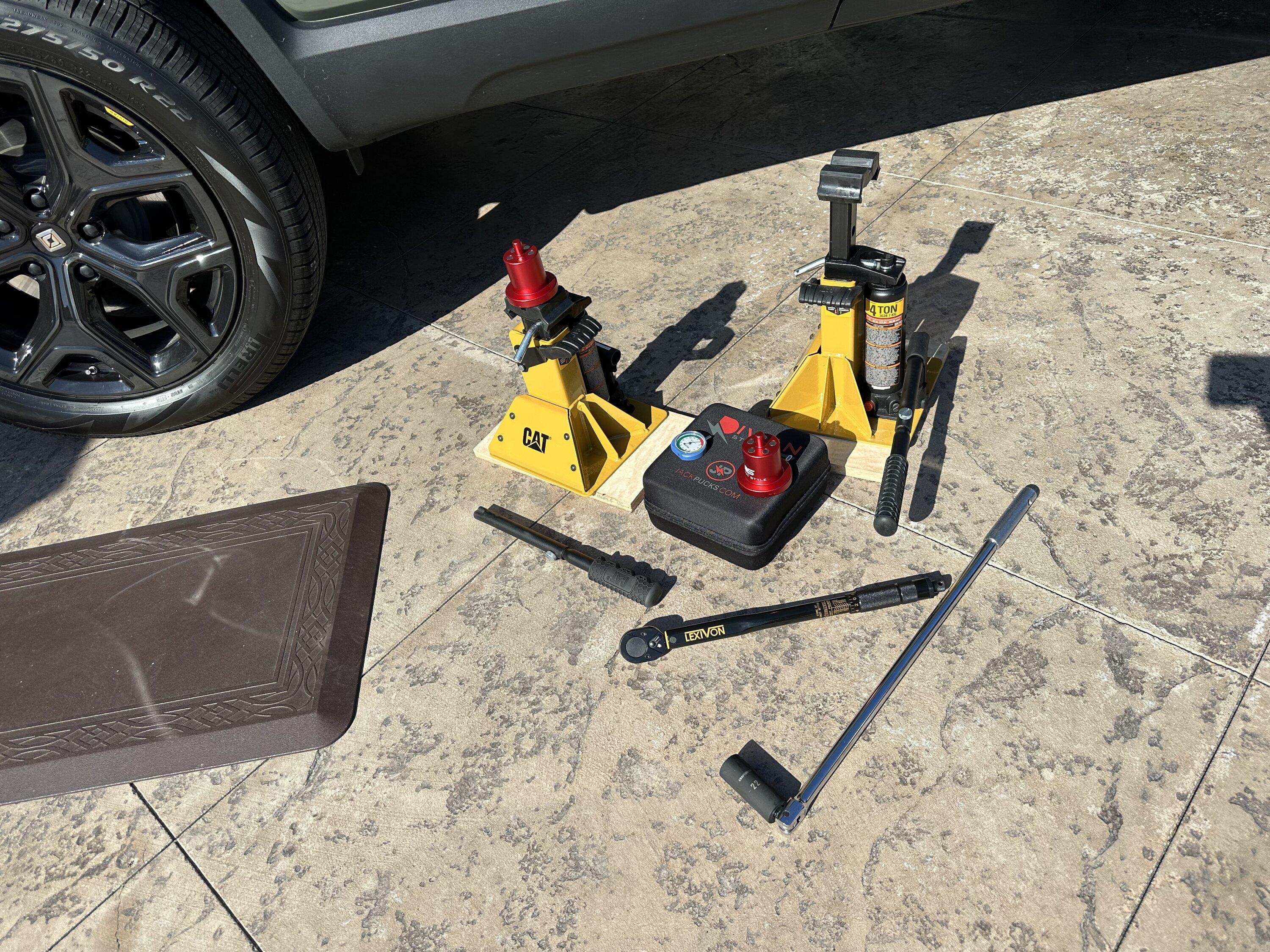

Good video, but I wish someone would show how they do it without a full size spare. Everyone always says be safe, use jack stands, but I still haven't seen a video showing jack stand placement on a Rivian or how they lift both jack points with one jack (I don't think you can get a jack stand under a puck)
Also, not showing a full rotation without a full sized spare. I assume you jack up the sides, swap the sides, then jack up the front and swap the fronts?
They make a jack-stand/Jack combo units, I picked up a couple to do my tire rotations. There are a few different ones out there but work well.
