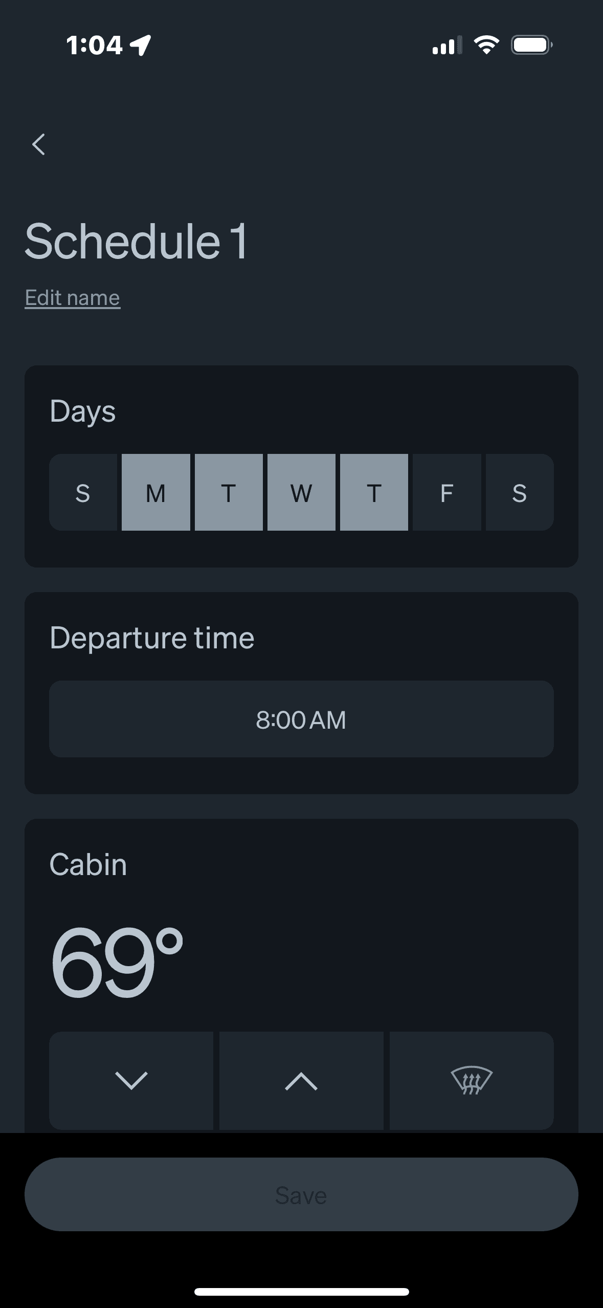

These Rivian owners previewed our newest software update, which lets you create climate schedules so your vehicle is comfortable & the battery preconditioned when it's time to go. Also: a new regen brake assist feature for year-round drive consistency. http://rivn.co/ota50
34,501
I used the climate schedule for the first time this morning. Very convenient! Don’t have to remember to open the app and turn it on while I’m getting ready to leave for work anymore.. Nice update!

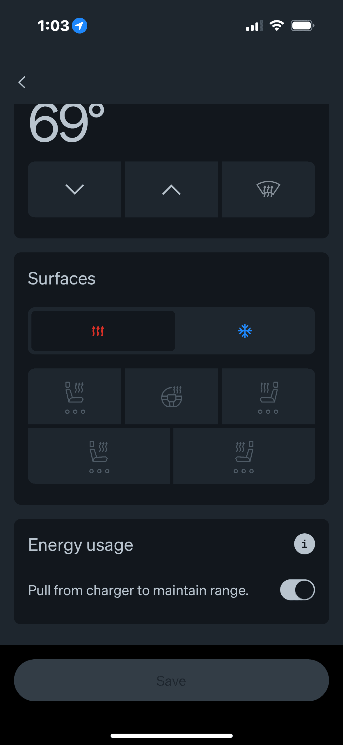

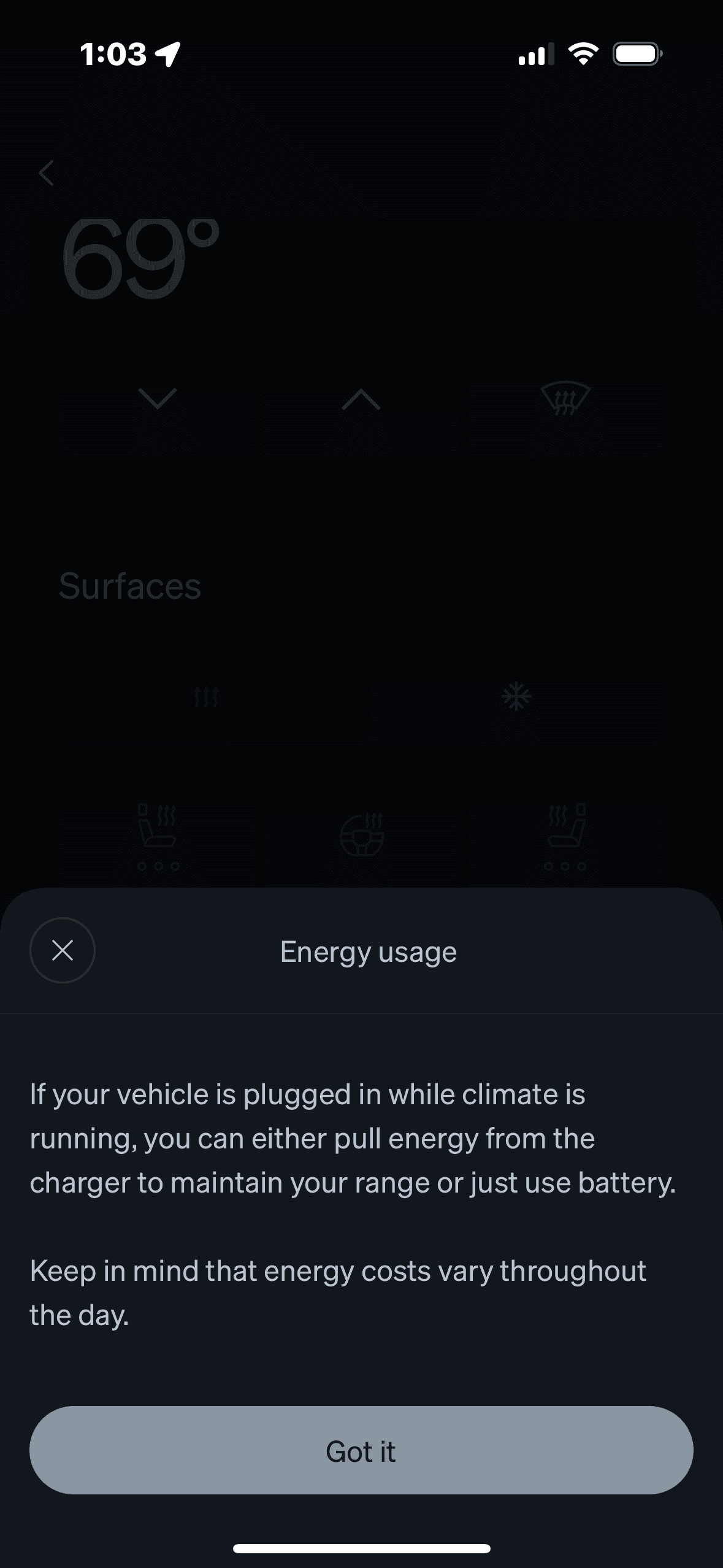

FWIW it also gives you a choice whether to use charger or battery power when you set up the schedule. So if you chose charger power it wouldn't decrease your range if you left later than expected.
