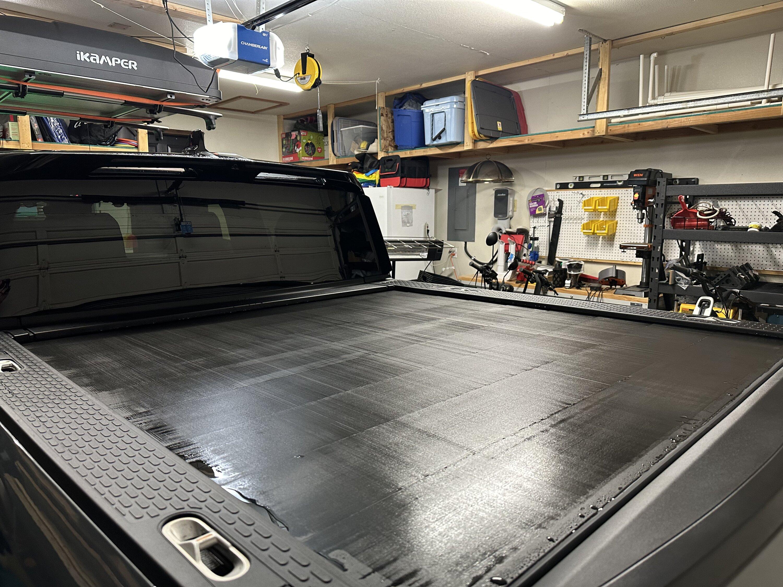

Just picked up my truck from getting the new updated powered tonneau cover installed at the Denver service center. They said they went to normal to watch them test the cover and that engineers poured sand into and on top of the cover and it ran with no problem.
They said it was the 2nd ever updated install and they ran it 20 times with no issues or weird noises before calling me to pick it up. I think it works and sounds much better now! The slats don’t sound like they are bending and fighting each other and the motor isn’t getting as bogged down.
Updates:
Still just One motor
Updated spring system to prevent panels from getting out of alignment
Updated bottom panel system
Reinforced interior and gearing
Something internally to help keep slats/gears clean

Have you checked to see if it keeps water out of the bed?
It’s about the same as before water resistance but not fully water tight. Little drips get in on the side but not much.

Same slats and slat material and strength, or some cheap junk like the manual cover?
Seems to be the same thick double walled slats with a smoother joint. Honestly doesn’t have any major differences from the original panels.

Do the slates "overlap" each other, or do they lay flush to each other? It looks flush to me, but may just be the angle.
