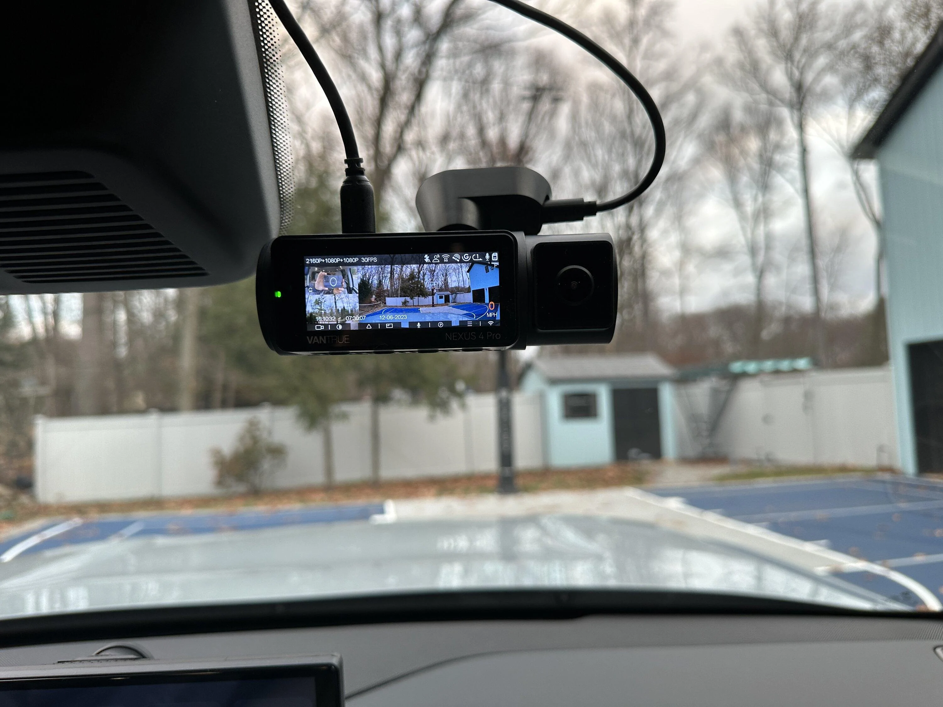

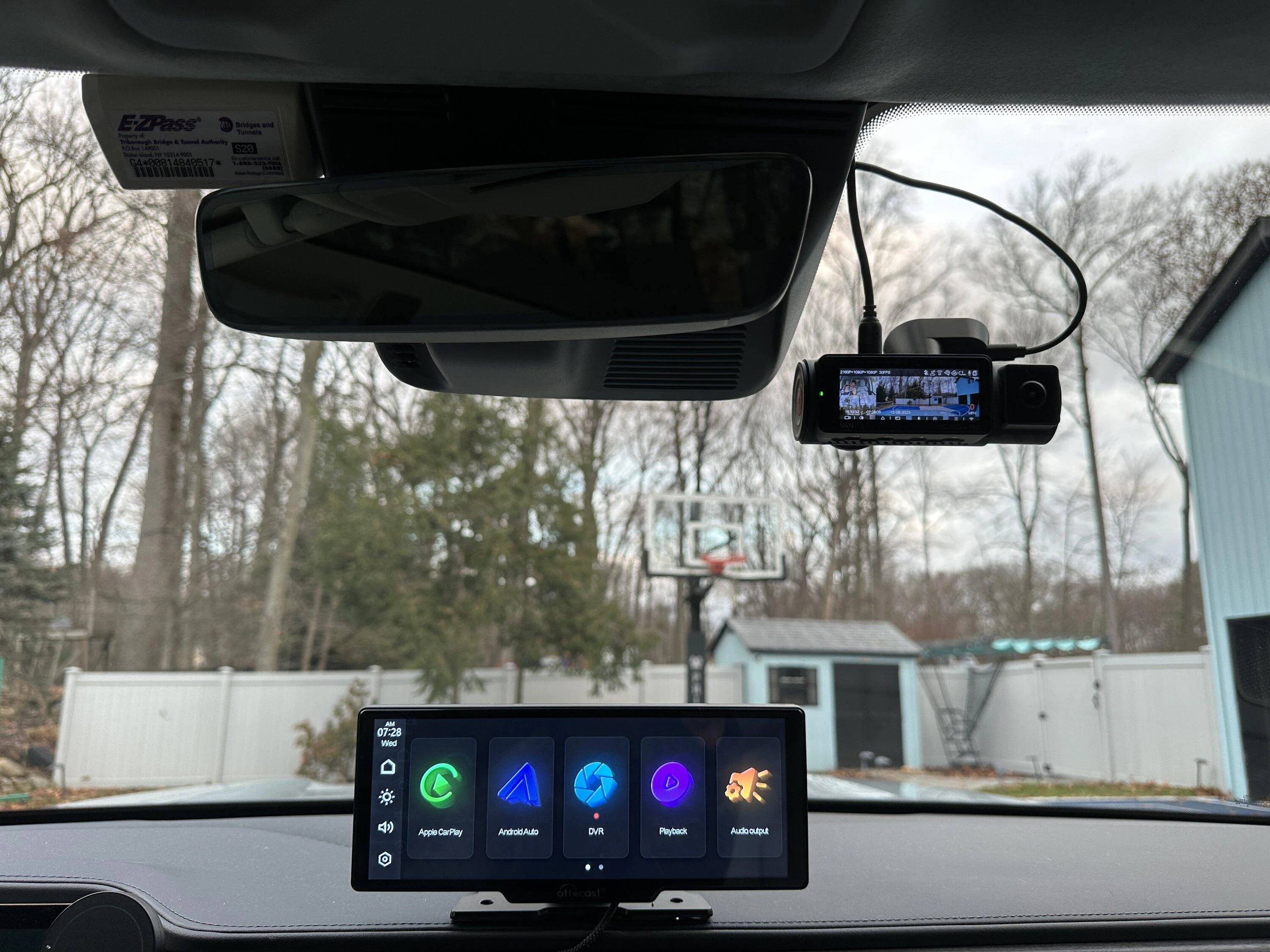

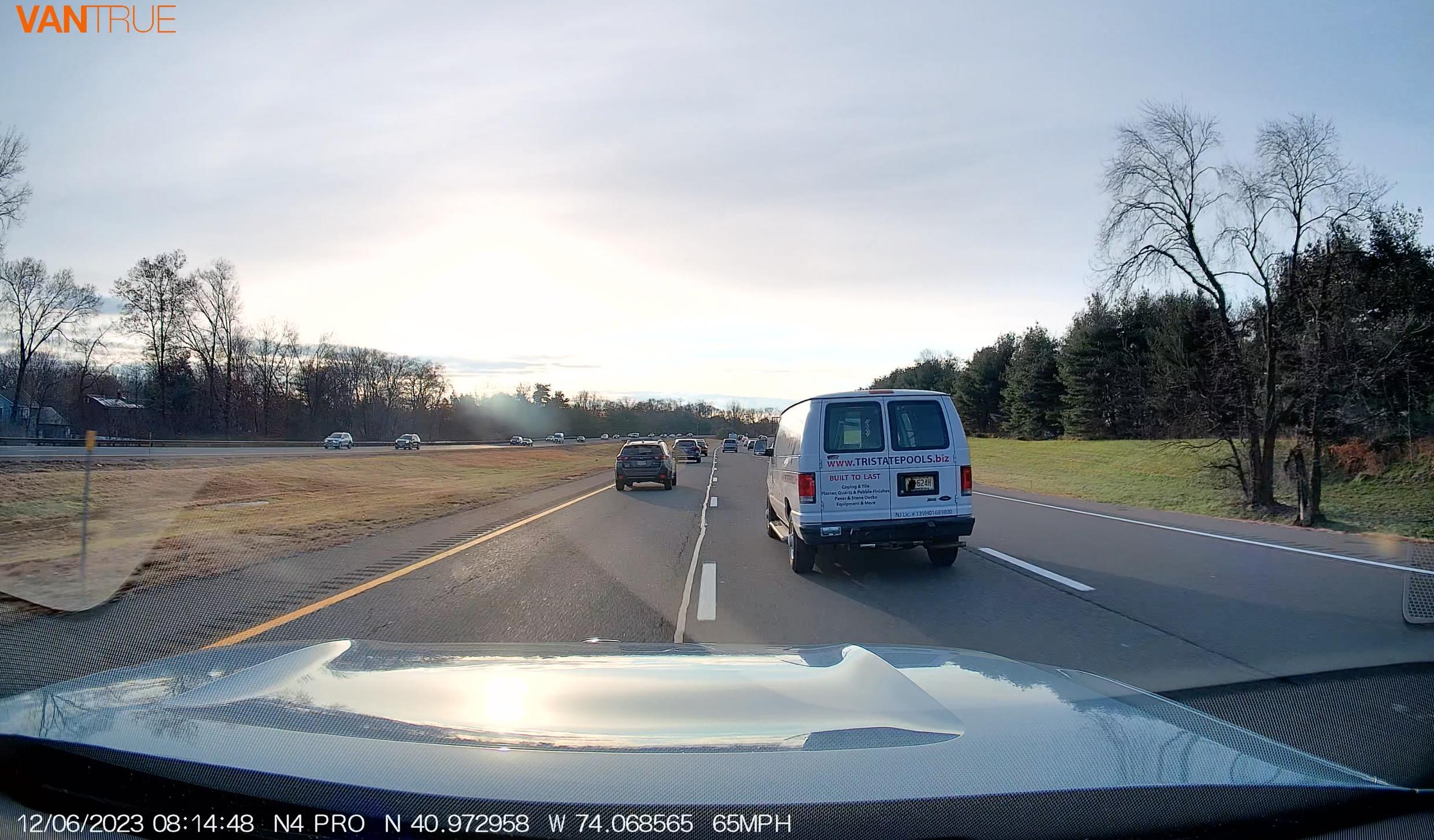

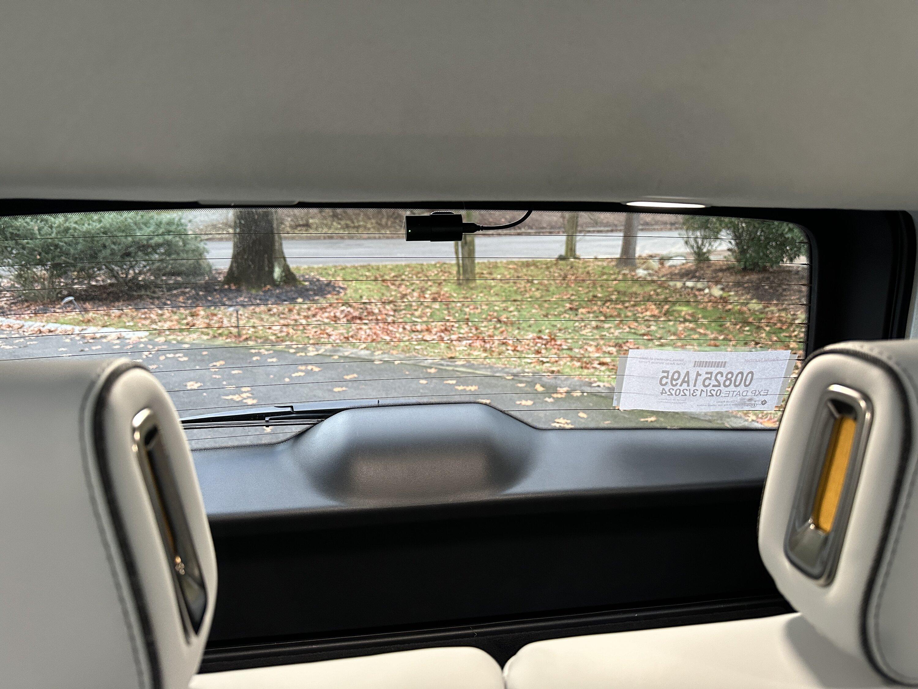

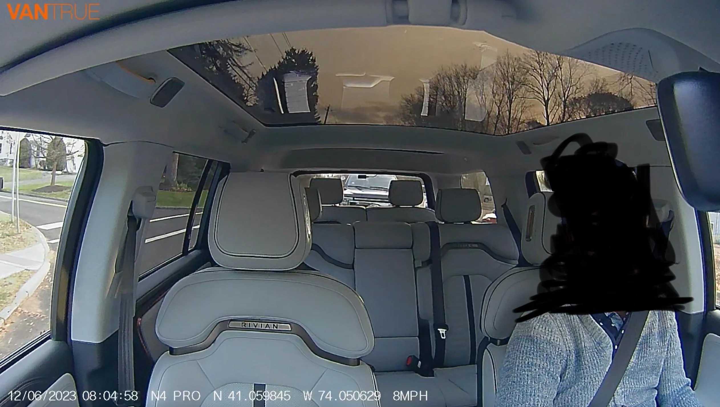

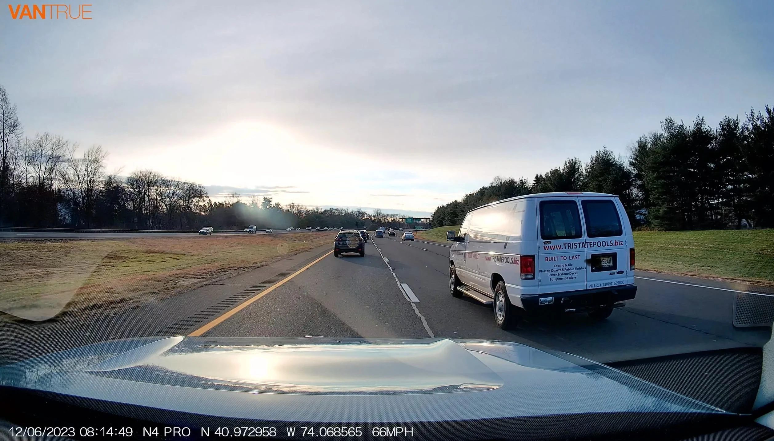

I purchased and installed the Vantrue 4N Pro 4K Triple Dash Cam with GPS tracking from Amazon to allow for license plates to be captured. That's the issue with the inbuilt Drive Cam.

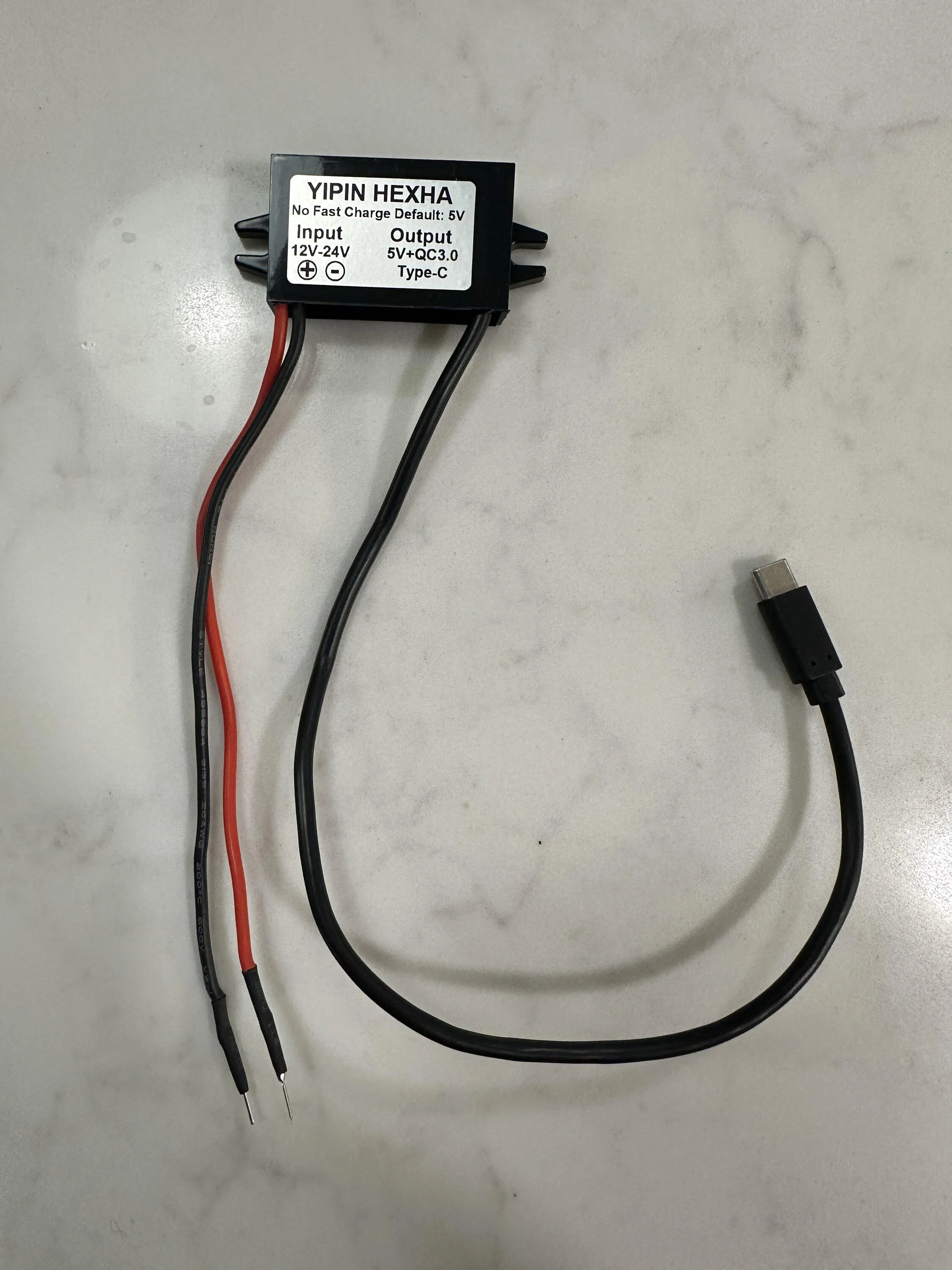

As I just got my R1S, it doesn’t come with the 12v under dash power. I tried to power the camera with the Garmin OBD solution I already have for CarPlay and MagSafe mount, but the camera is power hungry and wouldn’t stay on. So I had to do a rear view mirror tap.
Thanks to @citizen and his instructions here:
https://www.rivianforums.com/forum/...-installed-via-mirror-tap-diy-tutorial.18533/
I followed the instructions exactly and it’s working really well now.

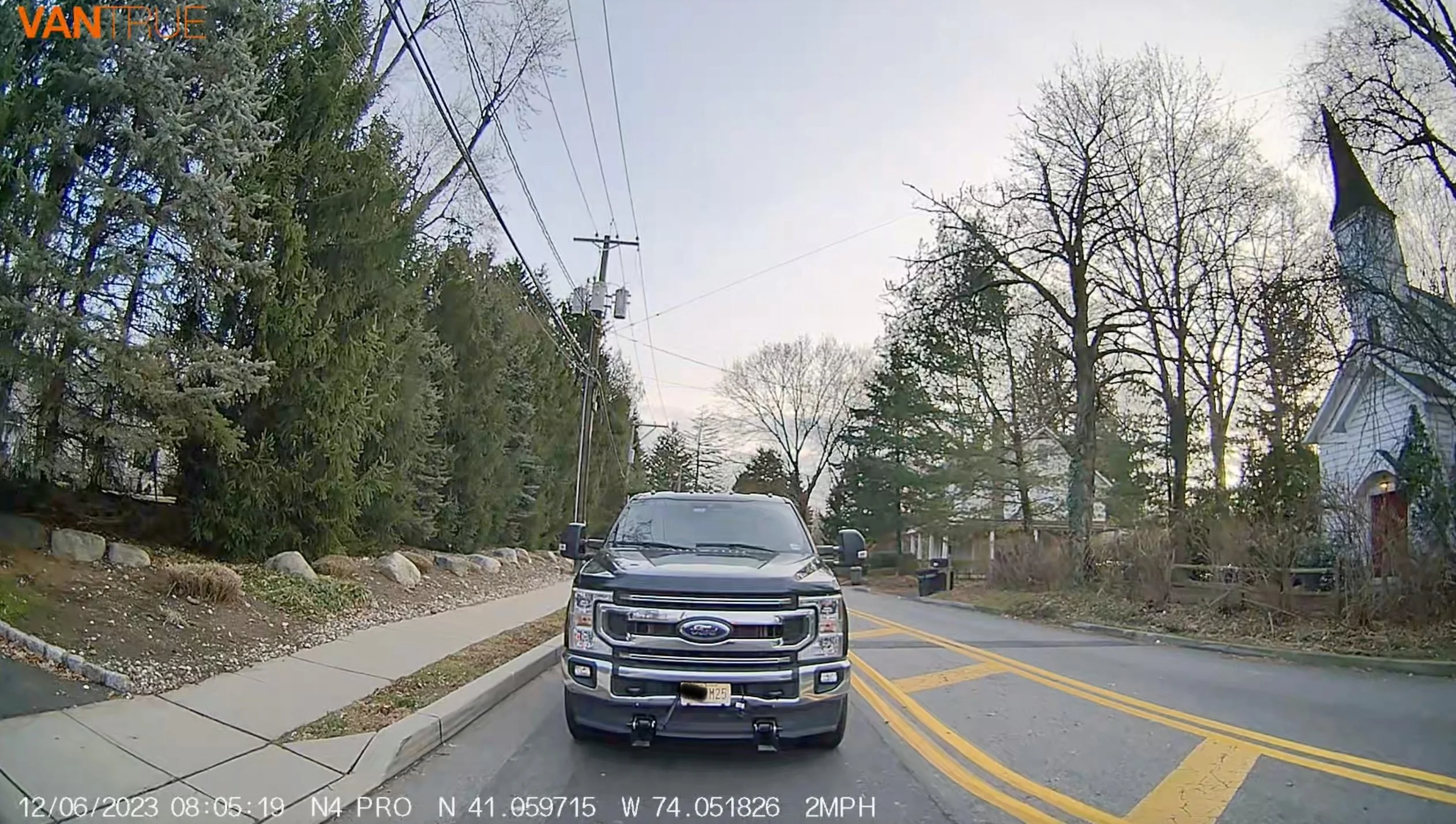

If you search online this is probably one of the few dashcam that captures license plates really well. I’ve attached some pics. If you observe the commercial van you can make out a lot of details from the videos besides the license plates. The rearview cam is pretty good too capturing the license plate of stopped F150.

Hmm, those pics are pretty clear, hows the night vision? I have a Blackvue wired in my Bronco, been debating getting a decent setup in the Rivian, the built in cams are just awful, quite disappointing.

It’s pretty clear. This is not my video but I checked a bunch out before I purchased it.

It looks like the rear camera is 1080P? This probably works well with an SUV like the R1S because the camera is at the rear of the vehicle. For pickup trucks, I've had issues getting good license captures with the rear window camera due to the bed. It either obscures the plate, or the vehicle is too far away. I'm running a Thinkware U1000 (4k front 2k rear) to help alleviate that in my R1T.

Yes, 4K up front, 1080P rear and 1080P inside cabin camera.

The rear camera connects to the front one with USB-C on the Vantrue.
