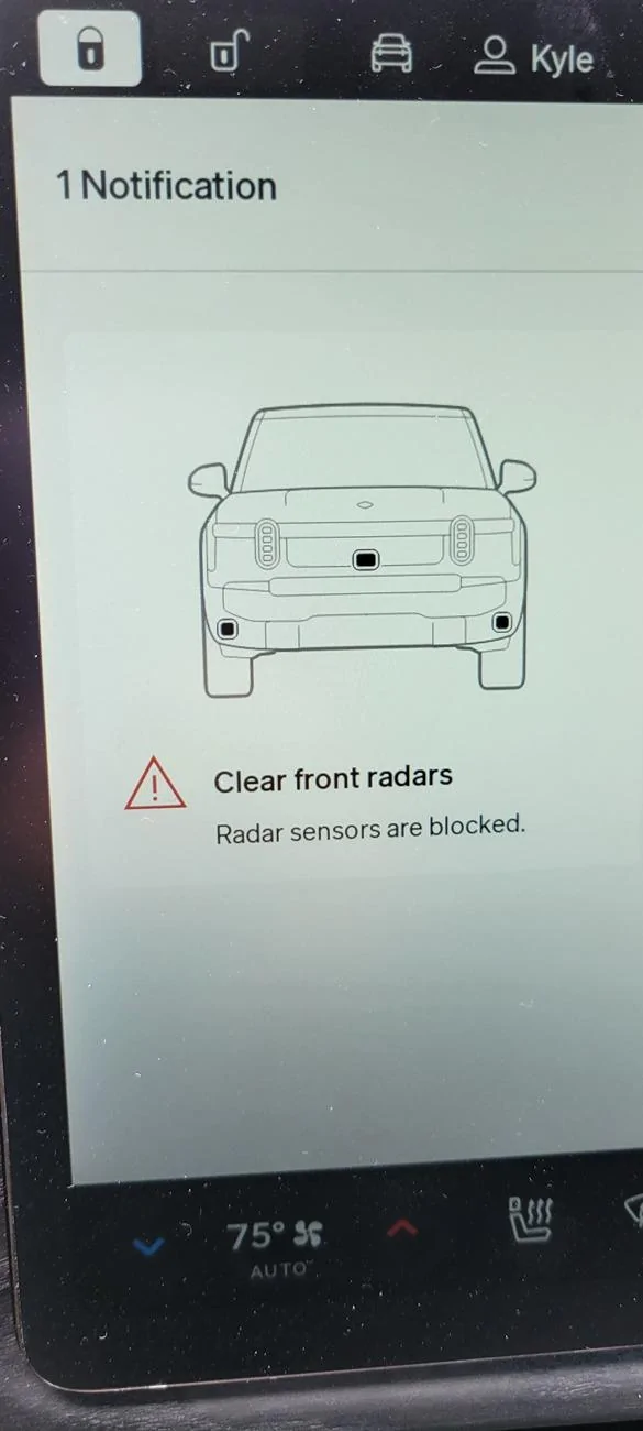

Anyone else get this warning after the update? My car is clean, can't find anything that would block the front radars. When I was driving with my son yesterday the screens did go dark like a software reset had happened while I was driving. I carried on as they rebooted. It was strange.
Any way to specifically report things to rivian for their awareness? I did send service a message and pre-emptively schedule a service appt for Sept 20, but don't want to drive up to Franklin 90 miles if I don't need to.

I noticed it would not when I drive in low height. I did a software reset put it to auto, and now it seemed to work the last few times I've driven.
Do have a weird "clear front radars" notification now though.
I was getting that notification a lot before the update. And it was the first notification I got before the car bricked itself. Hard reset and so far so good…
Thank you for the info!
I'll maybe have to try that when I'm back in town next weekend. In the meantime I'll see if Riv service gets back to me this week too.

I would get that warning but then after pulling out of my garage it would seem to go away. Maybe because it’s too close to objects in front so it think they are blocked?
I haven’t done a hard reset yet, seems like it isn’t usually recommended? Any harm in doing so?
