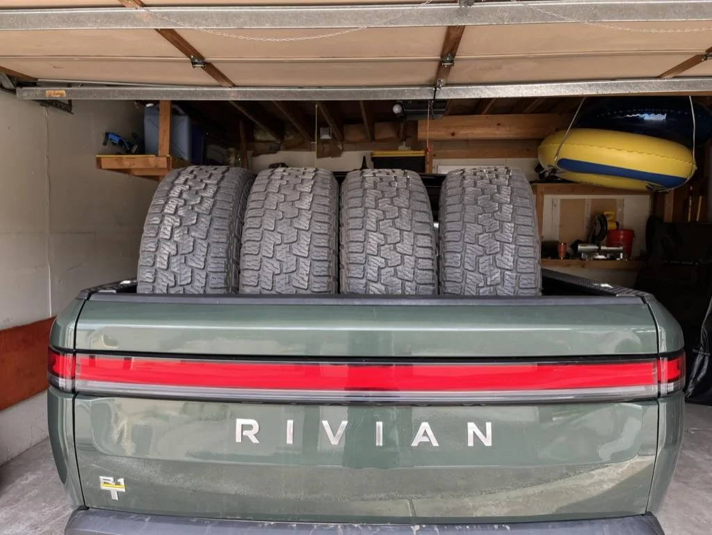

Hi folks - just wanted to provide some details as I take off my winter tires for the season. These were the Blizzak LT 275/65 R20.
Miles: 8760
Efficiency: 2.04 mi/kWh
Tread wear: 3/32 (tread depth is now at 14/32, originally 17/32).
I am pretty impressed that these did not wear down more, considering in the Colorado front range you do a lot of dry pavement driving on snow tires. For comparison, my 20" All terrains wore down 5/32 after 7200 miles (originally 13/32, now 8/32). Wear was pretty even across the board, most of the driving was in all purpose/snow mode.
EDIT: reminded below, it is probably worth mentioning in the warmer weather I was seeing basically an identical efficiency to the Pirellis (2.2 mi/kWh). I believe it is just the cold weather that led to a lower efficiency, the tires did not have an appreciable impact.

We also get the lower air resistance benefit here 😉 . But really it doesn't seem like they have much of an impact on efficiency. In November when I put them on, I was getting 2.2. Last week (first warm weather week here in Colorado) I was also getting 2.2, so right on what I see with the Pirellis. I think the cold temps were the driver of the lower winter efficiency.

Good to know, definitely a lot of variability, we track most trips and typically ended up around 2.0 mi/kWh. Although I don't think I hit 85 mph on the snow tires except maybe once or twice!

I definitely agree tire change didn't seem to make enough difference in range loss. Temperature is the biggest factor. Tire change definitely would with my Bolt EV though.

Didn't see any different than my 20" AT that i kept on until the middle of December. My 26,000 mile average is 2.19. Temperature seems to big the biggest factor. I also park in a heated garage.

I made the same swap, and saw 1.78 mi/kWh over about 4000 miles this winter, down from my lifetime average of around 1.9. That reflects a heavy bias towards actual winter driving, namely lots of trips up and over mountain passes, driving through blizzards, playing in powder, etc. I also had skis and/or my RTT mounted for probably half of those miles.
All other things being equal, I haven't seen any appreciable difference between the Pirellis and the Blizzaks in efficiency - both are capable of beating the manufacturer estimates under good circumstances. But the Blizzaks were outstanding in the snow. I cruised through several drives where the ditches were littered with other vehicles. Great upgrade for the winter.
