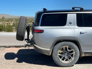

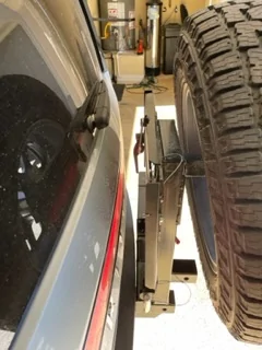

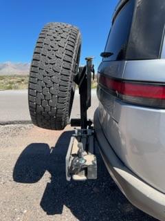

I bought a used Rigid Armor swing arm hitch mount spare tire carrier from a local seller. After a quick test fit, I was sold. The model is a Subaru Cross-Trek Hybrid version link: https://www.rigid-armor.com/shop/subaru-crosstrek-hybrid-swing-out-tire-carrier
He also had the optional fold down table link: https://www.rigid-armor.com/shop/swing-out-carrier-fold-out-table
He sold me both for $900 (versus $1100 + $275 list price).
To use the carrier with the R1S, I used a 2” aluminum wheel spacer link: GDSMOTU 5x5.5 Wheel Spacers 2... https://www.amazon.com/dp/B09KY48NNR?ref=ppx_pop_mob_ap_share

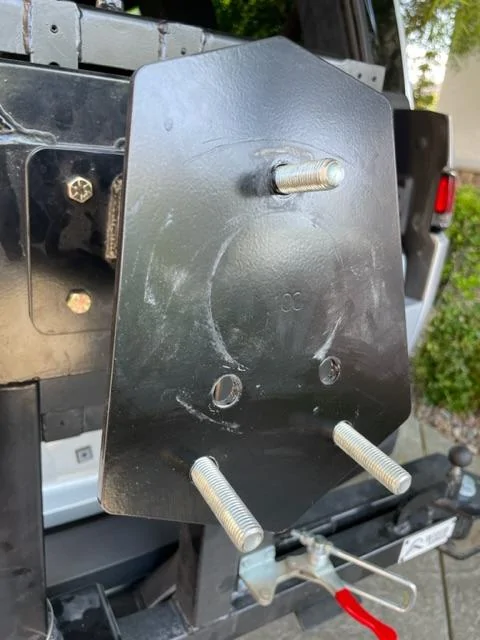

I also had to drill two 1/2” holes through the steel tire mounting plate (using $20 cobalt bit, basic cordless DIY drill, and some oil lubricant from a hair clipper). The Subaru bolt pattern is 5 x 100 mm, while the R1S is 5 x 139 mm.
Lastly, to attach the license plate I used:
- 12 x 2 x 2” wood painted black
- two dryers vent clamps (Deflecto 4" Metal Worm Drive Clamps, 2 Pk MCX4/4)
- included Rivian front license plate bracket
- strips of window/door foam weather strips to prevent clamps from scratching paint on hitch
I simply wrapped the clamps/foam weather strips around the 2 x 2” wood and the actual swing arm. I then attached the Rivian plate mount to the wood with a couple screws. Thanks for the idea @909phillyman!
I don’t have actual clearance measurements, but I did place the key fob in some of the photos for scale. Apologize for the dusty pics, just finished a trail!
Rivian R1T R1S Rigid Armor hitch spare tire carrier for R1S -- installed photos & review IMG_3827
Rivian R1T R1S Rigid Armor hitch spare tire carrier for R1S -- installed photos & review IMG_3828
Rivian R1T R1S Rigid Armor hitch spare tire carrier for R1S -- installed photos & review IMG_3825
Rivian R1T R1S Rigid Armor hitch spare tire carrier for R1S -- installed photos & review IMG_3821
Rivian R1T R1S Rigid Armor hitch spare tire carrier for R1S -- installed photos & review IMG_3822

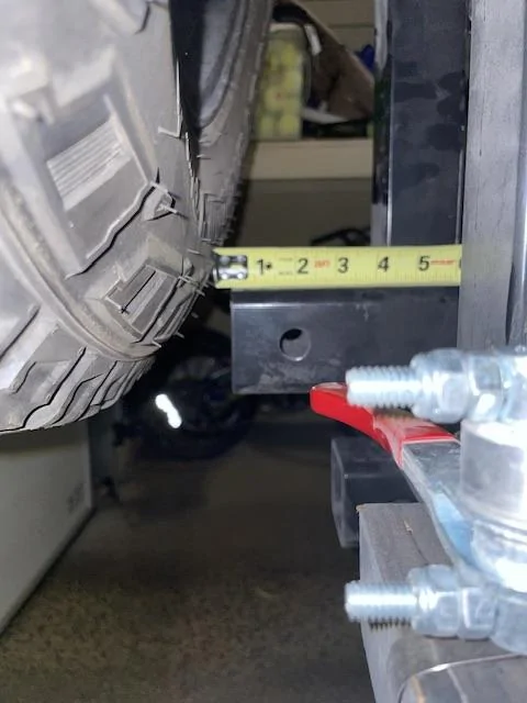

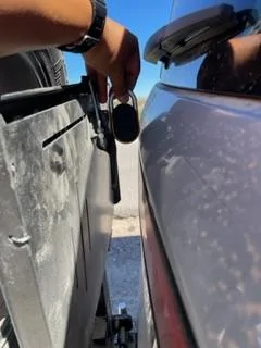

About 1.5” of space between table release lever and rear hatch.
Rivian R1T R1S Rigid Armor hitch spare tire carrier for R1S -- installed photos & review IMG_3816

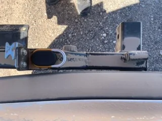

Hitch attaches with only a few mm of space to rear bumper. Rigid Armor has great anti-wobble hitch tensioner that prevents any movement!
Rivian R1T R1S Rigid Armor hitch spare tire carrier for R1S -- installed photos & review IMG_3814

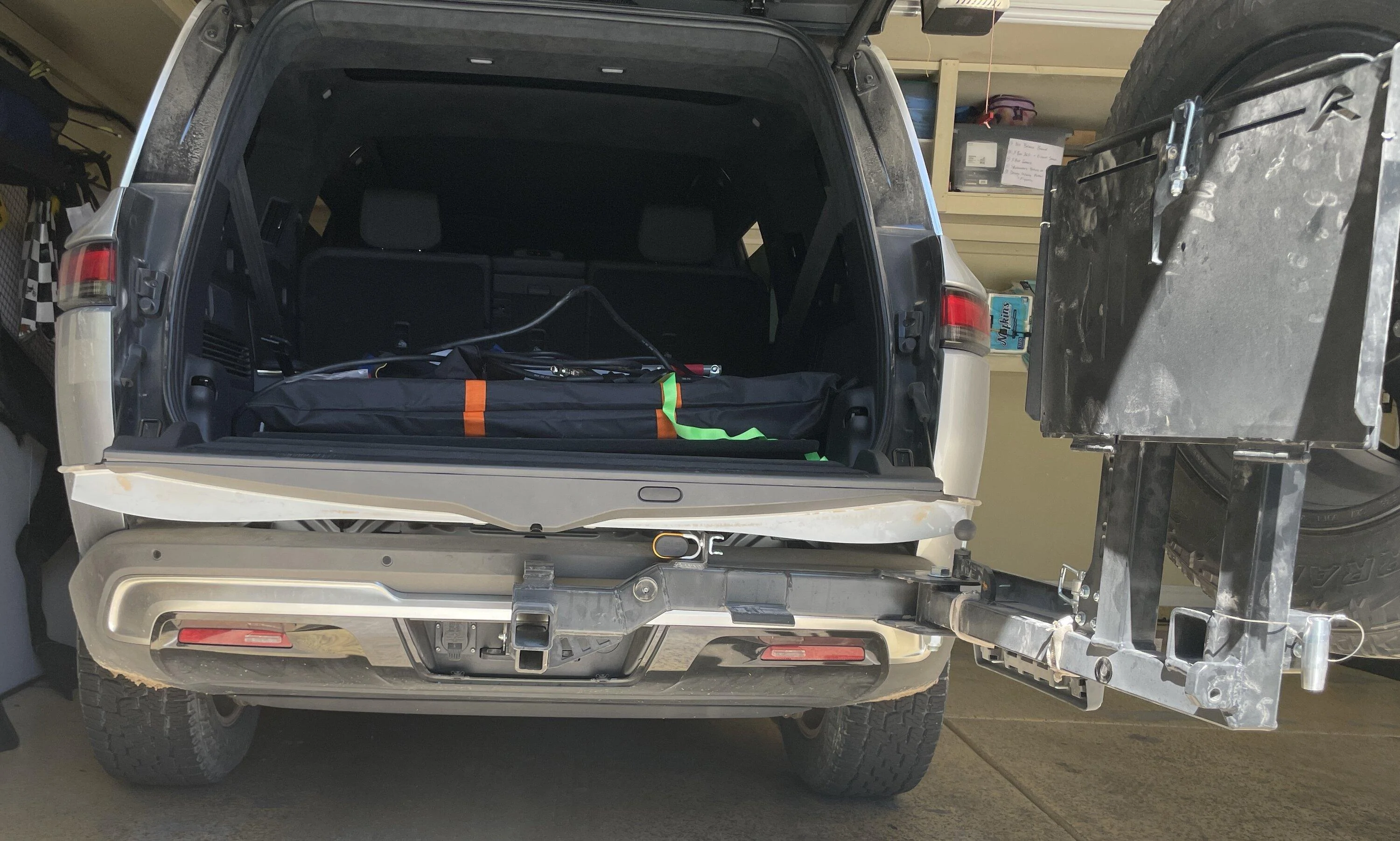

Plenty of clearance to open hatch.
Rivian R1T R1S Rigid Armor hitch spare tire carrier for R1S -- installed photos & review IMG_3813
2” spacer (viewed from inside)
Rivian R1T R1S Rigid Armor hitch spare tire carrier for R1S -- installed photos & review IMG_3721
Added two lower mounting holes/bolts to attach wheel spacer.
Rivian R1T R1S Rigid Armor hitch spare tire carrier for R1S -- installed photos & review IMG_3722

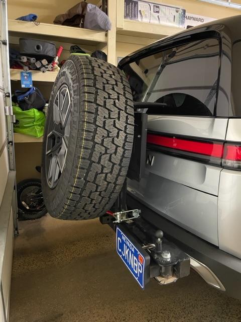

License plate attachment
Rivian R1T R1S Rigid Armor hitch spare tire carrier for R1S -- installed photos & review IMG_3829
Rigid Armor is based out of SoCal and they also have a “Swing down” version of the hitch spare carrier. Before finding this used one, I sent R1S measurements to the manufacturer and they said the stock Tacoma swing down version would fit the R1S. If anyone is interested and lives close by, it would be interesting to bring an R1S to see if the Tacoma Swing Arm version fits as well. It might be better centered since it’s built for the wider Tacoma versus the Cross Trek version.
All in all I’m super happy with the purchase. If you can find a used one for a deal, go for it!

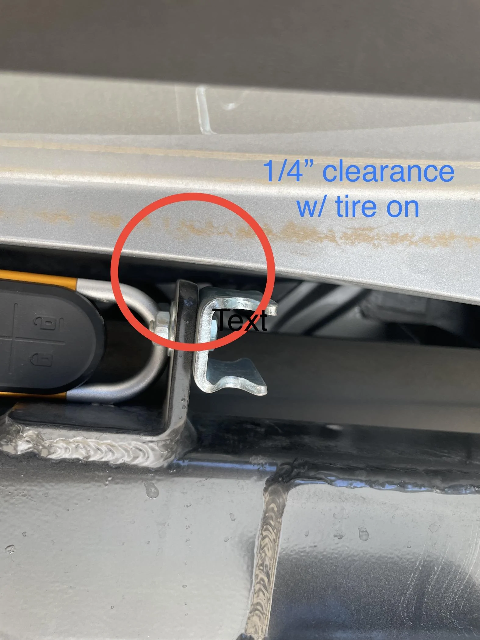

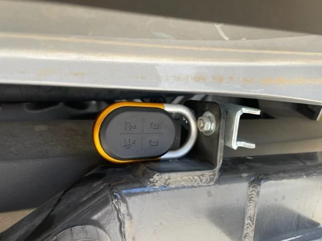

Do you need the spacer? It looks like the tire/wheel would fit without it and it would sit closer to the vehicle plus be less likely to move.
Also, does the lower tailgate clear the cross bar?
Rivian R1T R1S Rigid Armor hitch spare tire carrier for R1S -- installed photos & review IMG_3834
Rivian R1T R1S Rigid Armor hitch spare tire carrier for R1S -- installed photos & review IMG_3835

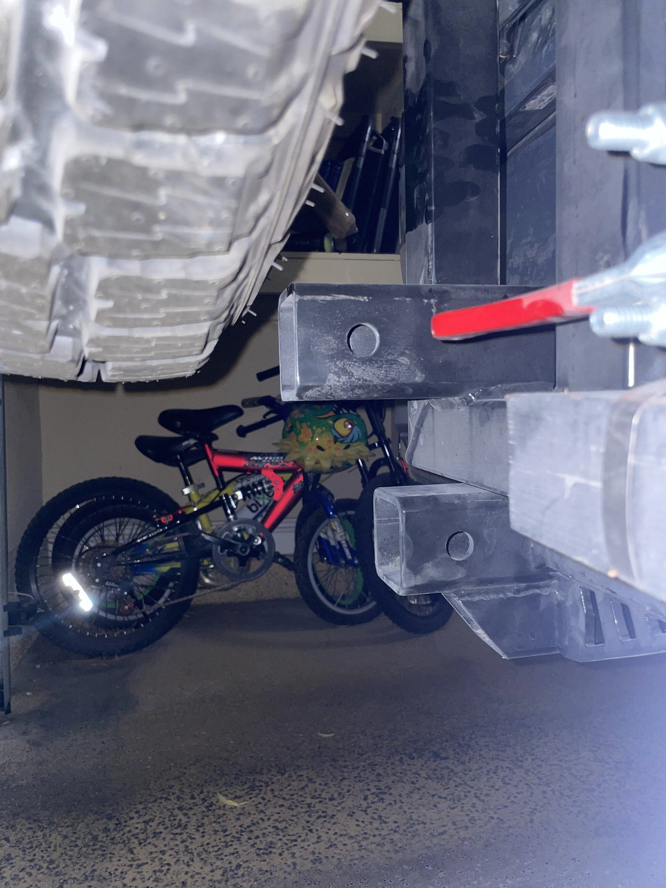

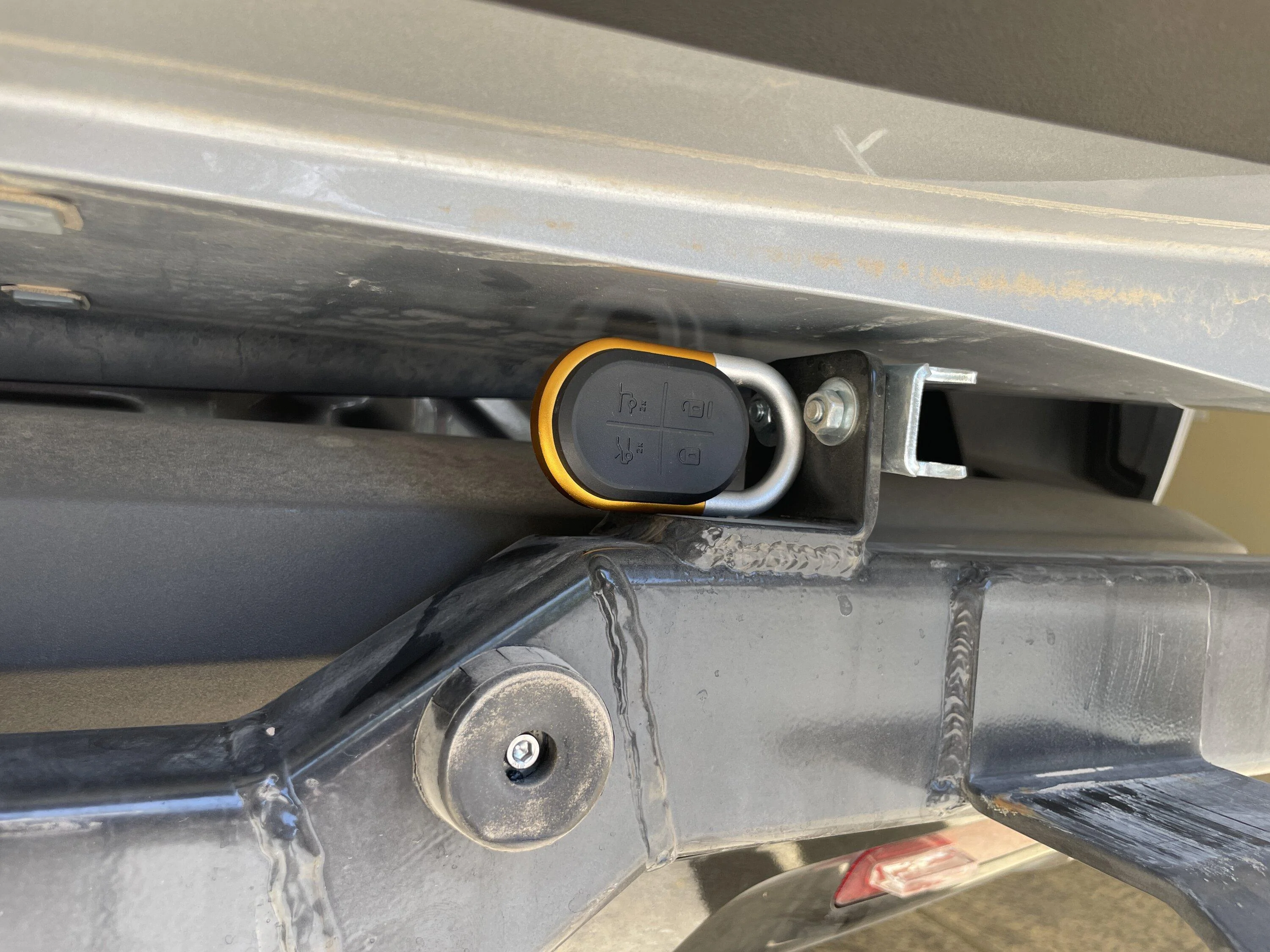

Definitely need spacer with Rivian offset. Maybe not with other aftermarket wheels. Hitch has two accessory 2” hitch tubes. The tire blocks the upper with a clearance of 1/2” on the diagonal. The lower hitch tube is still accessible for a hitch shackle.
Rivian R1T R1S Rigid Armor hitch spare tire carrier for R1S -- installed photos & review IMG_3839
Rivian R1T R1S Rigid Armor hitch spare tire carrier for R1S -- installed photos & review IMG_3838
Rivian R1T R1S Rigid Armor hitch spare tire carrier for R1S -- installed photos & review IMG_3837
Rivian R1T R1S Rigid Armor hitch spare tire carrier for R1S -- installed photos & review IMG_3840

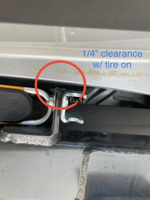

There is a locking latch point that sticks up from the hitch cross bar. With the wheel on, there is a 1/4” clearance. I haven’t measured with the wheel off, but I recall the clearance is slightly less without the wheel. I have a little piece of foam I put over the latch point if I have to climb into the back just in case.

Ahh it won't fit because of the secondary hitch point, but at the same time you can't use the secondary swing out hitch point anyway.

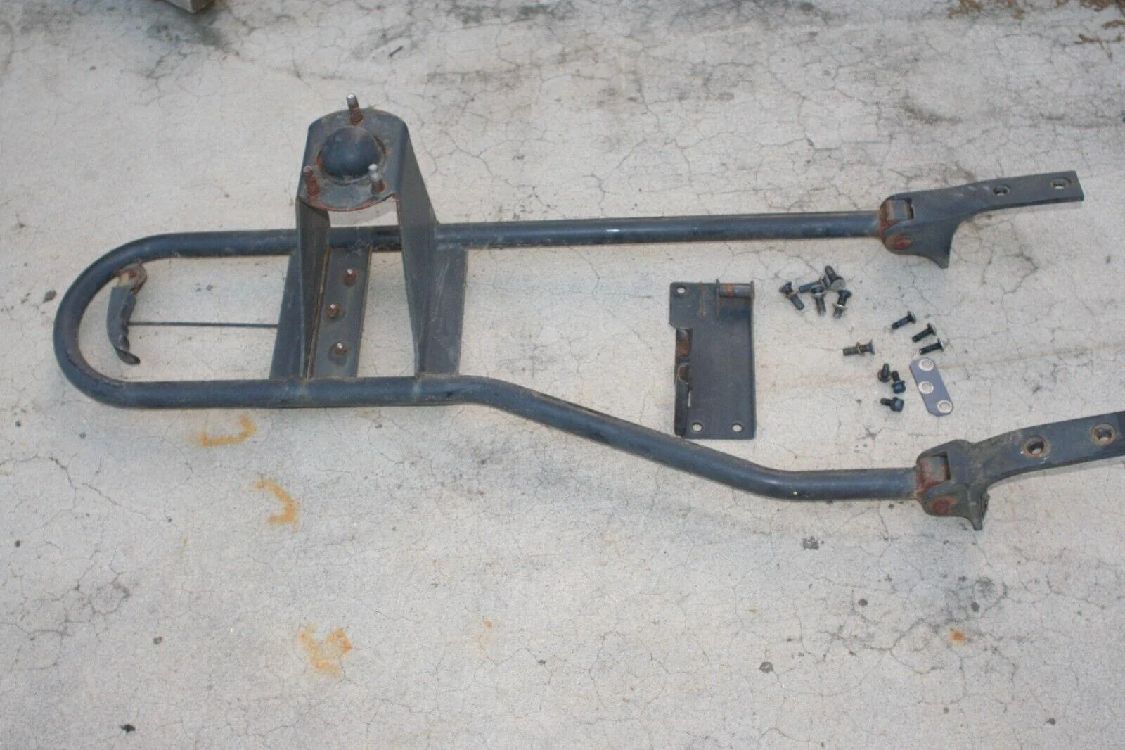

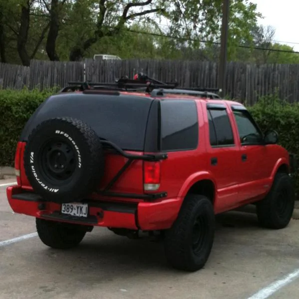

Personally I always thought the spare tire carrier on the last generation Chevy Blazers was the most ideal solution. Mounted to the body instead of putting all that weight on the hitch. And I like how easy it was to swing out of the way (with a handle). Wish they'd make something like this for Rivian, but I understand not a lot of people are going to want to bolt into their body this way. ?
