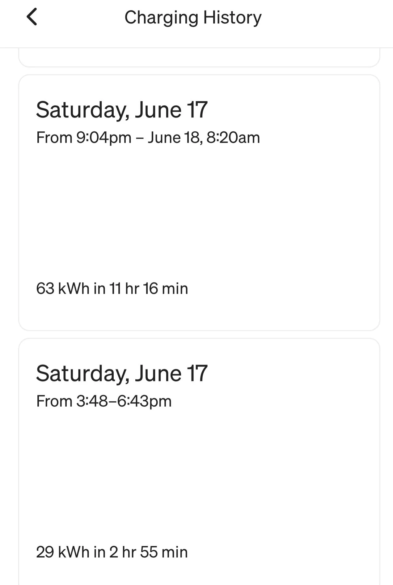

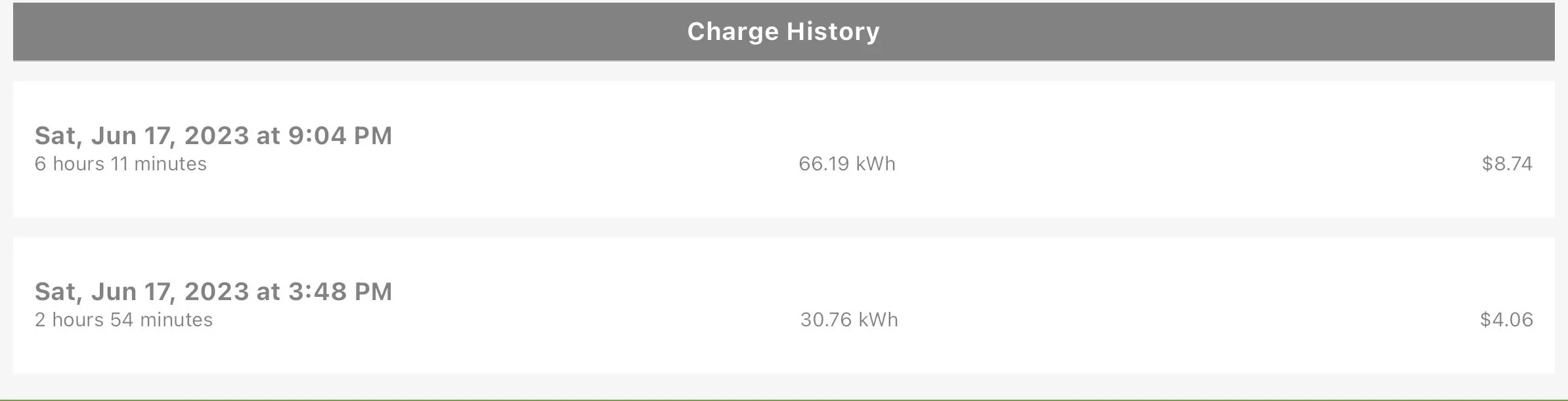

If you just monitor kW delivered to the vehicle from the chargers you should have both vampire drain as well as charging efficiency loss. The charger tells what it is sending not what the truck is accepting.
Here is an example from June 17th, you can see on the overnight charge I lost 3 kW in charging inefficiency Just under 5%.
Sent from my charger
Rivian R1T R1S NERD ALERT - Need some analysis review - Tracking my ROI one charge at a time IMG_3373
Received by the R1S
Rivian R1T R1S NERD ALERT - Need some analysis review - Tracking my ROI one charge at a time IMG_9122
