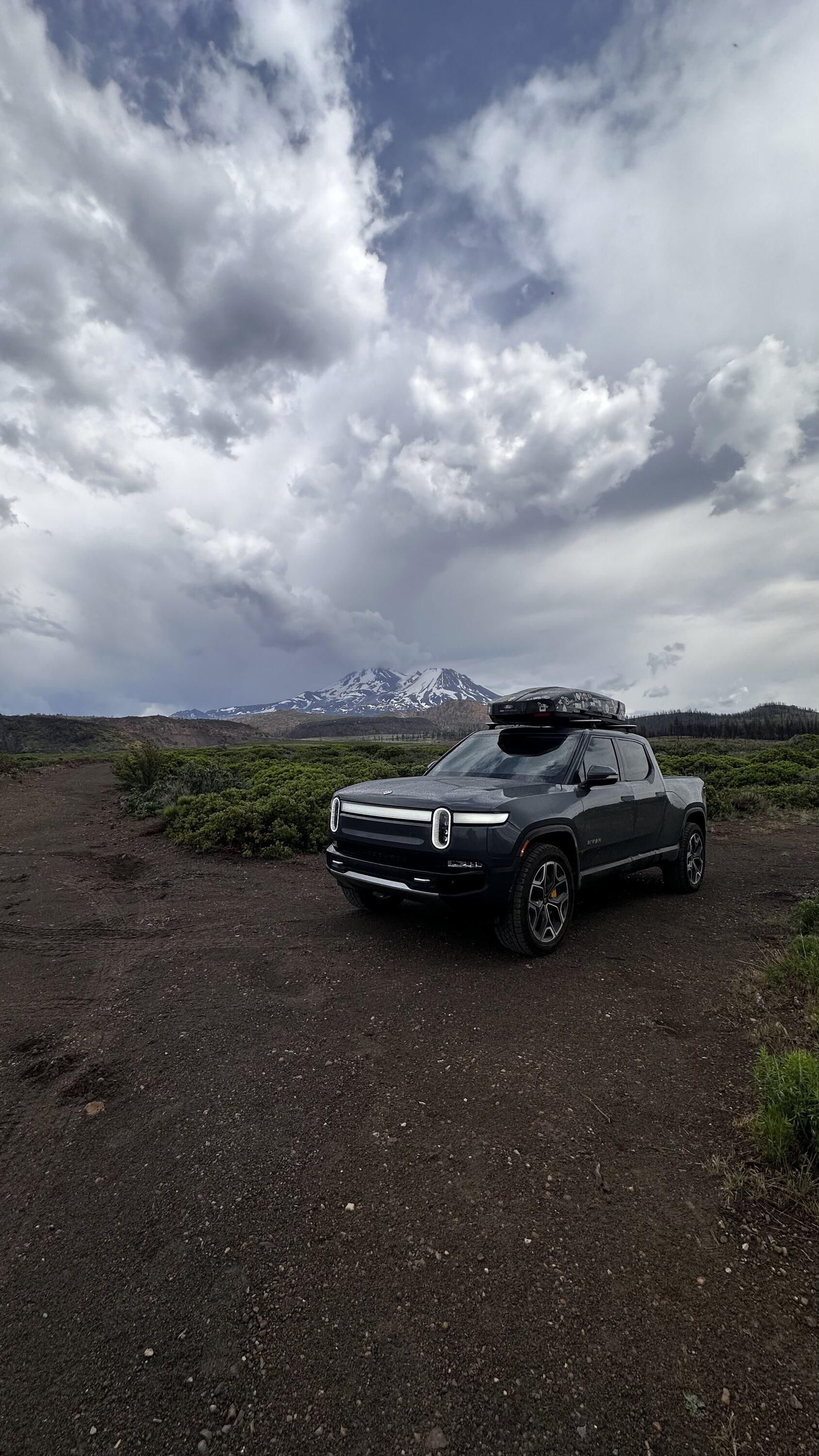

I did about 2500 miles with a Thule Motion XT XL “range robber” over the cab of my R1T: Bend, OR to San Diego area, around SoCal then back to Bend. A lot of interstate and highway miles, some local, tons of head and crosswinds, with too many variables to really assign efficiency hit to the box itself … but I’d estimate it’s more like 10%.
I think you’ll find, once you really get out and on the road, it’s worse than 3%. That stretch you tested on is a “better case” scenario, with speeds under 70 and a lot of regen opportunities. Get on the open interstate for a few hundred miles, where the electric motors are constantly pushing this brick with a box on top through the air, and you’ll see it dip.
Over the 3000 miles I drove (a few hundred with the box off) I saw 1.92 average. Again, lots of other variables and I was local for about 1000 of those miles (meaning more efficient driving scenarios, unloaded, box off, etc).
Rivian R1T R1S Roof box carrier range efficiency on R1T (installed Thule Atlantis 1800 XT Roof Box) IMG_5679

I see these alot on different vehicles pretty sure it's hurts mileage at interstate speeds but probably not as much on lower speed roads. Interstate purpose wouldn't it be better if you find the I ones that fit on the trailer hitch (Aerodynamic). Easier loading and unloading thinking. Although this does look sleek in a way but not aerodynamic.

Awesome photo ?
