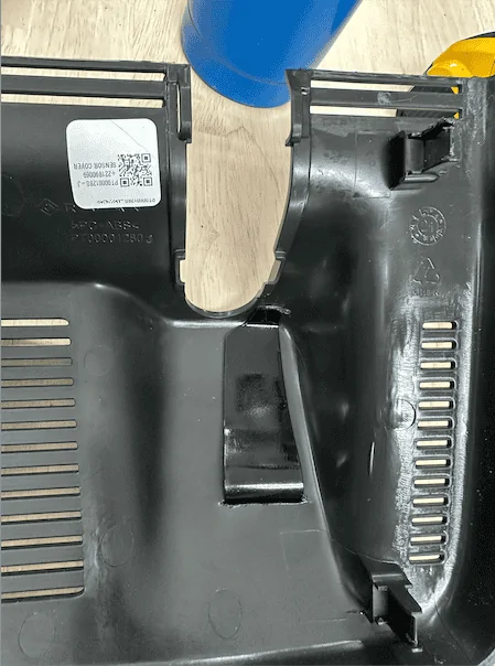

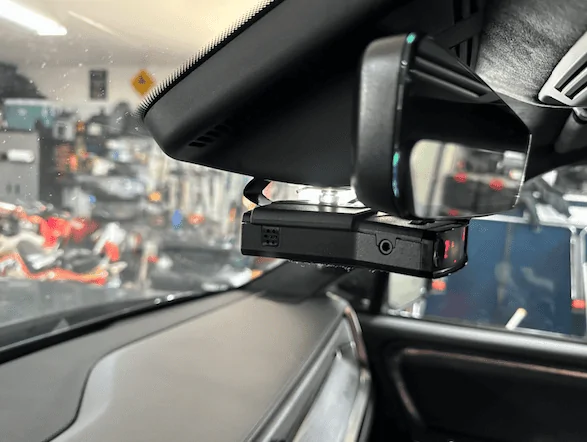

Finally relocated my Valentine radar detector from the dash to the mirror, using the original visor mount. Since the plastic cover had plenty of space, as well as there already being slits across parts of the cover, figured it wasn't going to be that noticeable if it didn't work out.
Here's the original mount:
Rivian R1T R1S Valentine Radar Detector Mount DIY Mod 1682193127025

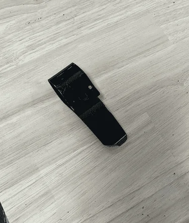

I separated the metal clip from the plastic, heated it up, reshaped it slightly, repeated a few times until it matched the profile of the bottom of the plastic cover, cut off a corner piece, and powdercoated it again to look like this:
Rivian R1T R1S Valentine Radar Detector Mount DIY Mod 1682193292631
Rivian R1T R1S Valentine Radar Detector Mount DIY Mod 1682193444264

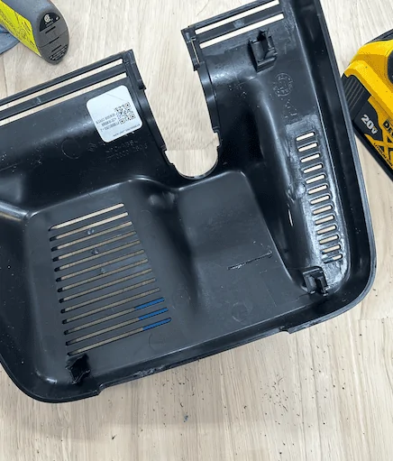

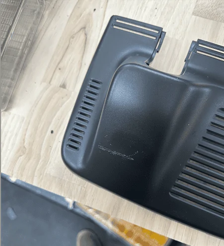

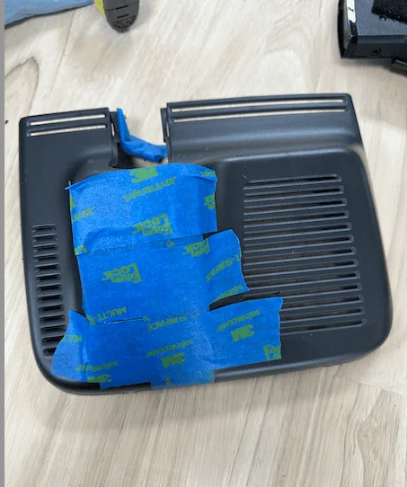

I then marked the plastic for where I wanted to cut a slit in the plastic, slightly back from where I formed it to the outside of the plastic, and taped it up to cut a slit:
Rivian R1T R1S Valentine Radar Detector Mount DIY Mod 1682193482864
Rivian R1T R1S Valentine Radar Detector Mount DIY Mod 1682193548001
Rivian R1T R1S Valentine Radar Detector Mount DIY Mod 1682193603763

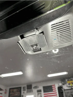

I then pushed/pulled the mount through, used a heated screwdriver to put a slit at the end, and pushed it down to hold it in place:
Rivian R1T R1S Valentine Radar Detector Mount DIY Mod 1682193713438

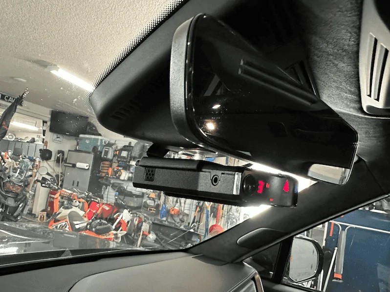

Remounted everything... where you can now see it has upward pressure on the front similar to how it was to hold onto a visor:
Rivian R1T R1S Valentine Radar Detector Mount DIY Mod 1682193966086

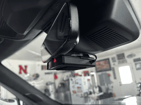

Then I just put an old suction cup upside down to push the front down & away from the mirror/plastic, and viola, it's solid and just low enough to where I wanted it. You could also do this closer to the windshield, but I wanted to use the front of the clip to hold it down as an extra measure.
Rivian R1T R1S Valentine Radar Detector Mount DIY Mod 1682194252077
Rivian R1T R1S Valentine Radar Detector Mount DIY Mod 1682194267060
Rivian R1T R1S Valentine Radar Detector Mount DIY Mod 1682194286010
This is very solid, tucked close to the mirror, so I'm not worried about this bouncing or anything.

Looks like a clean install. Does the cover seem like it can easily support a radar detector?
I've either used Blendmounts for mounting under the mirror or clear 3M dual-lock directly to the windshield. The R1 seems to have almost no mirror post, which is probably why the Blendmount isn't available.
netcop007
netcop007
Apr 19, 2023
Larkspur, CO
2022 R1S
Business Owner
It definitely can support it… those 4 clips that hold it against the windshield are strong, and a real pain to pull off. It’s thick plastic as well.
