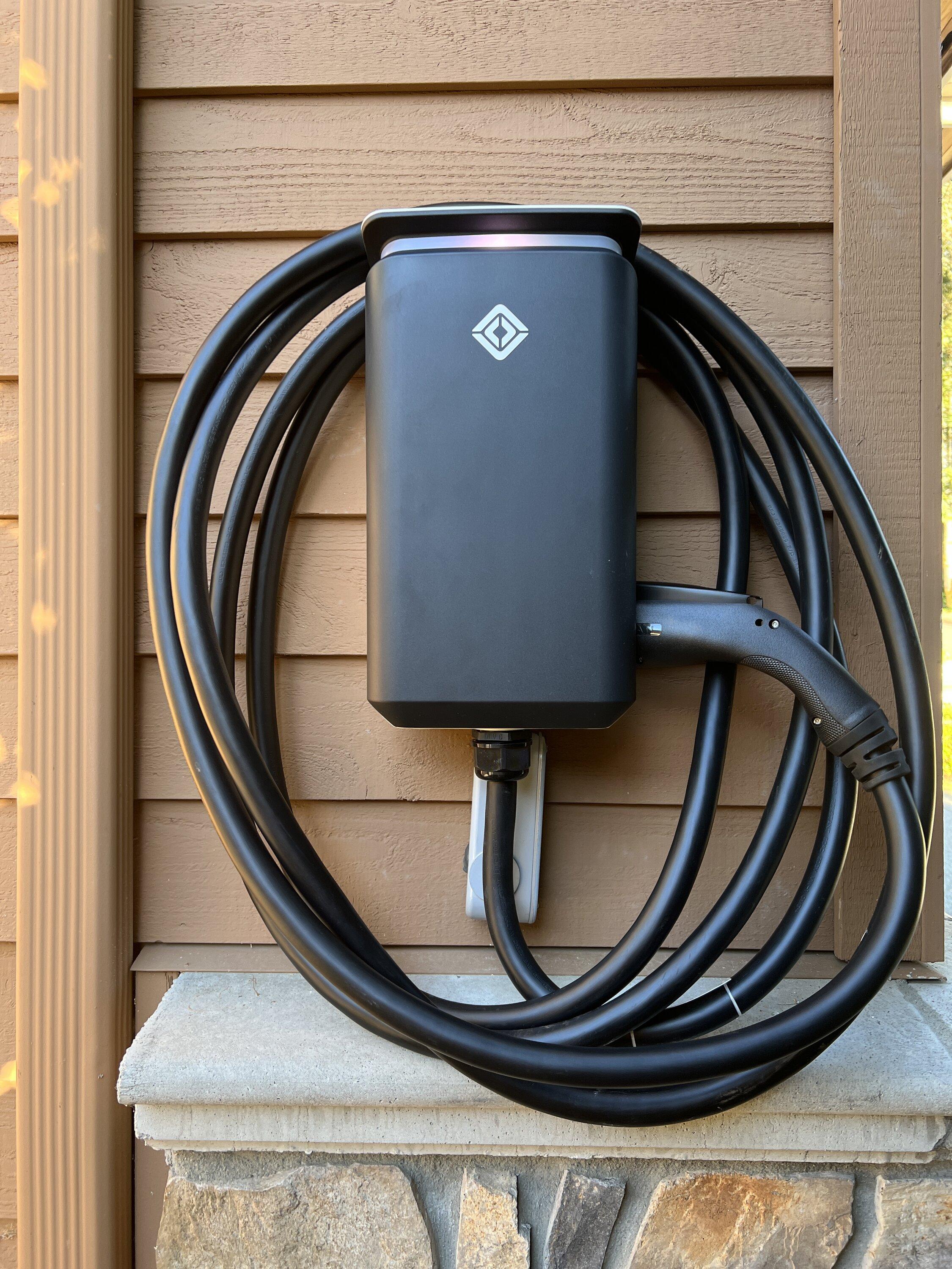

Installed the Rivian charger today, i noticed it could not find the Wi-Fi ssid of my Orbi router. After switching off 5ghz signal in Orbi wireless configuration, the charger could detect the Wi-Fi and finish the paring step without any issue. Turn the 5ghz back on, charger still connected.
If you run into Wi-Fi connecting issue, probably could try this.

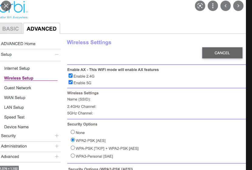

Where to you find that option? On the mobile app, or the web interface for the router or....

I'm using the web interface, under Advanced/Wireless Setup, looks like this

I agree, IF you have the option to suspend 5 ghz.
