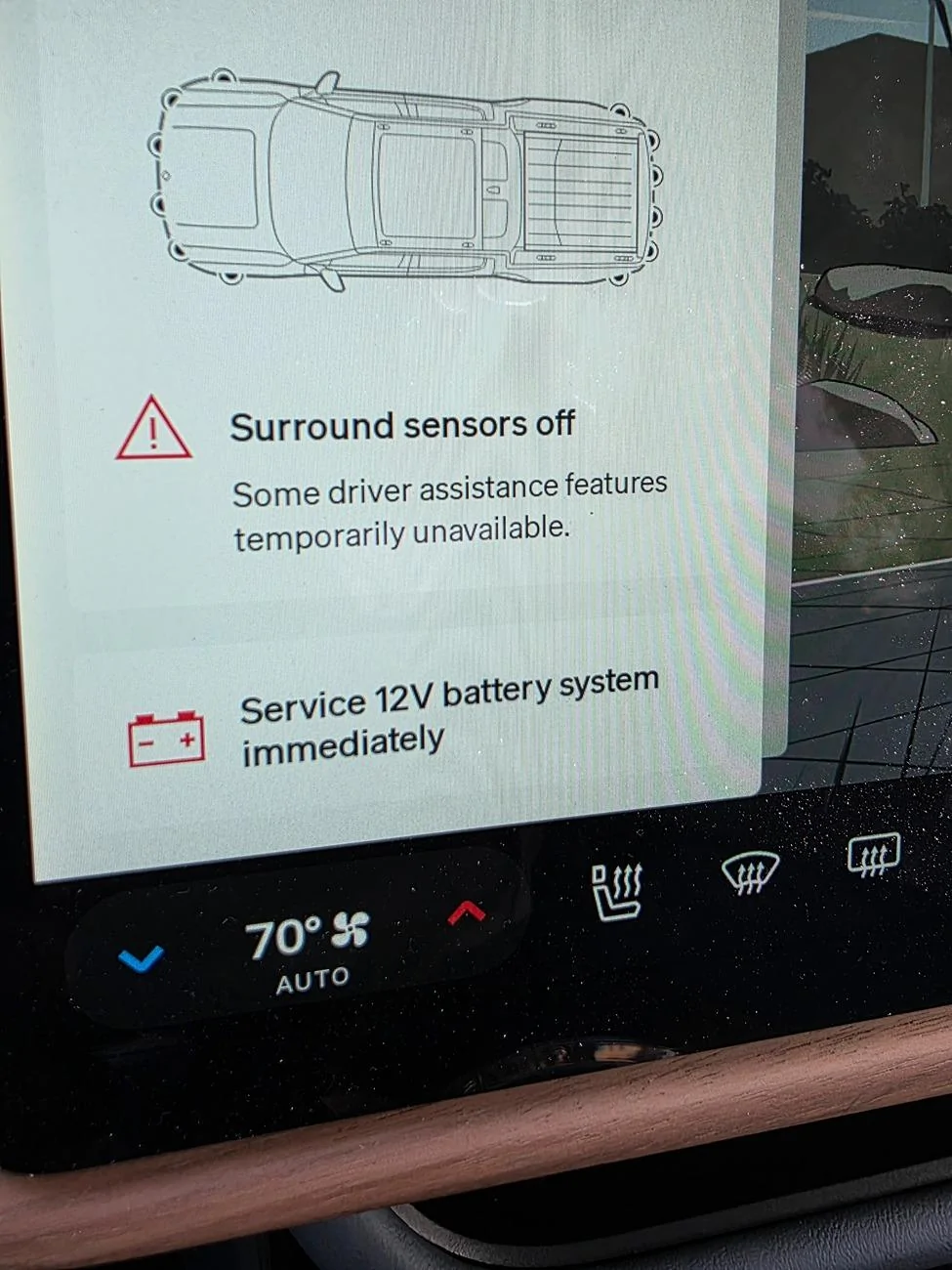

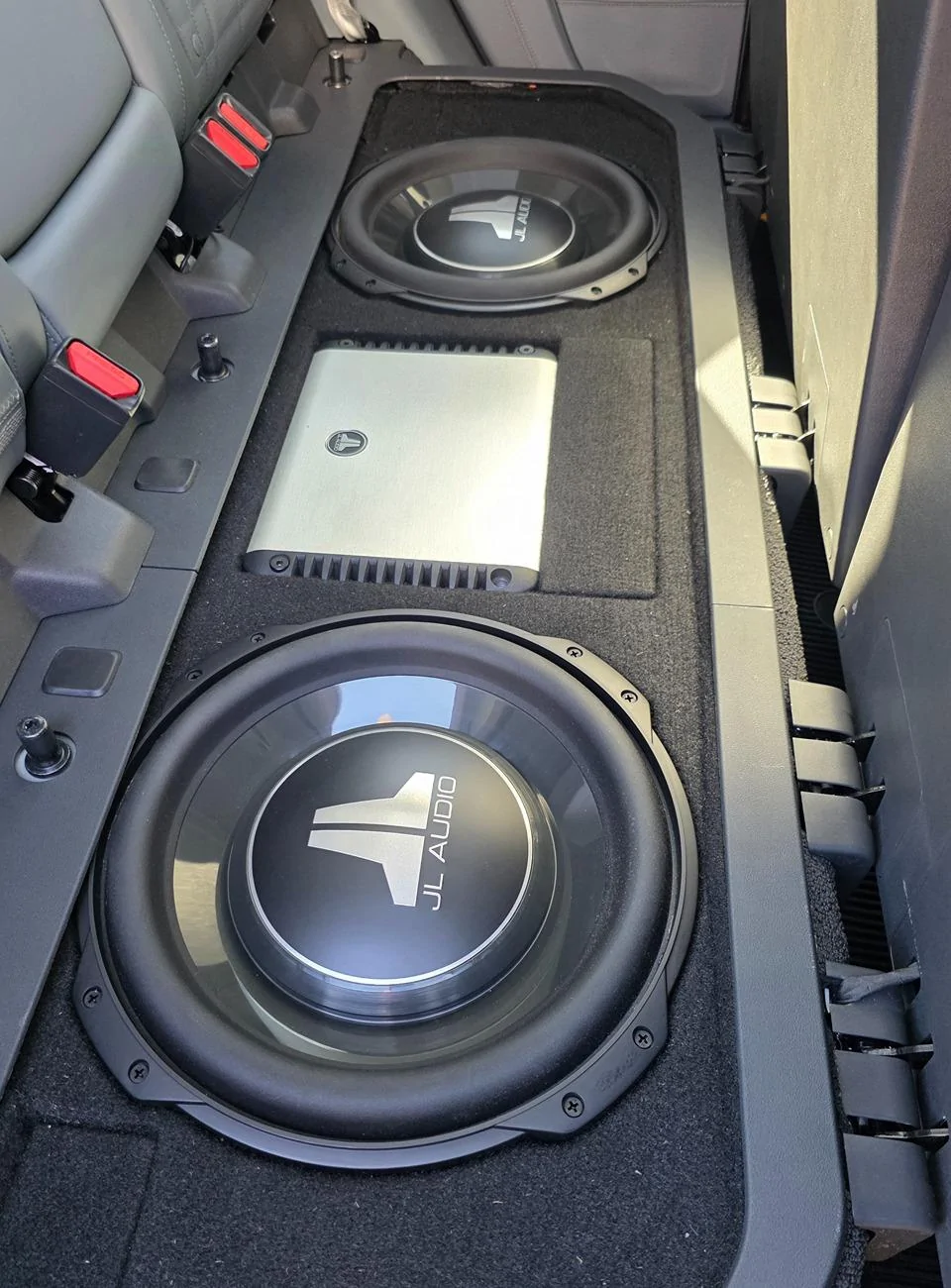

Did anyone ever crack this nut?
I'm looking to add a second 12V AGM battery on a 2025 R1T to run a 1200W amplifier and I was wondering if anyone was able to figure out the output specs on the 400VDC-12VDC converter.
Rivian R1T R1S 12V Questions 20250308_141043
The 2025 R1T has a single 12V 20Ah battery under the passenger seat and it's not nearly enough capacity to power the amp. First big bass drop triggered my 12V service warning immediately ?
Rivian R1T R1S 12V Questions 20250310_160725
The plan is to isolate the two batteries using a Victron Argofet Battery Isolator allowing the onboard DC-DC convertor to charge both batteries independently. From what I've read, there's very little voltage drop and should work perfectly if the DC-DC converter can handle the extra load.
https://www.victronenergy.com/battery-isolators-and-combiners/argo-fet-battery-isolators
Thoughts? ?

I'd think you might be able to get that setup working, I don't have much argofet experience but it appears to me that would involve changes to the Rivian stock 12v battery wiring.
I'd prefer to just have a 100ah Lifepo with a 200a BMS as the secondary battery power the Amp. Then the only connection between the systems is a DC-DC converter to only pull (not push) power from the Rivian 12v to the Lifepo/amp.
https://www.litime.com/products/12v-100ah-max-lithium-battery
https://www.victronenergy.com/dc-dc-converters/orion-xs-12-12-50a-dc-dc-battery-charger
MPFuini
Matt
Mar 11, 2025
San Diego, CA
2025 Rivian R1T Tri
It's funny you say that, because that's exactly the route I ended up going. I haven't been able to test it yet though, because the battery I got from Renogy ended up being defective, so I had to send it back. Here are the components I went with though.
REGO - 12V 104Ah Super Slim Solid State Battery
RENOGY 12V/24V IP67 50A DC-DC Battery Charger with MPPT - Renogy United States
I'm also going to add a 100W solar panel on the hood to keep things topped off and hopefully cut down on vampire drain.
Rivian Hood Solar – LensunSolar
Once I have everything installed and tested, I'll post pictures and comment on how it works.
