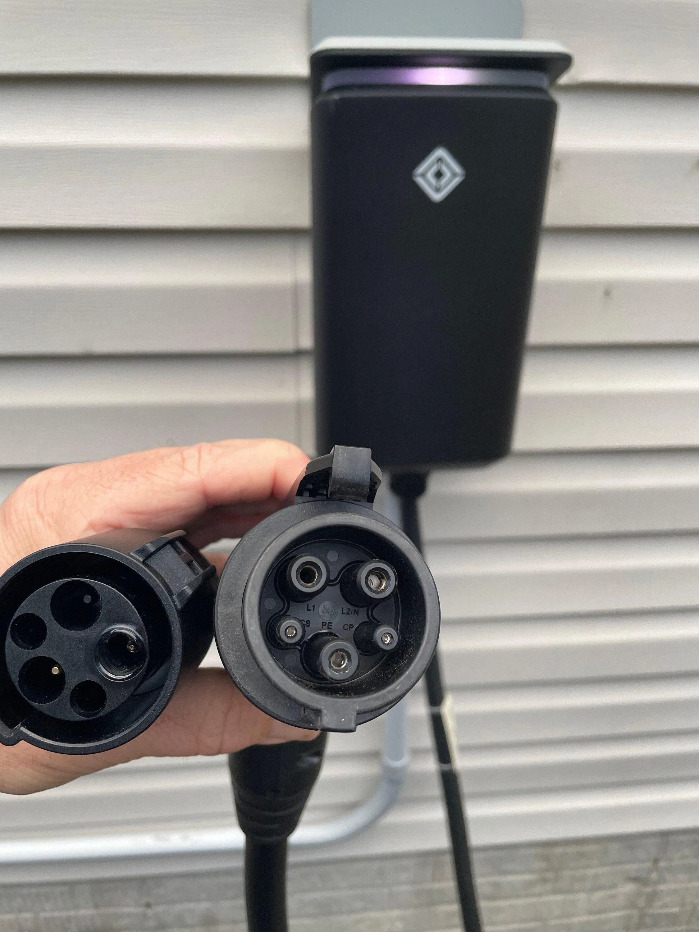

I managed to melt one of the pins in the Tesla adapter and the handle to my Rivian Wall Charger. I contacted service about buying either a new cord/handle or handle. My guide got back to me stating that they are currently not supplying individual parts to service the wall charger.
Rivian R1T R1S PSA!  Rivian doesn't recommend using a Tesla adapter with Rivian Wall Charger... it melted my pin IMG_4671

Which Tesla adapter did you use?
Oh wait, it would have been the one that comes with Teslas, doh.

That's skinks. I've had no issues using an adapter on my Tesla charger to charge multiple cars including my Rivian.
Good PSA. I do have the Rivian EVSE, but I use a separate Tesla Wall Connector for my Tesla.
It is interesting because that Tesla J1772 adapter has been around for like 10 years and I’ve never heard of anything like this happening. Were you charging at 48A?
Edit, not that it should matter, the website says the adapter is rated for 80A.
So, a simple bad batch error, or is the Rivian WC not using a fully standard charging handle?

Should have bought a Tesla wall connector and use tap for Rivian? That’s my plan.
I had two J1772 chargers set up. One for my wife's e-Tron GT and the Rivian for my R1T. I've since replaced one of them with a Gen3 Tesla wall Charger that I had from my previous Model Y.

Doesn't really make sense to me unless one was slightly faulty.
I would have thought so too. The Rivian Charger has had hundreds of hours of charging on the Rivian, e-Tron, and Bolt with no issues. Folks on Tesla forums have reported the same happening to them at J1772 chargers.
I'm a bit tired of EV manfs selling things with no service, no parts, slow or no repairs, slow or no collision parts …
