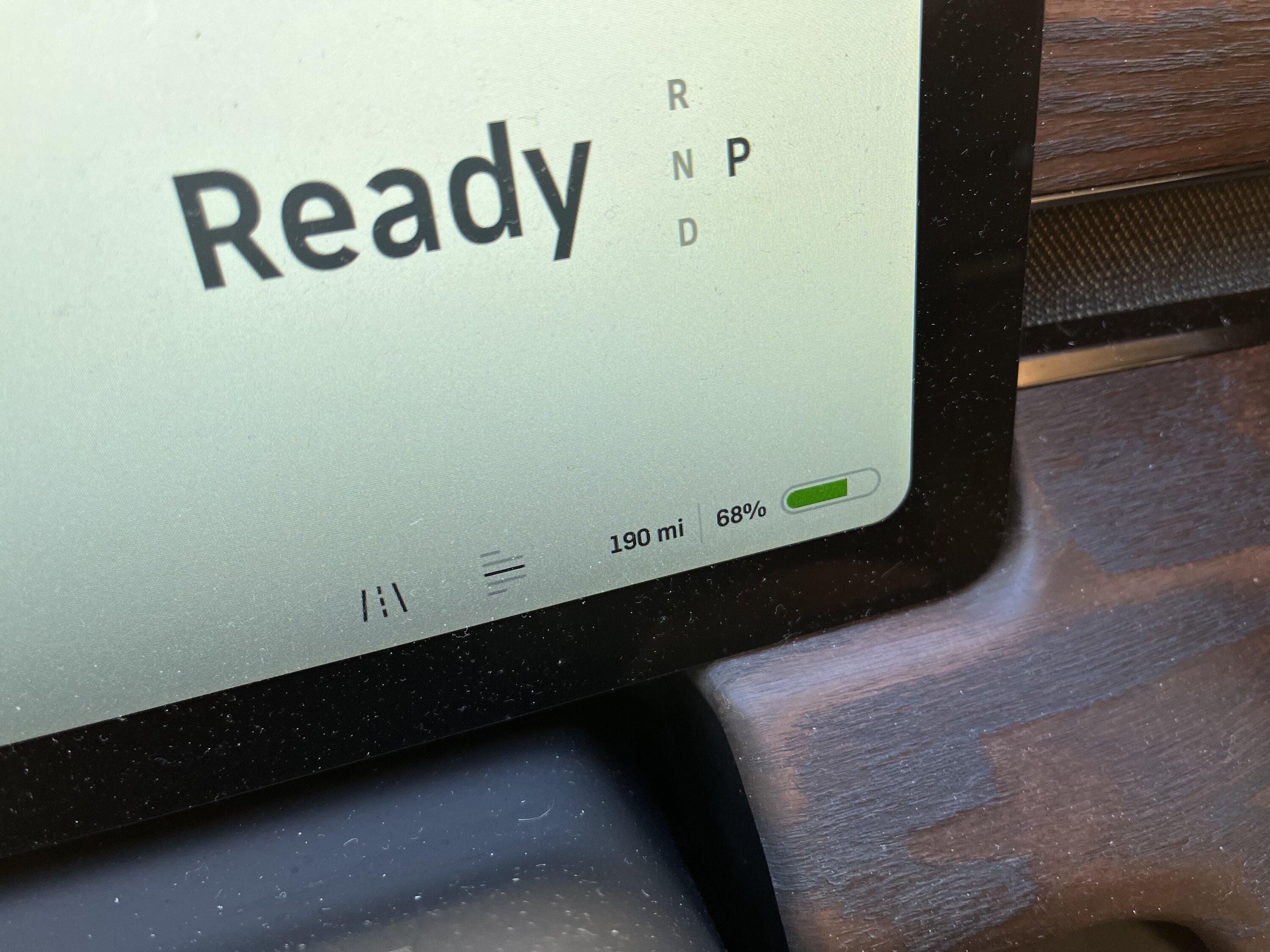

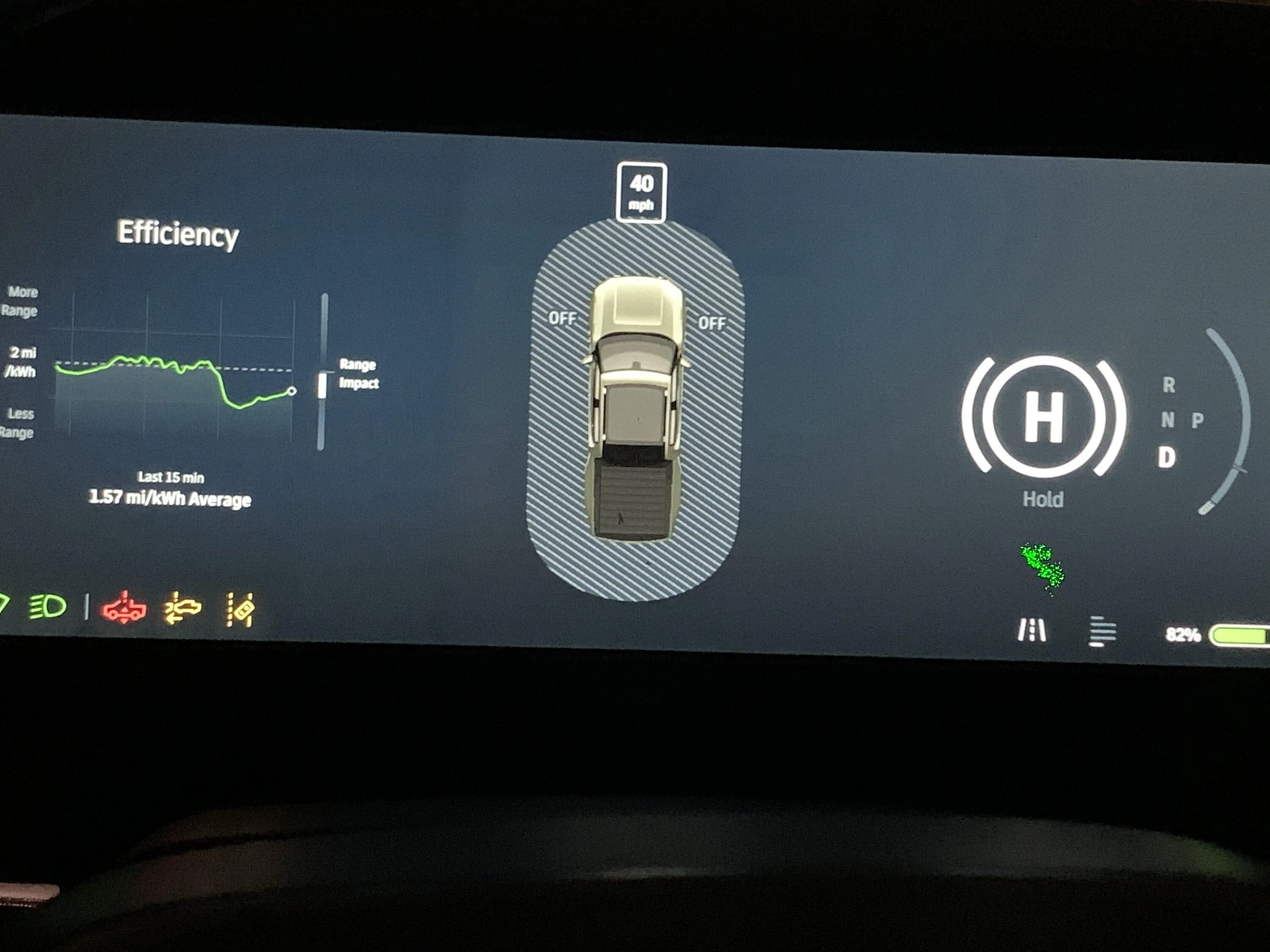

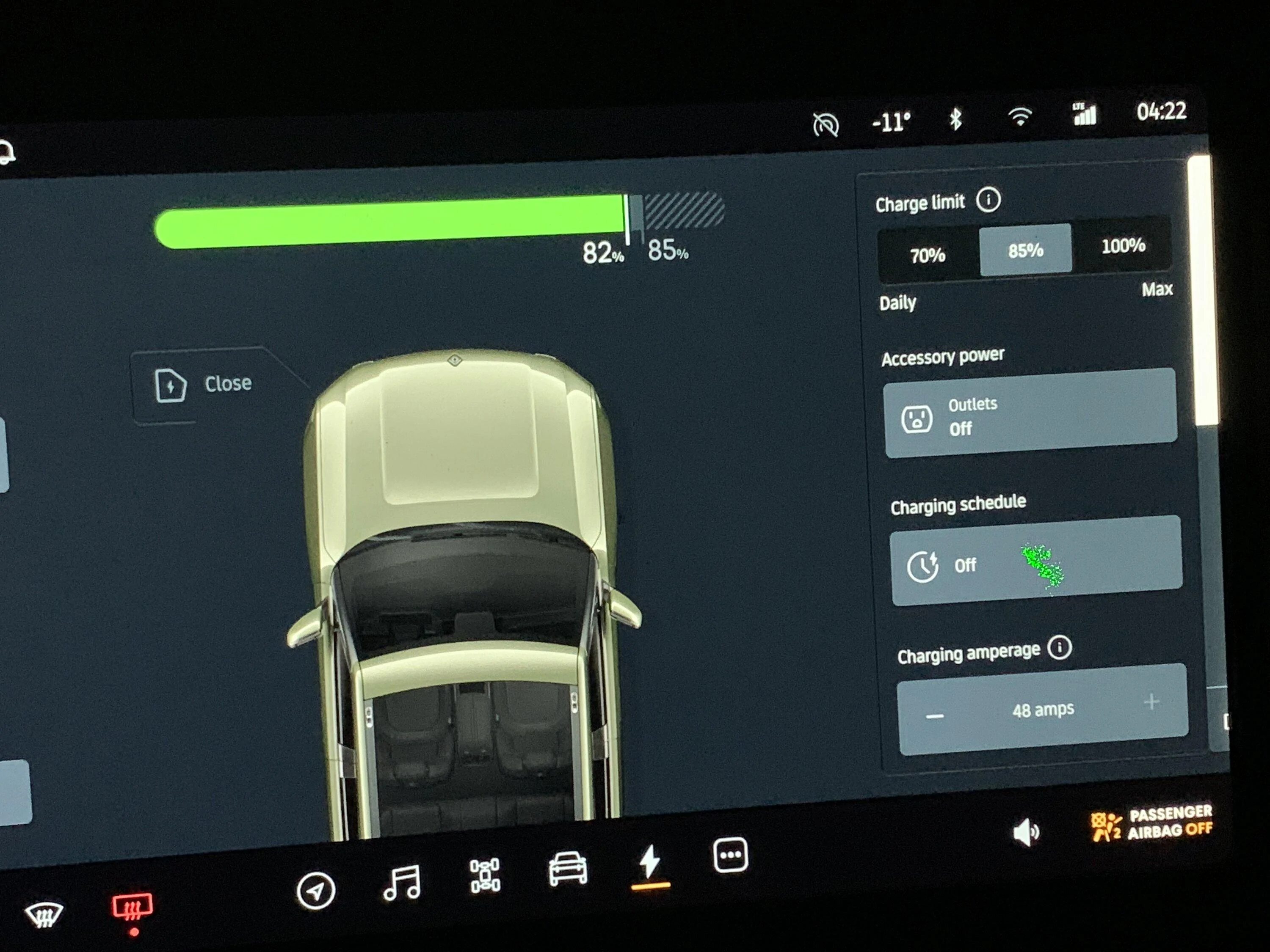

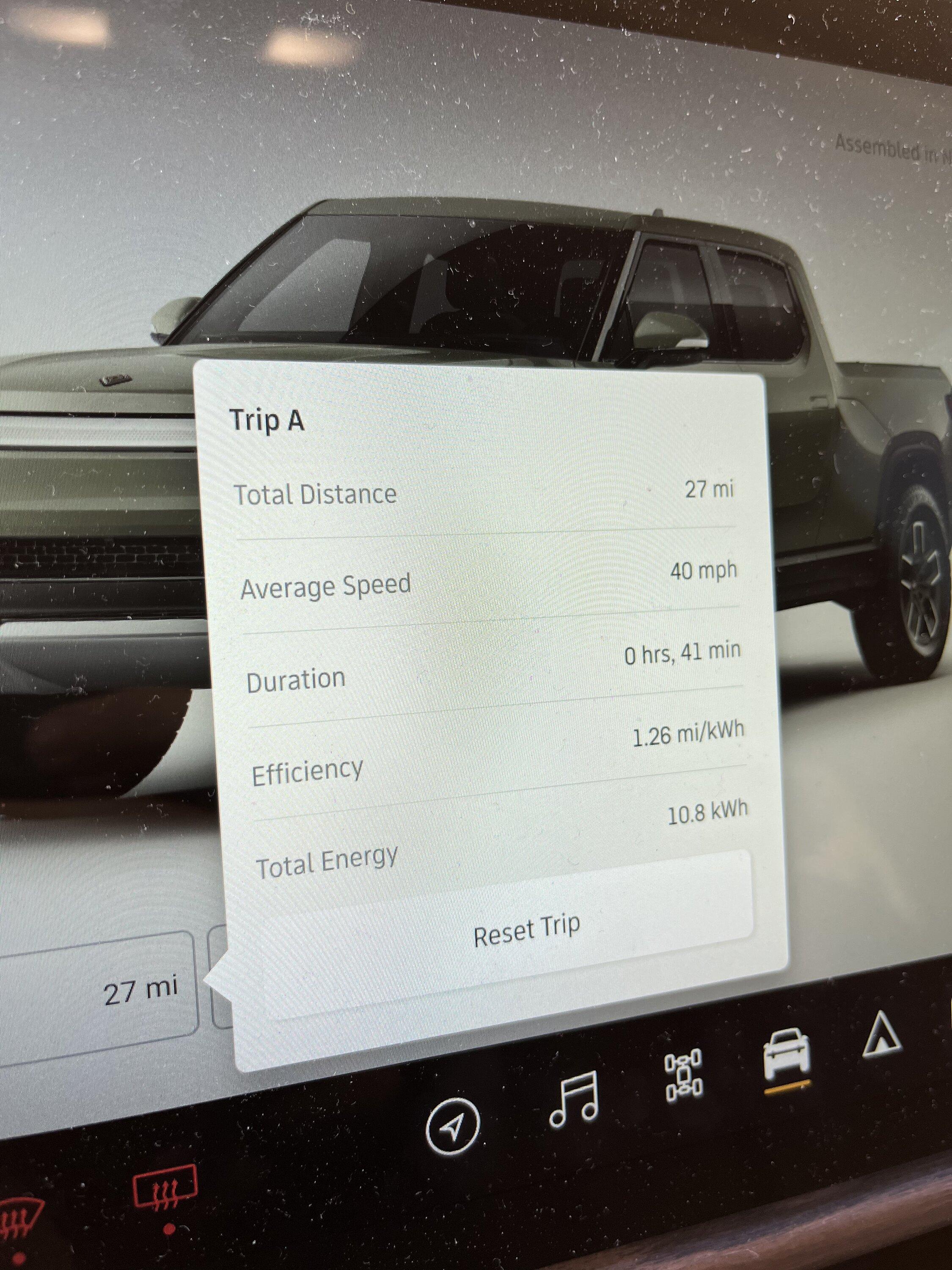

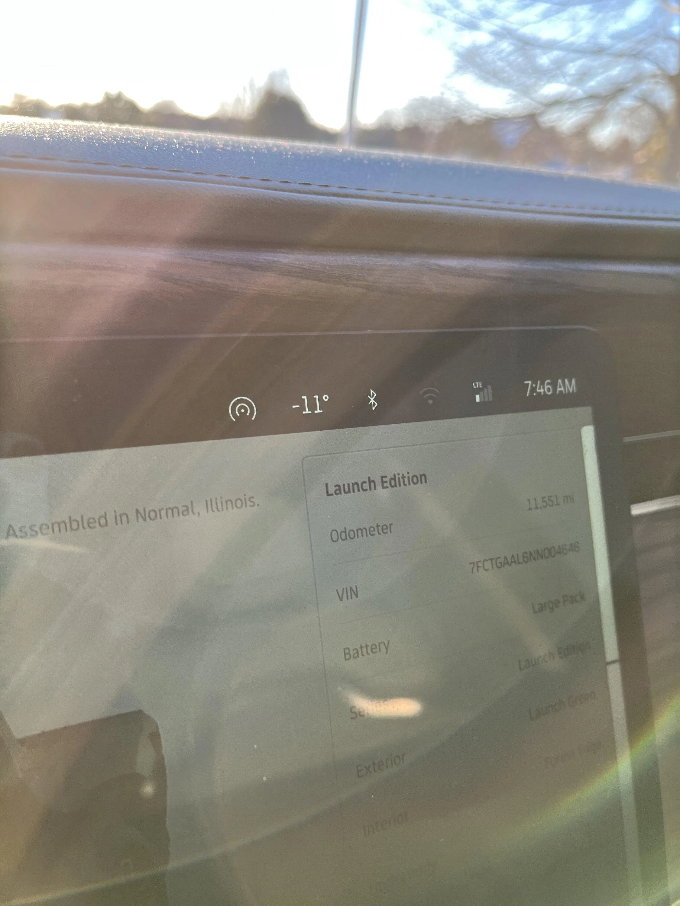

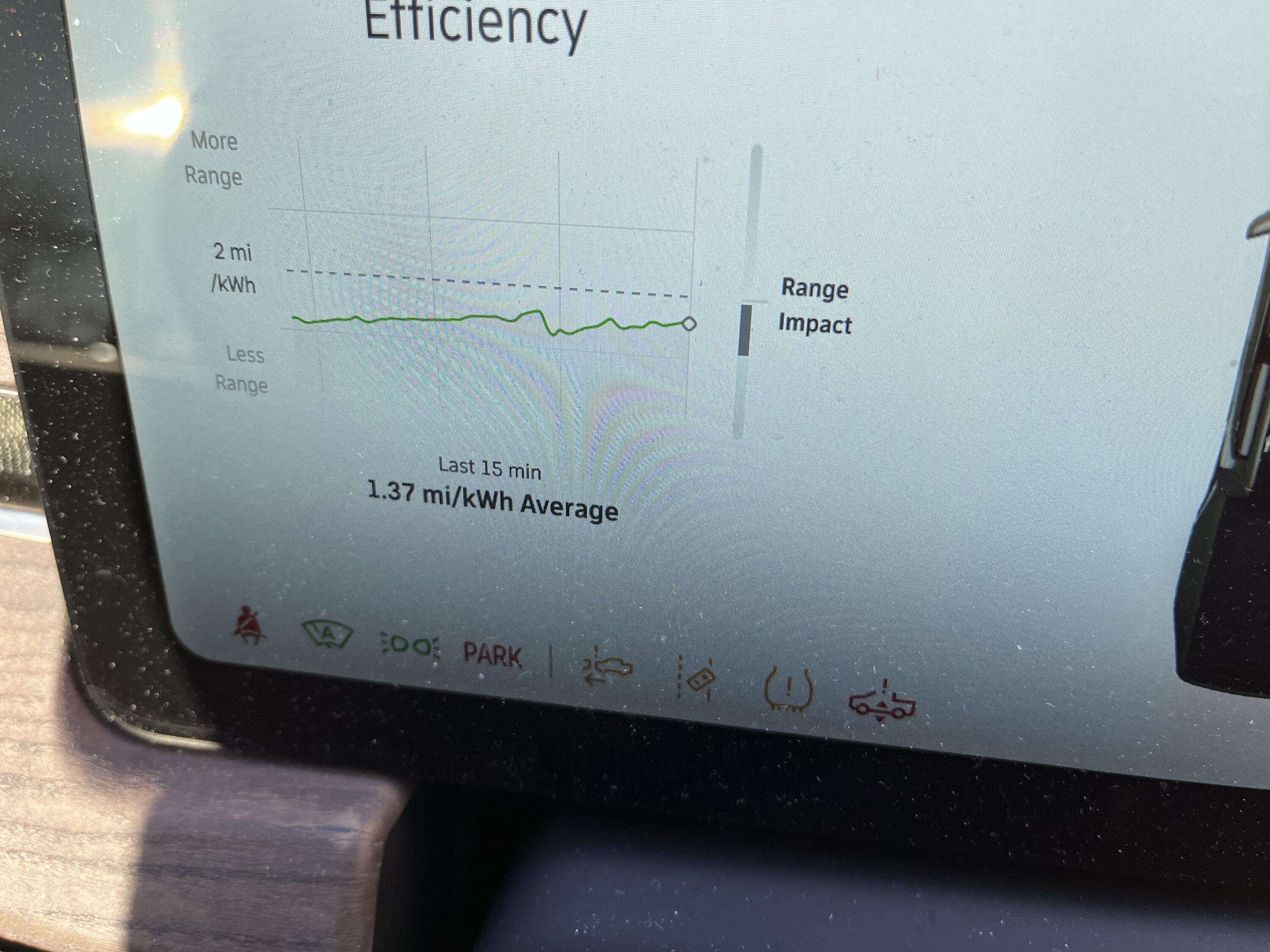

It was pretty cold here in Maine last night. We hit -19ºf at my house, and my R1T was plugged in outside. This morning, I decided to take it for a spin and see how it held up.
Stats:
  • Temperature was between -8ºf and -11ºf during my test run
  • Route was 27 miles, mostly flat, an combination of country roads and interstate
  • I preconditioned the cabin while plugged in before leaving. Started preconditioning 30 minutes before leaving to give things a chance to warm up.
Observations:
  • Starting battery level: 85%, ending level: 68%
  • Average consumption: 1.26mi/kWh
  • Cabin heater was unable to keep up with the cold. Cabin temp fluctuated from 55-60º (heat was set at 70º)
  • All proximity sensors failed and wouldn’t show up on screen (marked as unavailable)
  • Suspension showed an error and wouldn’t raise/lower, also wasn’t as smooth as usual over bumps
  • Power usage got better and better with time. My first few miles were sub-1mi/kWh.
If I needed to drive distance in sub-0º temps, I’d probably take an ICE vehicle. As long as the failed sensors/suspension start working again when it warms up (and I expect they will), then I’m perfectly happy with how the R1T did!

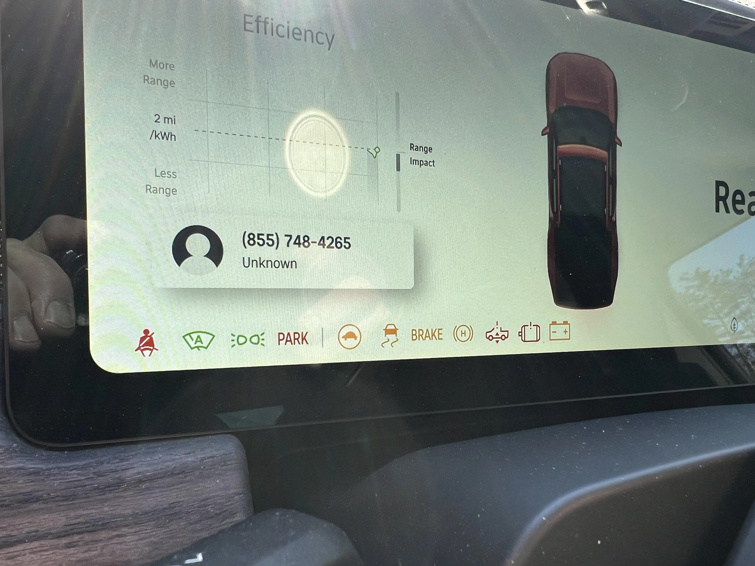

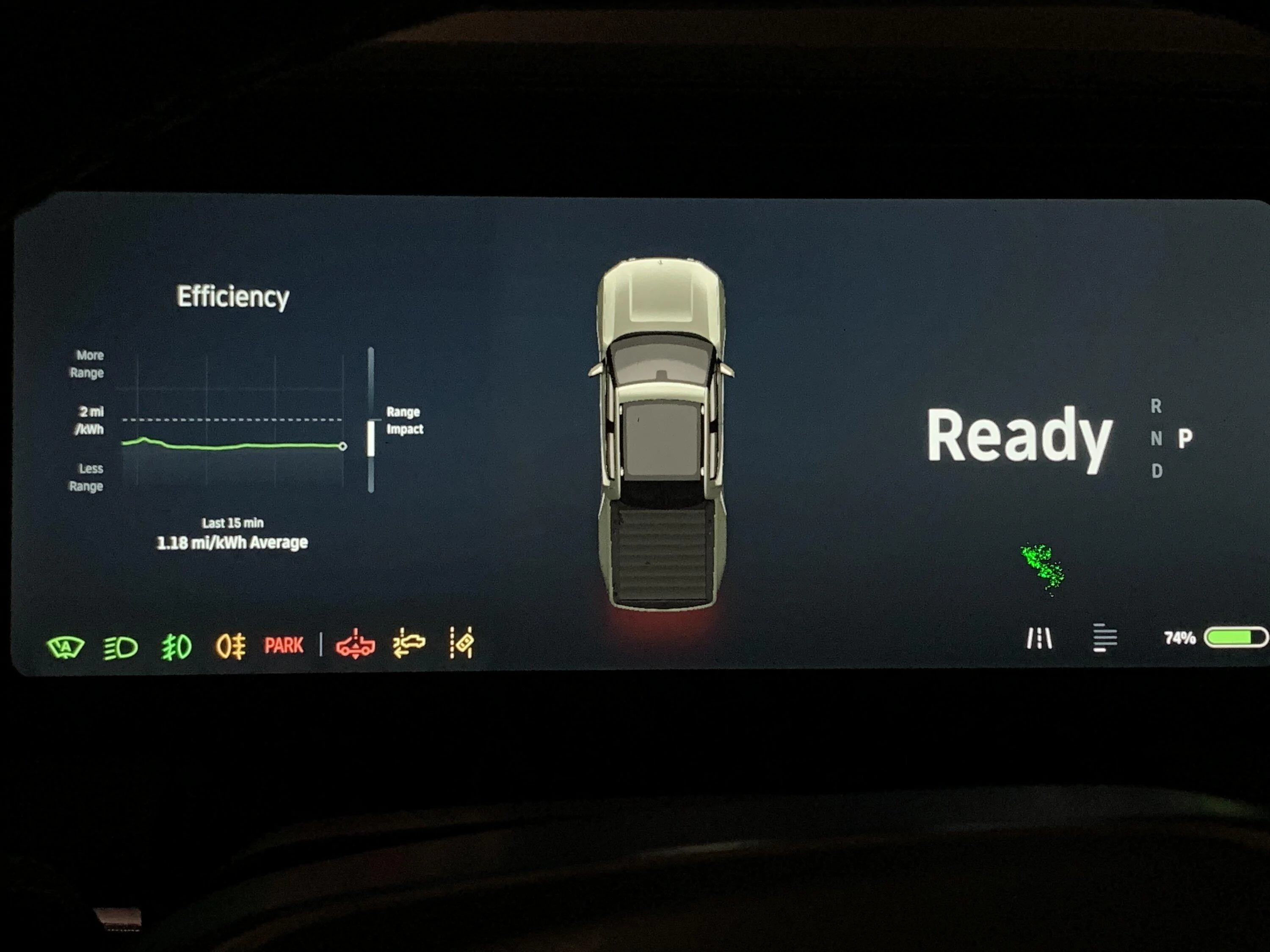

rivian1800
Apr 7, 2022
138
170
Nlg
Same issues here with temperature at-11 on late December. I keep it plugged overnight and I have no problem with during the day. I have to mention that one day I have 0.8 miles/KWh efficiency for first hour or so…

Follow up: it’s up to 8° outside now, so I got back in the truck, suspension height adjustments were working, but the sensor errors were still there. Did a hard reset, and now I’m all good, no errors or warnings.
