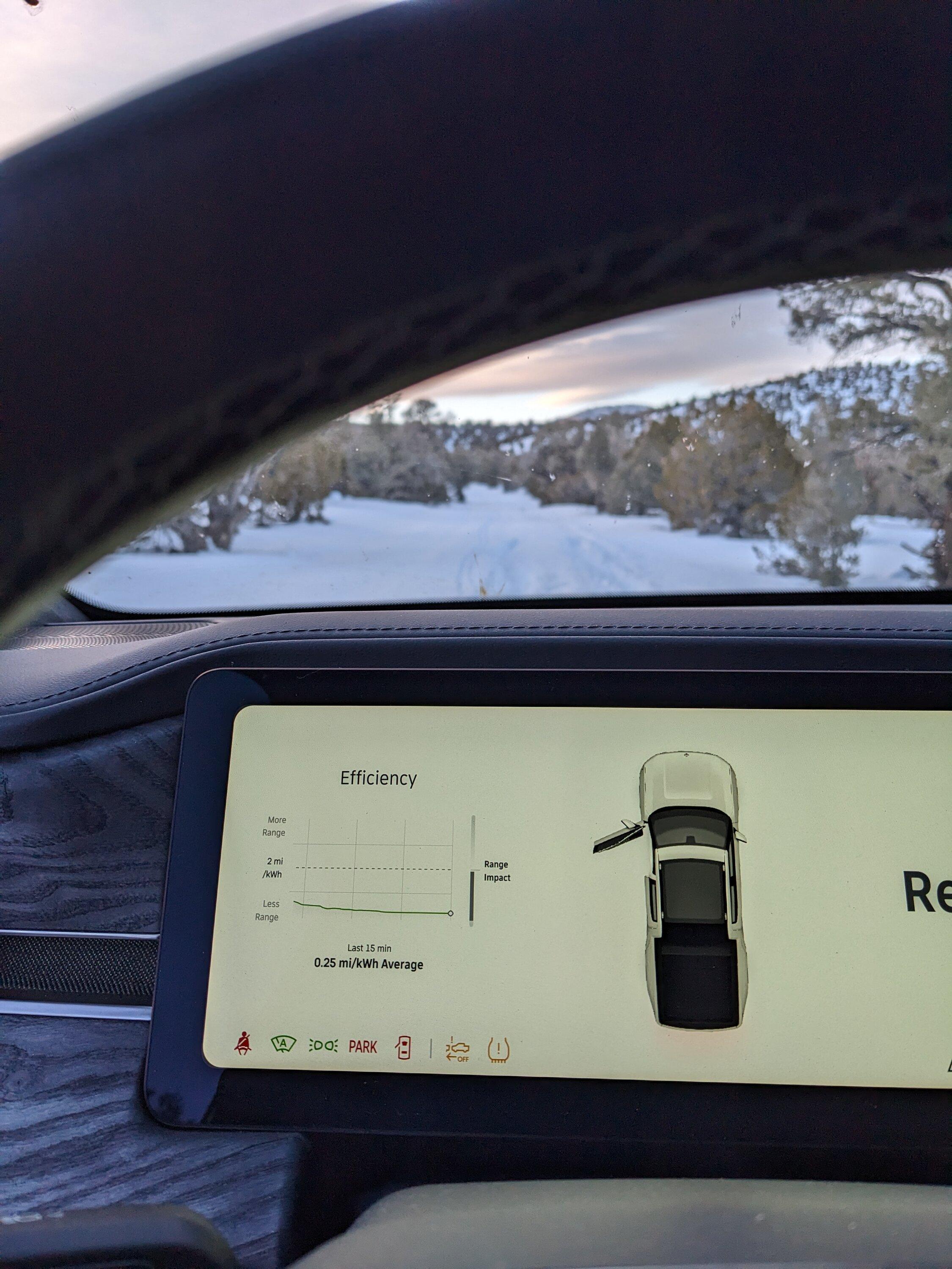

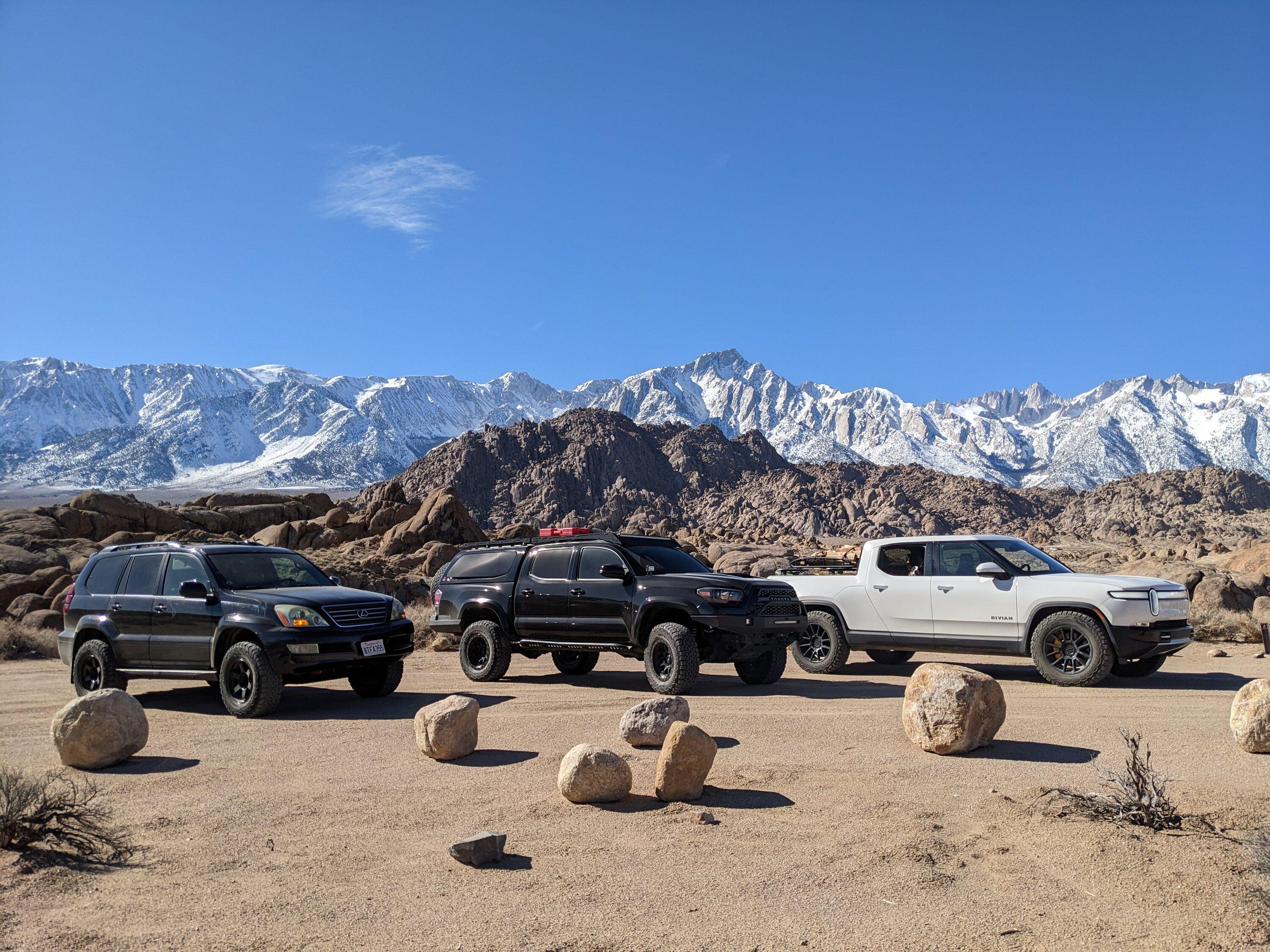

- In deep snow (~24-36"), it performed roughly similar to the GX470 and Tacoma, mostly because of it's weight. Despite having higher ground clearance and 35"s, it got stuck in the same places as the lighter vehicles with slightly smaller footprints.
- The parasitic drains overnight are unsettling when you're far from a charger, really sucks to see 3-4% disappear overnight, that's like 10 miles!
- Having a broken DC charging unit meant I could not use any type of charger except EA 150kw chargers, not even the RAN station in Bishop.
- The chonky 35" tires aired down offroad left me with an effective range from 97% charge of only ~250 miles.

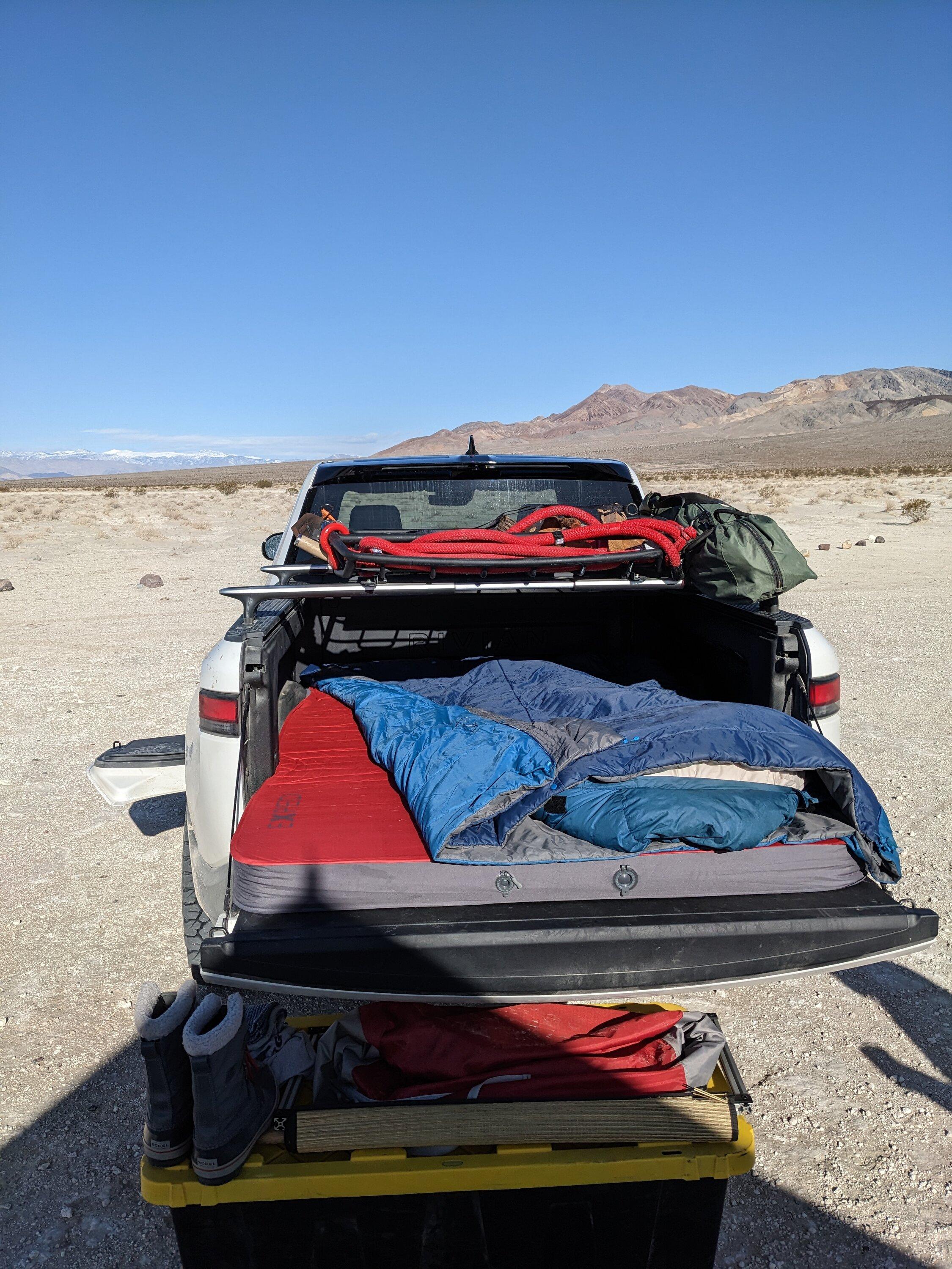

- Camp mode and leveling is amazing when you are sleeping on a mattress in the bed.

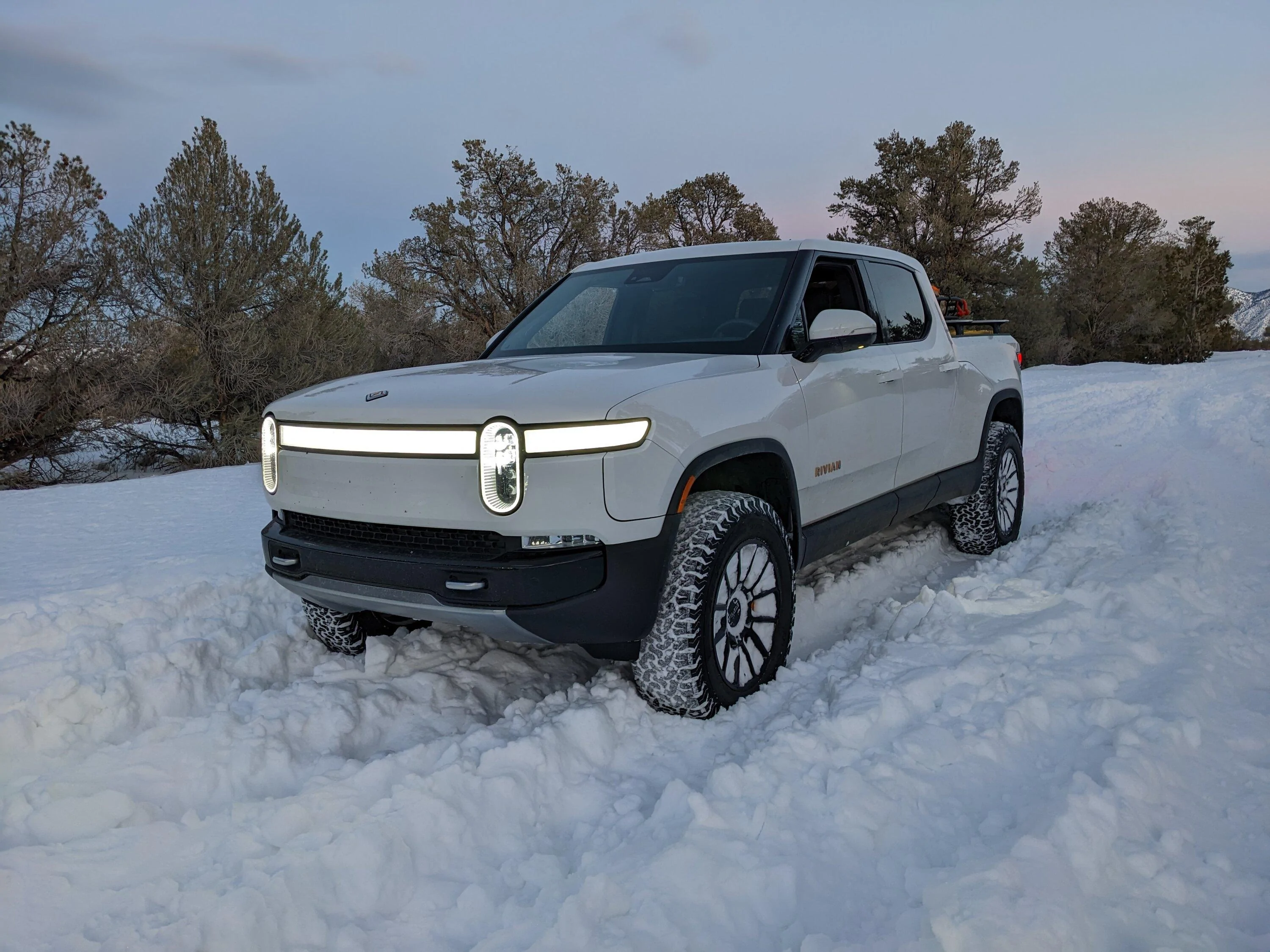

- if you high center in deep snow, you can lazy self-rescue by dropping to a lower ride height, compressing the snow you're high centered on, then return to higher ride height and roll away. I'm coining the term RiRi Squat right here for this maneuver.
Lessons learned:
- Deep snow is best tackled in offroad all-terrain with reduced traction control. It lets you get some spin without just digging in. Snow mode was too intrusive.

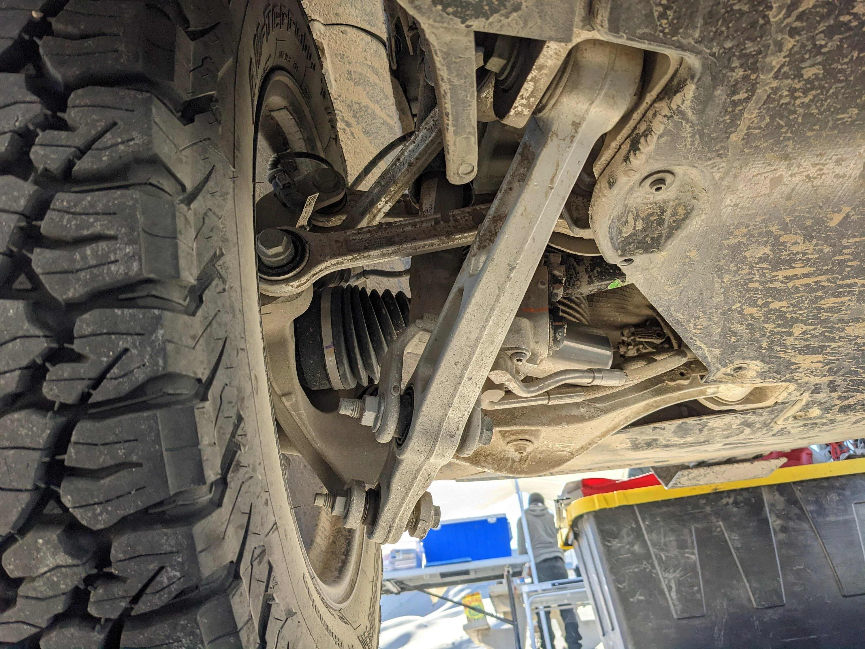

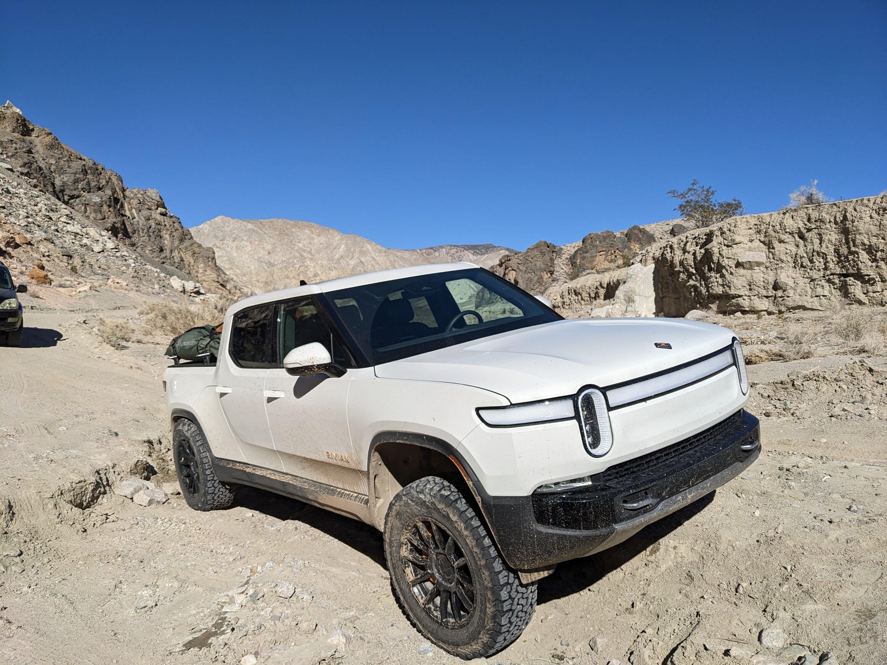

- The rear suspension needs rock guards or deflectors. On death valley washboard roads, the rear aluminum arms and shocks got absolutely blasted and damaged by the rocks kicked up.

- Exped MegaMat Duo 10 mattress fits in bed perfectly and is amazingly comfy. Pair it with their little electric widget pump and you're golden.
- Exped MegaSleep Duo 25/40 a warmer weather double bag, works great for my wife and I, I use a 2nd summer bag inside it if it's really cold (under 35F).

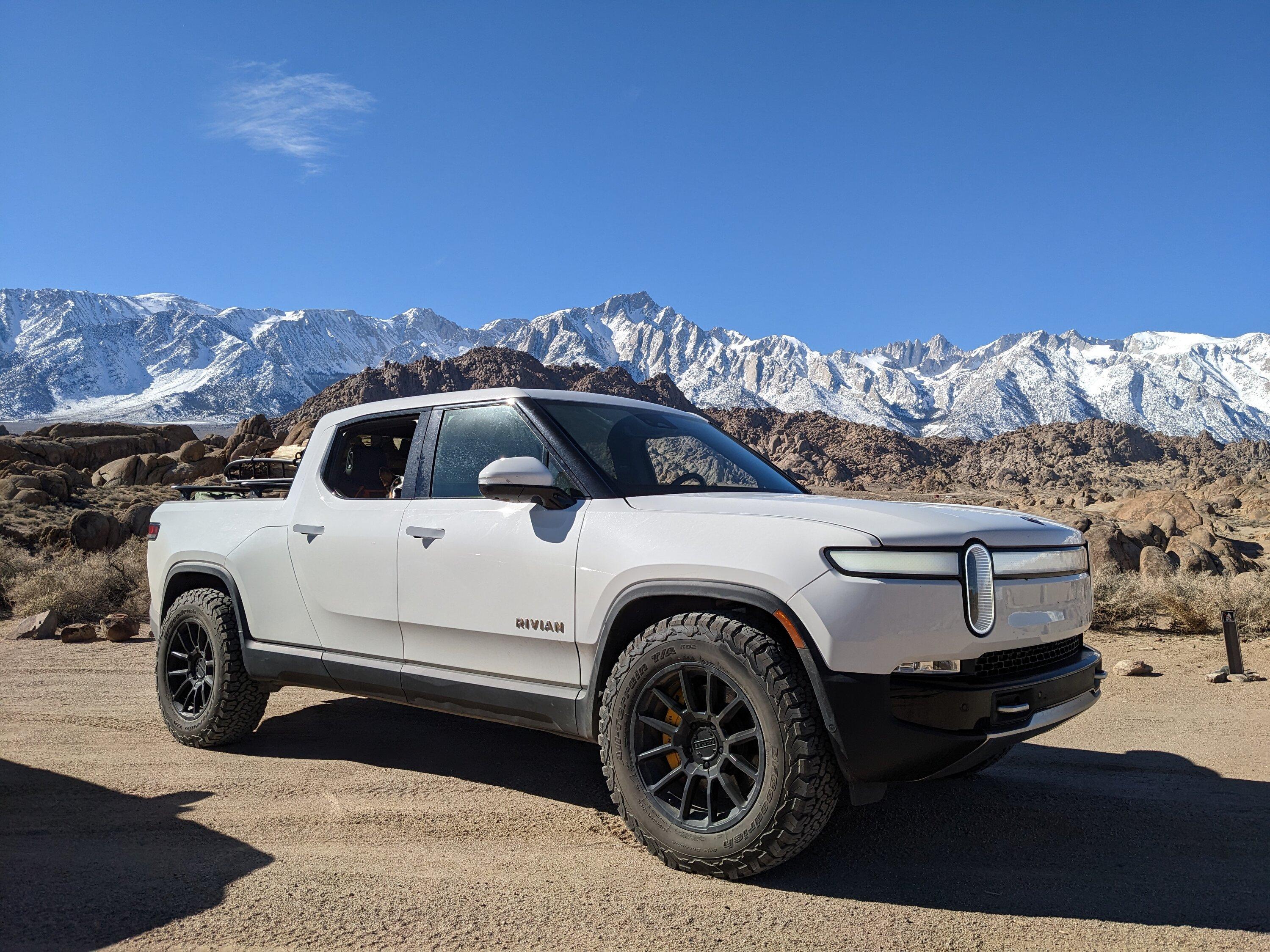

Great report! Can I ask about the rims & tires you have equipped? Those look awesome.

@ATX they are Raceline 950B 20x9 +18 offset wheels with 285/65R20 BFG K02 tires, pretty rough on efficiency but great tires and I like the stance they give, with not a terrible amount of rubbing in low.
