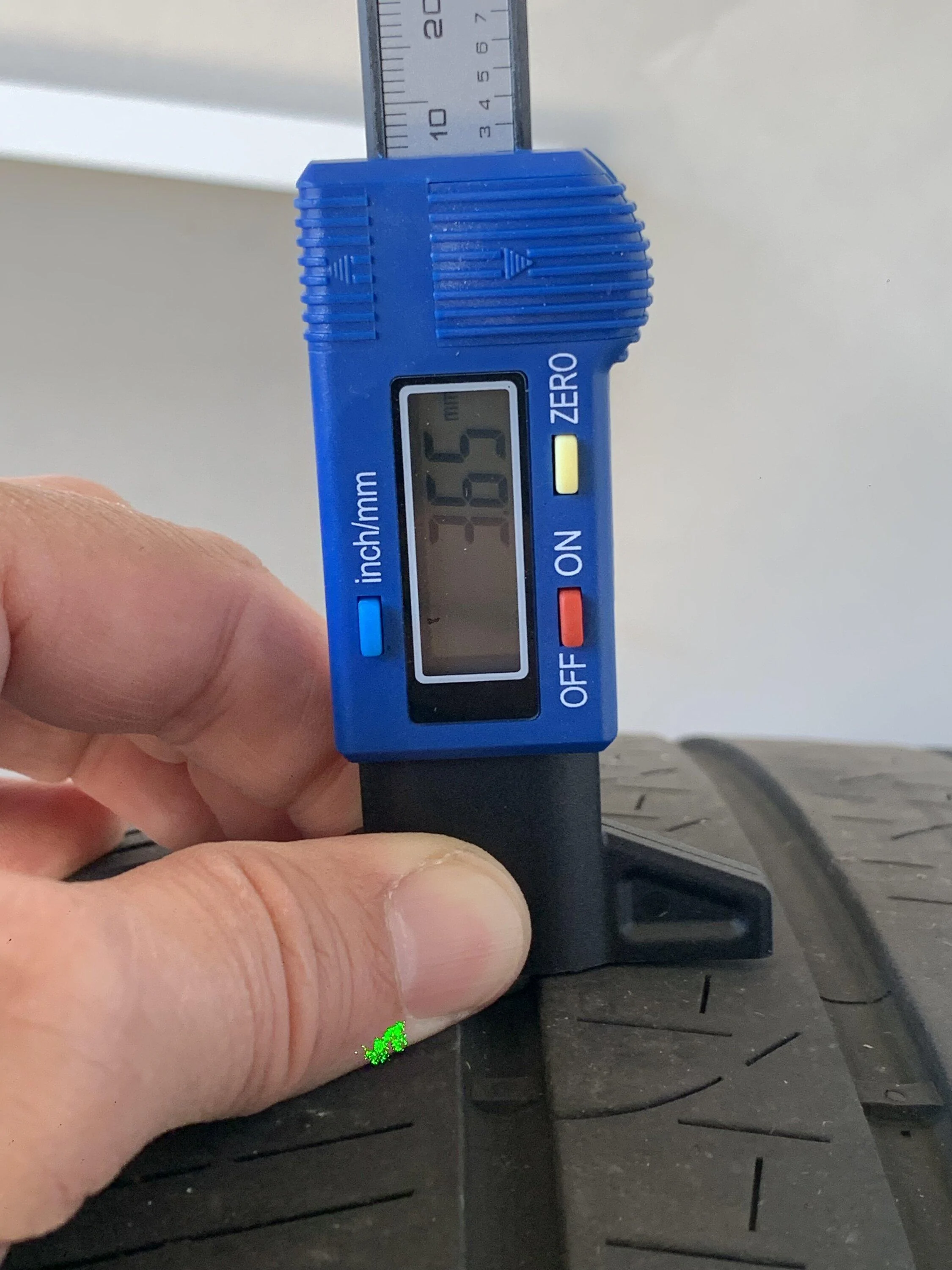

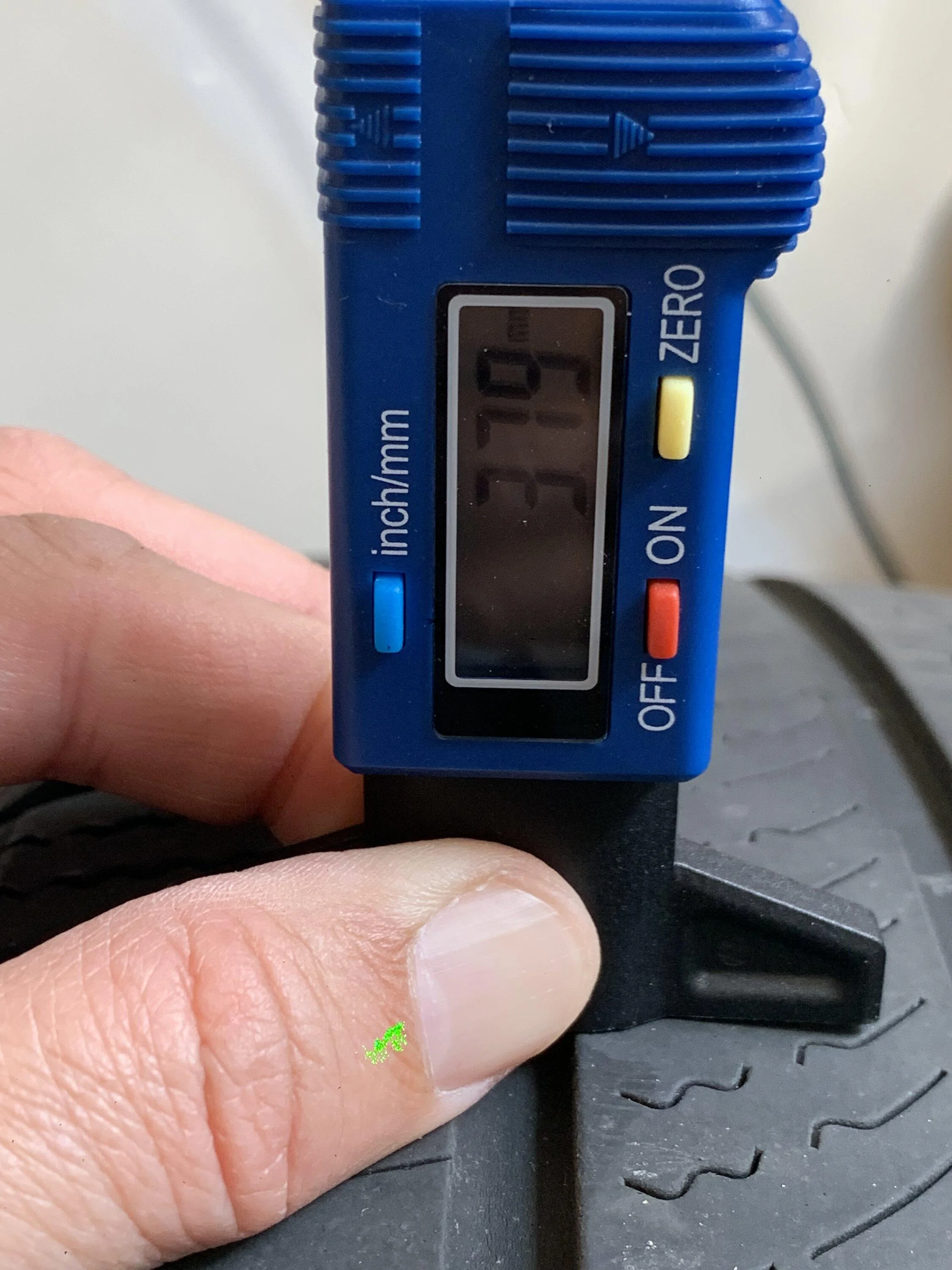

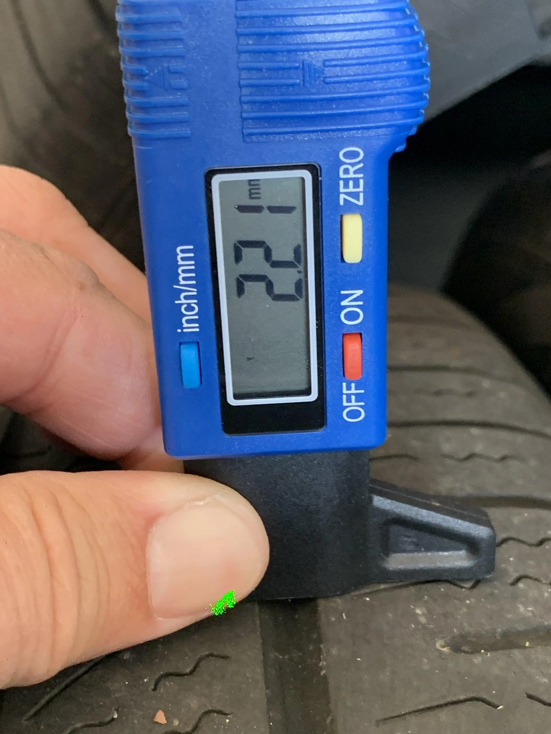

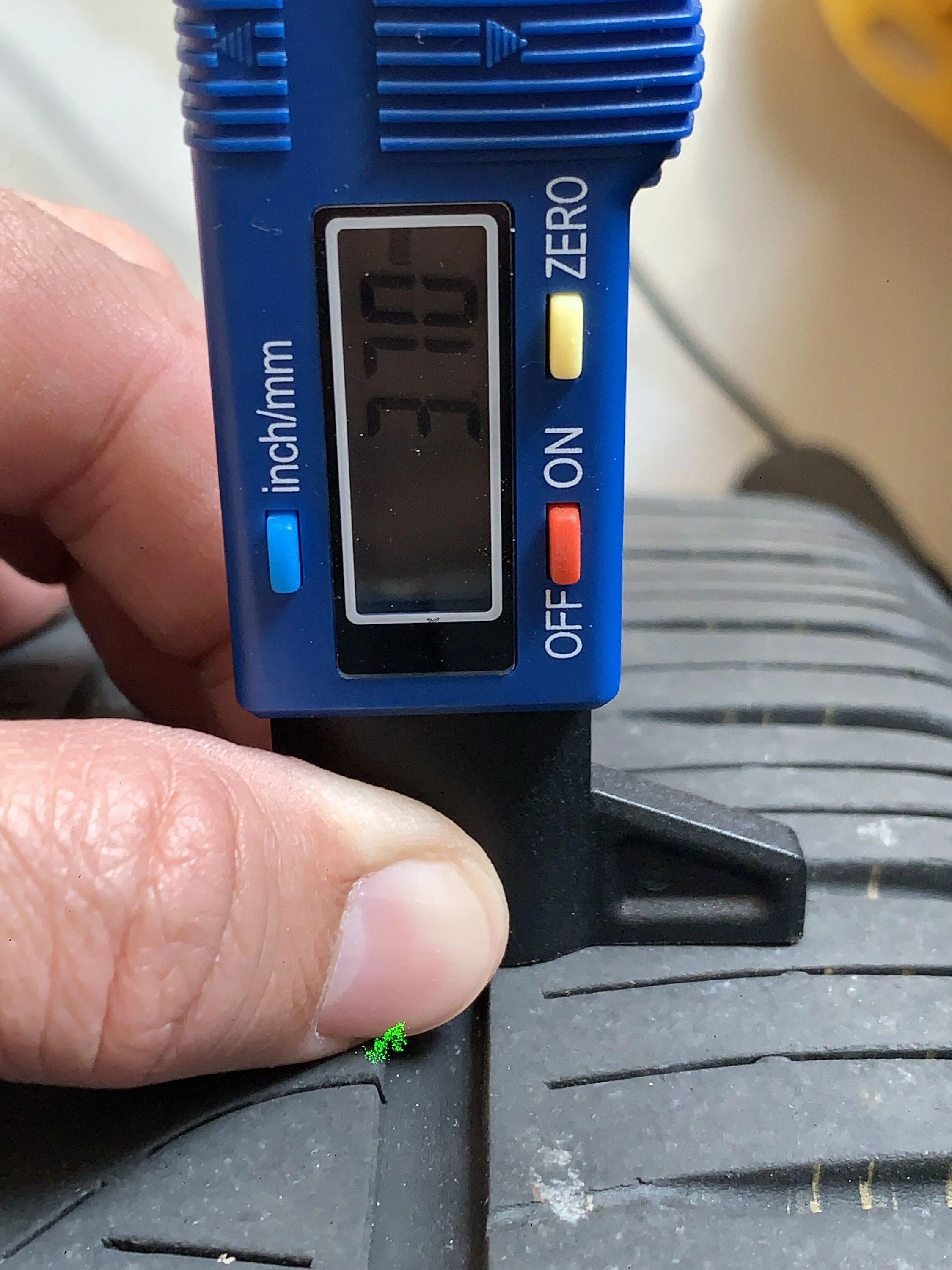

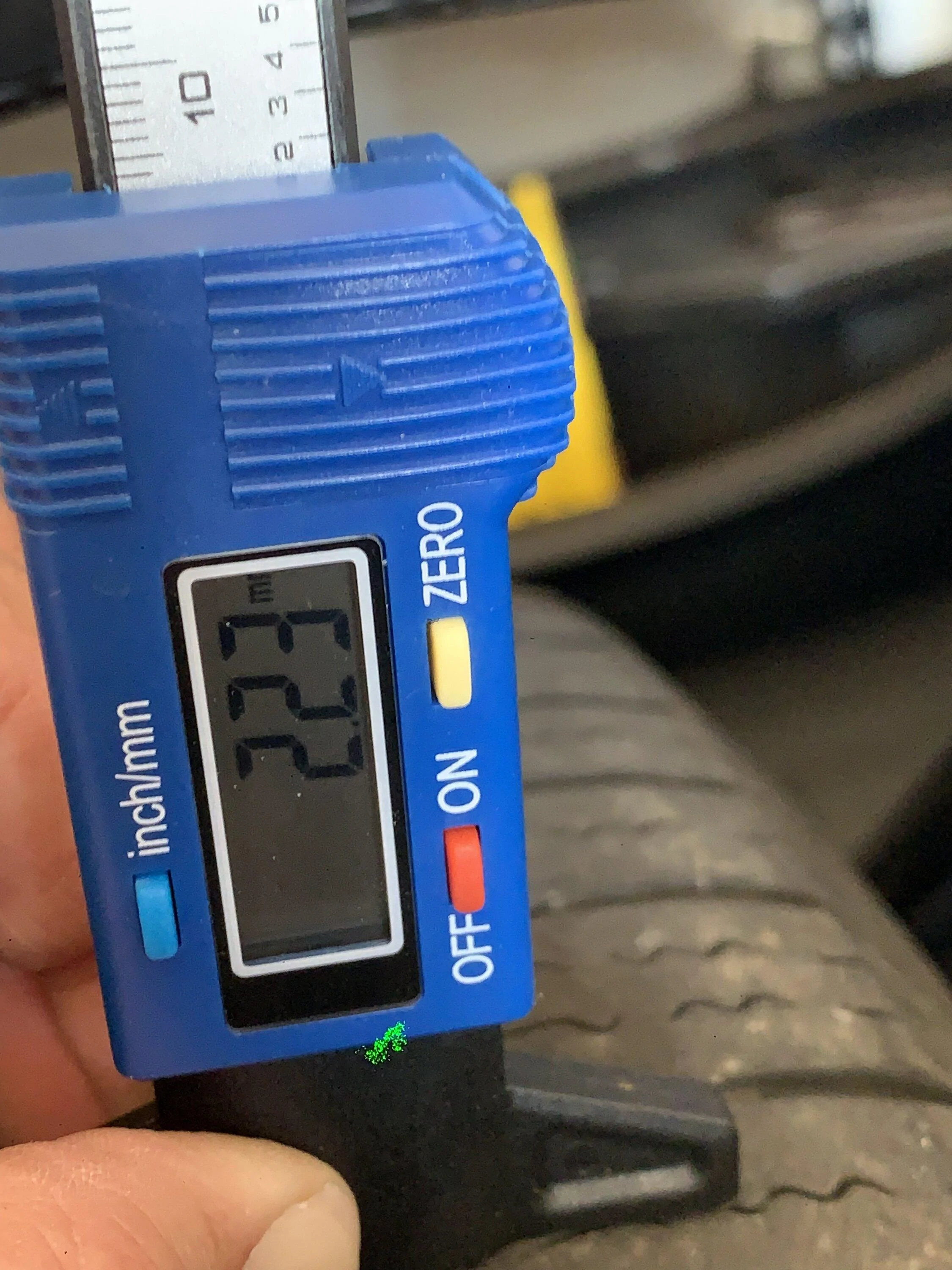

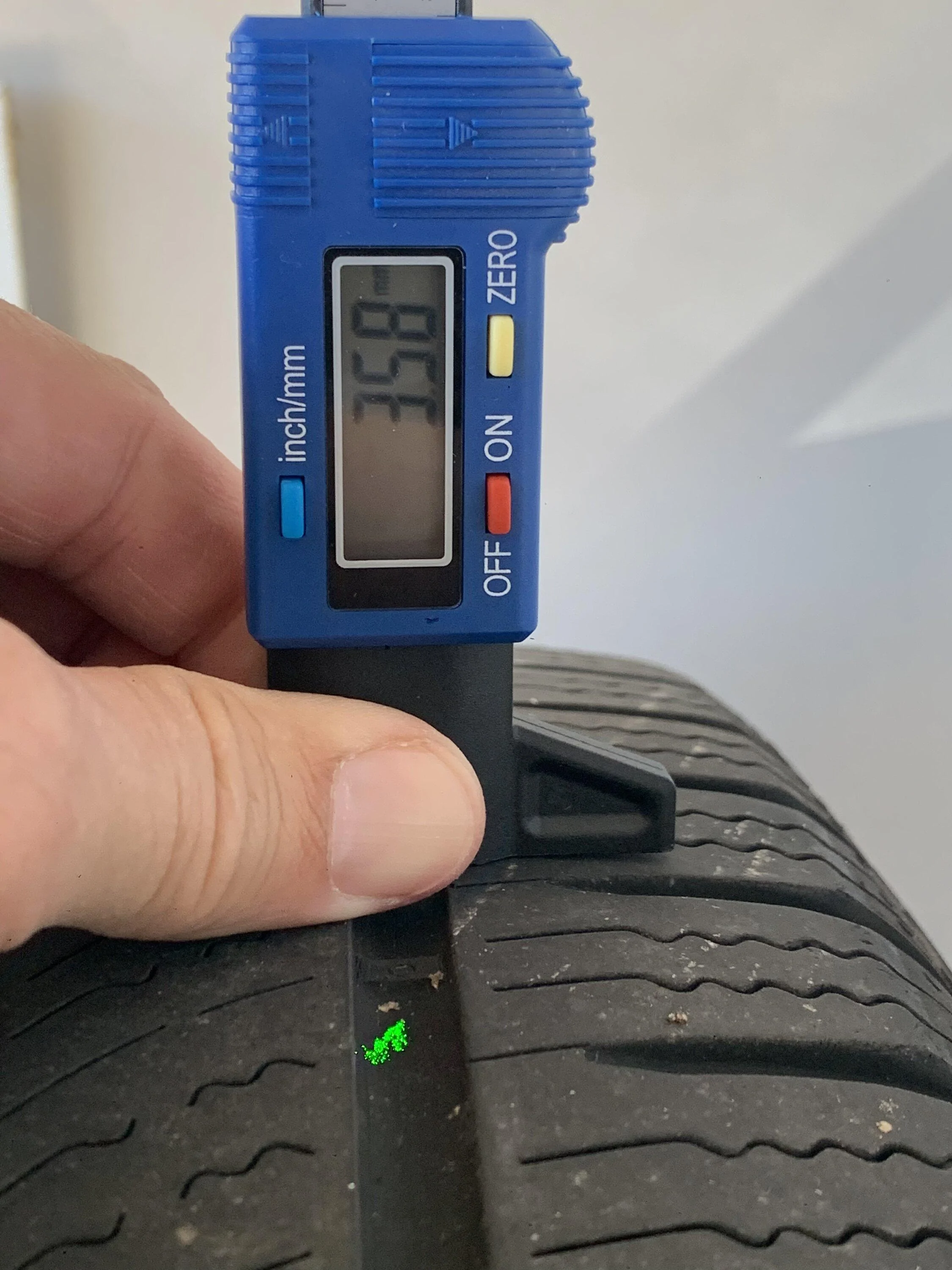

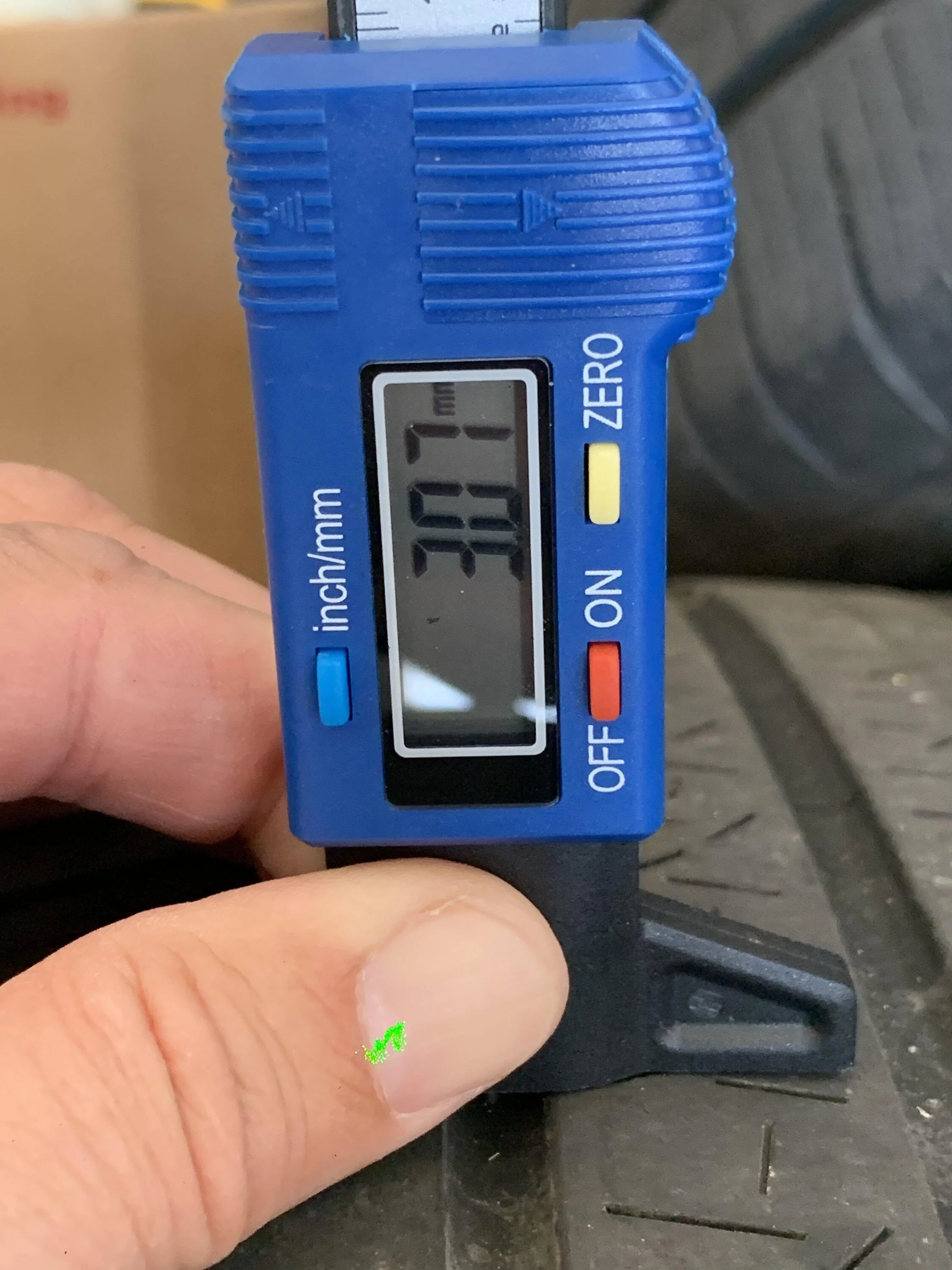

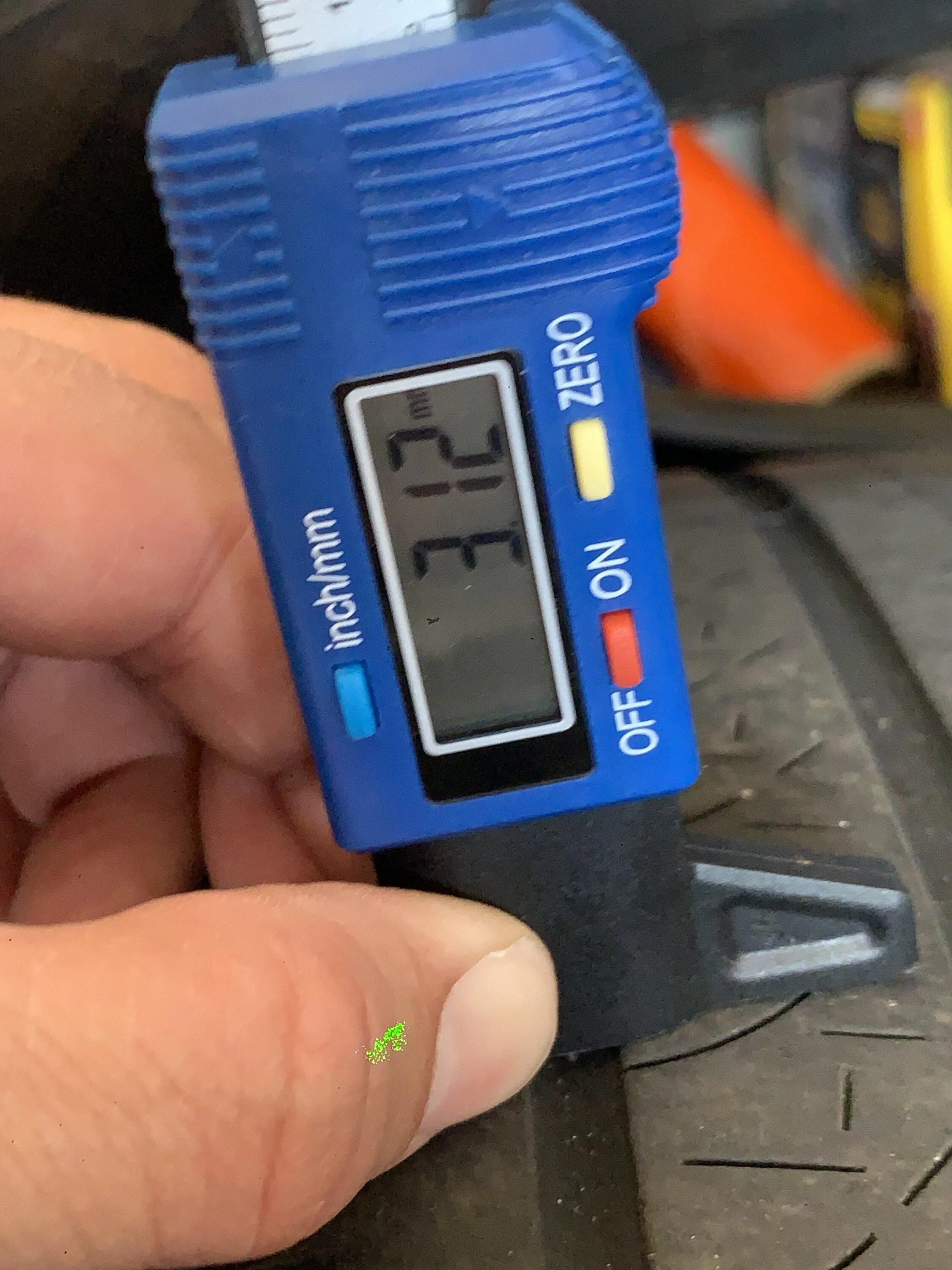

On the first week of December I had installed a new set of tires(Tire Discounters) for the winter season. Original tires still have some life remaining and I will be using them for next spring-fall season, but the numbers are:
PS
Rotation has been done every 7.000+ miles
Rivian R1T R1S OEM tires (22" Sport Tires) after 22K+ miles—tire tread depth remaining measurements 11539E7F-9736-458B-B0A9-663030518272
Rivian R1T R1S OEM tires (22" Sport Tires) after 22K+ miles—tire tread depth remaining measurements B9C30AA2-2E4E-46A7-8298-52B11FE43B56
Rivian R1T R1S OEM tires (22" Sport Tires) after 22K+ miles—tire tread depth remaining measurements 77189E94-756A-41E2-AB67-8CEE60C926A7
Rivian R1T R1S OEM tires (22" Sport Tires) after 22K+ miles—tire tread depth remaining measurements 8CA436AA-BC2F-4B42-A7DF-AAC54E93BB39
Rivian R1T R1S OEM tires (22" Sport Tires) after 22K+ miles—tire tread depth remaining measurements 348F0E77-E2E3-41E3-BC4C-18DAF31E76BC
Rivian R1T R1S OEM tires (22" Sport Tires) after 22K+ miles—tire tread depth remaining measurements A756F073-8343-4ED4-9045-4E192A3D56D9
Rivian R1T R1S OEM tires (22" Sport Tires) after 22K+ miles—tire tread depth remaining measurements B0AFB8C6-1208-4F83-B713-AC558E66274D
Rivian R1T R1S OEM tires (22" Sport Tires) after 22K+ miles—tire tread depth remaining measurements 71328AA5-D37D-4B6D-BA45-78F4FE16049F

I can't tell from that tread pattern - is that the 21" or 22" wheel+tire? It's definitely not the 20" AT.
And how aggressive have you been on the accelerator?
22’ sports…95% driving in conserve mode and moderate driving style overall

Forgive me for being dense but can someone explain the measurements?
theyoungone
Isaiah
Nov 1, 2022
236
529
Madison, AL
RAV4 Hybrid
idk what the 22”’s come with but the average tire comes with 8-9 mm of tread. It looks like he’s used over 2/3 of his at 22K miles. So if the current pattern/driving habits are any indication he’s got about 6-8K worth of driving left before they need to be replaced.

Like I stated in the thread, tires are OEM and they are Pirelli per Rivian decision. It’s “their fault” not mine…yet
I’m used to measuring on /32 instead of mm, but on the same tire for the Tesla MX I got roughly 15,000 miles before needing replacement at 4/32. On my Rivian, I’m finding it‘a about the same so far. I’m at 7-8/32 with 6,000 miles. So I’m projecting about 18-20,000 miles before needing replacement.
You’re getting more but with conserve mode with a less aggressive throttle and less overall power, so it does seem to be in line with what these tires are capable of.

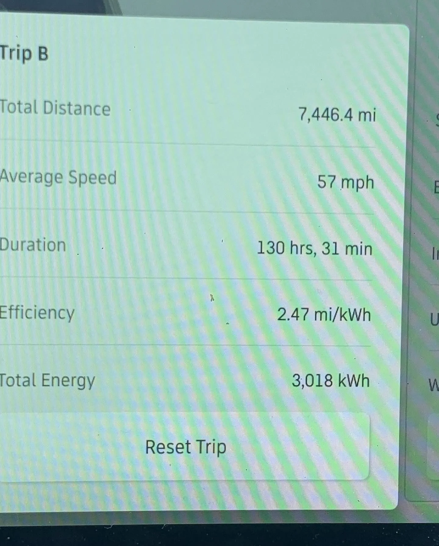

Curious about the high conserve mode usage, is the majority of your driving long distance/highway driving?
Over 95% is highway driving and vast majority of the miles are done on long distances. This picture is from a 10 days trip around the country back in May.
Rivian R1T R1S OEM tires (22" Sport Tires) after 22K+ miles—tire tread depth remaining measurements 15768F42-3E22-4946-8B81-AB46FB5458D4
2.3 mm to 3.7 mm translate to 3/32 to 4/32. If you want good/safe traction in wet condition then it's time to replace those.
That’s why I put a new set of tires. To be safe for the winter.
