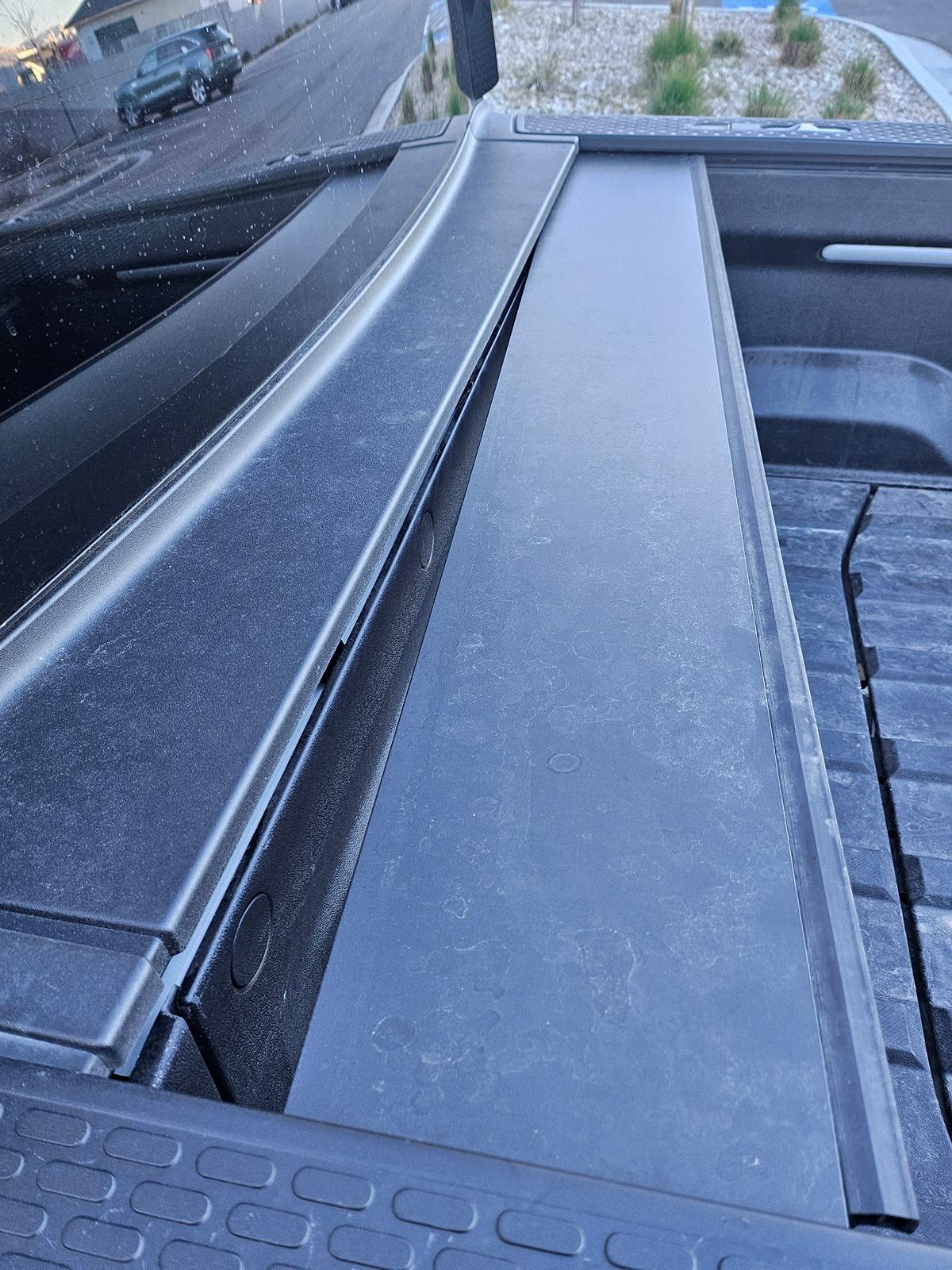

Like many people, I had issues with the original powered Tonneau cover. It would retract about halfway and get stuck. I reported this months ago and was "on the list" for a replacement. A couple of weeks ago, Rivian called to say they had my newly redesigned Tonneau cover in stock and they were ready to schedule the replacement. I dropped the truck off and it took two days, but I got my new cover and all was well, or so I thought.
I never really used it until about two weeks later. I pressed the "open" button and the cover retracted about 2/3 of the way and stopped. The screen showed an error saying the "cover was jammed, please extend and retract it again" which I did. This time it again retracted about 2/3 of the way and then it let out a very LOUD pop. The majority of the cover retracted and was spinning inside while a section of the cover separated and was left outside at an odd angle.
I called Rivian and they said they had never had one of the new ones fail (just my luck) and they would get it in ASAP and since they had another replacement in stock, they should be able to repair it the same day. Well, I dropped it off this morning and they just texted to tell me it did need to be replaced but they did not in fact have one in stock and I will get my truck back in about 3-4 days with what will be my 3rd tonneau cover.
I just do not understand why they continue to struggle with these covers. Very frustrating.
Just for data, what was the temperature when this happened? Was it sitting out covered by snow/ice at any point?
I am hoping that it’s a low probably early-life failure mode and not a design flaw with PTC2.0. Simultaneously, I fear we may be in for dry-lube party 2.0.

I wonder if something is off regarding the alignment of your tracks causing the immediate failure
IMO snow and ice alone aren't enough to break it unless it's completely covered.

My original has always worked for the most part, however, it jams depending on the temperature. It seems the slot where the fins retract into sags a little in the middle, and this is exacerbated by warmer temps expanding the plastic that runs across the top of the slot. When it jams, if I press down a bit on the middle of the jammed tonneau fin, it fully retracts as it should.

I had mine fixed a few weeks ago, I have opened and closed it maybe a dozen time but each time I hope all goes well. So far it has. I do have a silicone spray recommended by a Rivian rep that came to fix my first cover and I use it often. Logically I cannot see how the cover will continue to function unless you keep the rails perfectly clean. Today my cover works but thanks for the warning I will be more selective of when to open and close it.

Went offroading a couple weekends ago and got my v2 powered cover muddy and dirty as all get-up. I power washed her clean, but it's sounded REAL creaky ever since....
