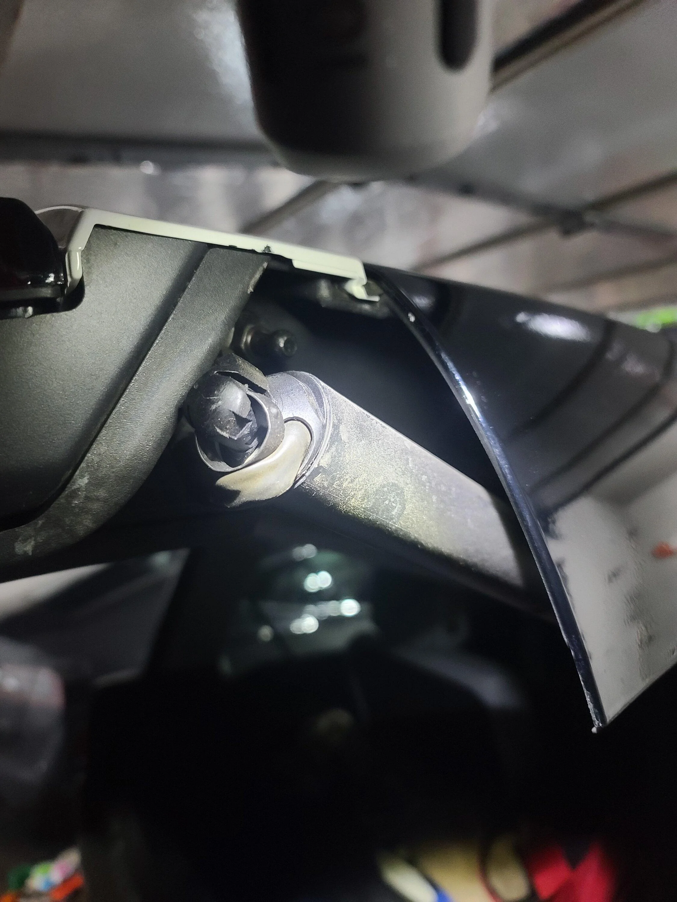

Appreciate the info here and wanted to add my own for anyone with the same issue that wants to diy.
I found that if you have a clunk when the liftgate opens (meaning the liftgate is adjusted too high and binding on the top plastic) then you need to adjust the top 4 hinge bolts to slightly lower the gate when closed. Rough DIY procedure that I used to fix mine below. You have to disconnect the lift struts or the gate will pull itself all the way down in the adjustment (ask me how I know 😞
  • Open the liftgate, turn off the power liftgate option in the interface.
  • Support the liftgate with something, I used a 6 foot step ladder.
  • On both sides of the gate, with a flathead screwdriver pop the clip holding the lift strut on, attached picture.
  • Pull the strut out with your support ready.
  • Loosten th 4 bolts on the top of the gate and slide back very slightly and tighten them back up.
  • Reconnect the struts and check your alignment, may need to do this a few times, it only takes a few mins once you get it.

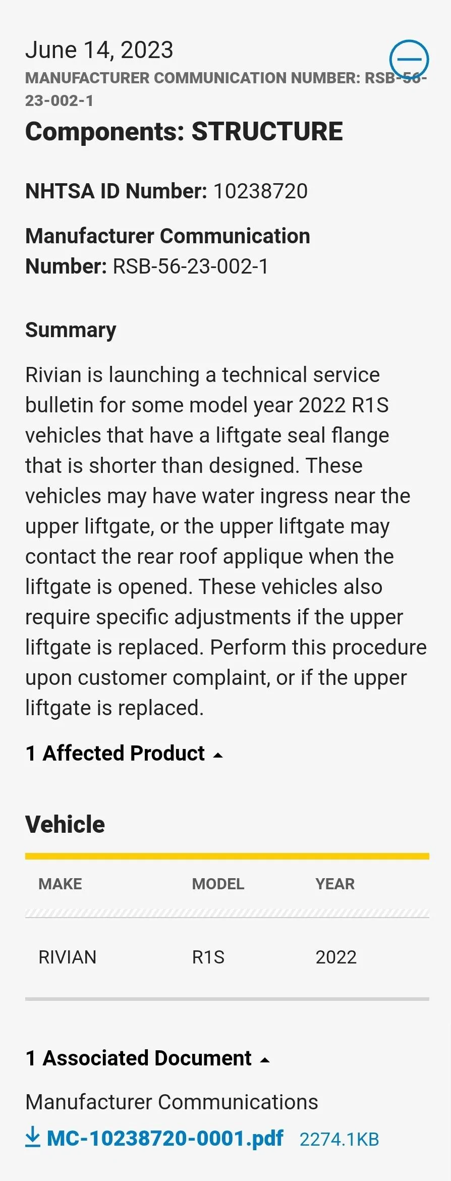

Before I go into my liftgate details I'm really posting this to point I found this document from Rivian about alignment tolerances, adjustment points, and torque of the liftgate bolts from a customer satisfaction communication on NHTSA.
It specifically references early 2022 R1S's and a short weather seal on the liftgate - how to adjust if leaking, seal needs replacement, or liftgate is replaced.
However, I expect the torque specs, which bolts to adjust for which gap alignment areas, and even approximately the gap range tolerances would be similar or identical on all of them regardless of this weather seal issue. I'm not sure if you can edit the first post or not OP, but if you could it may be worth linking the PDF document along with your great guidance!
https://static.nhtsa.gov/odi/tsbs/2023/MC-10238720-0001.pdf
This saved my butt.
I was trying this exact thing and didn't realize had to disconnect the struts.
going on a road trip next week and the lift gate wouldn't close after my initial attempt at adjusting.
called in a panic to service center, no service appts.
google found this and I got myself out of trouble, ski trip saved.
big thanks here Scott1620.
forums working as they should...
