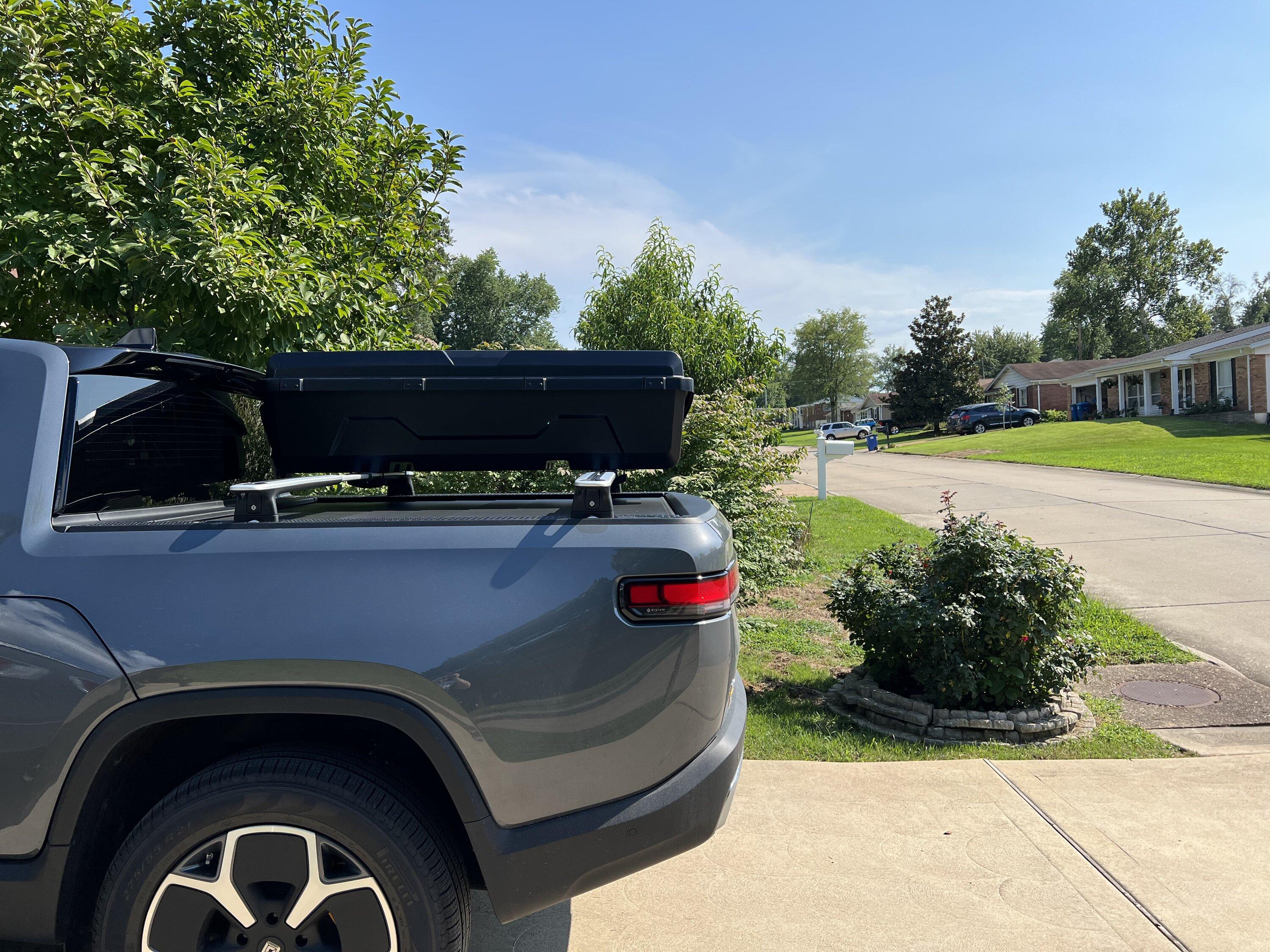

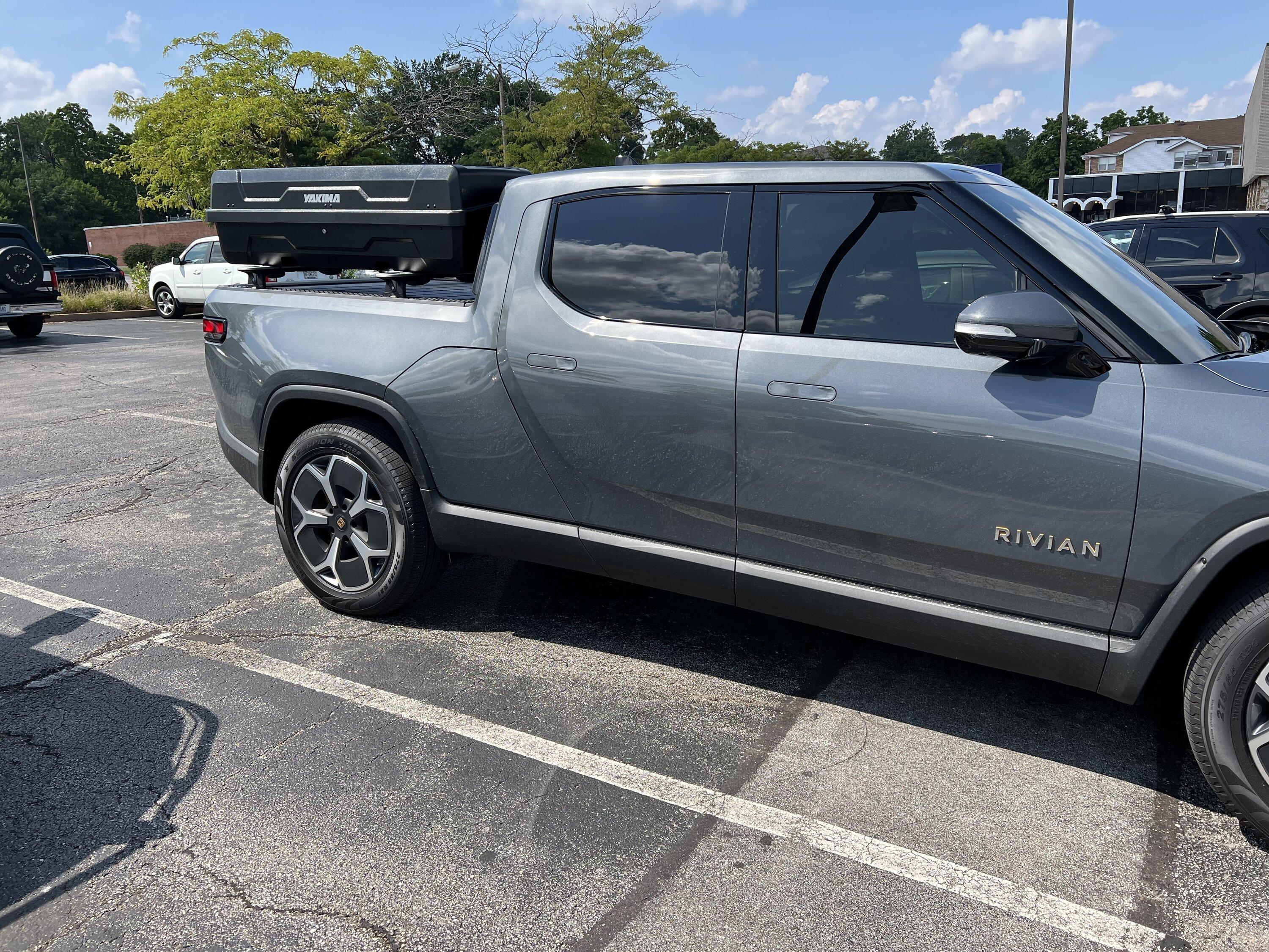

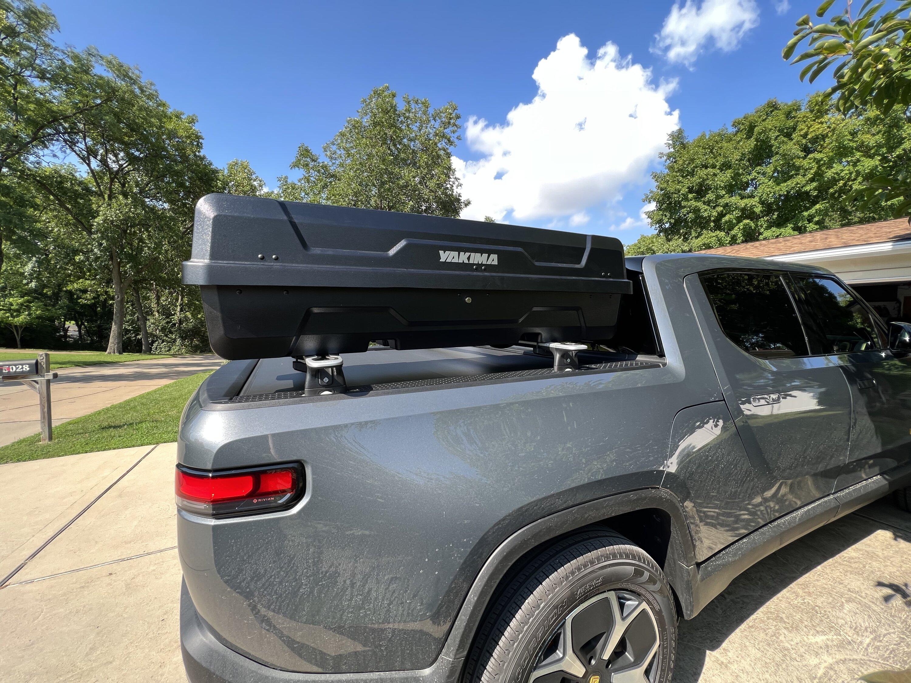

There is no noticeable air resistance or wind noise. I did not notice a measurable reduction in efficiency either.
It does have holes and U clamps that go around the Rivian crossbars just right. You do have to situate it just right so it doesn’t barely rub the roof black plastic piece.
Hope that helps!
@colorado
Looks good; curious if there is any additional wind resistance with the box sticking above the cab that small amount. Also curious if you had to drill holes in the box to mount it to the cross bars (do the deepspace boxes have mounting holes that the EXO gear lockers don't?). I picked up a couple of the EXO gear lockers over the weekend in anticipation of my R1T delivery in a few weeks.
Thanks for posting pics!

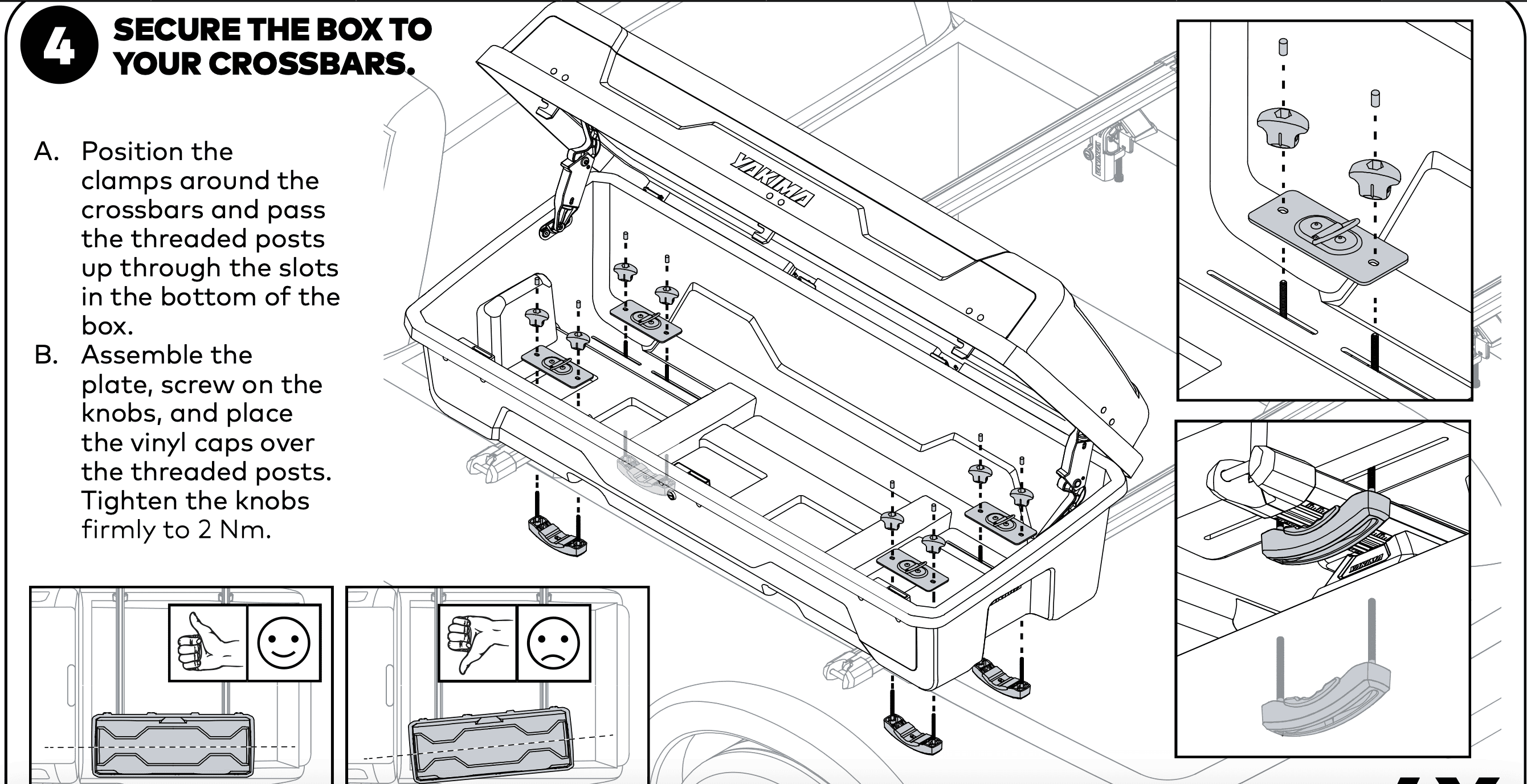

Is it possible to take a picture (inside and outside) of the mount you used or a link to where you purchased it. Thank you.

You can see a detailed image in the user manual found here and in the snip I have included.
The Clamp mount that is included with the box works perfectly and it is padded. You tighten it from the inside with a plate that distributes the tension/weight.
Hope that helps!
