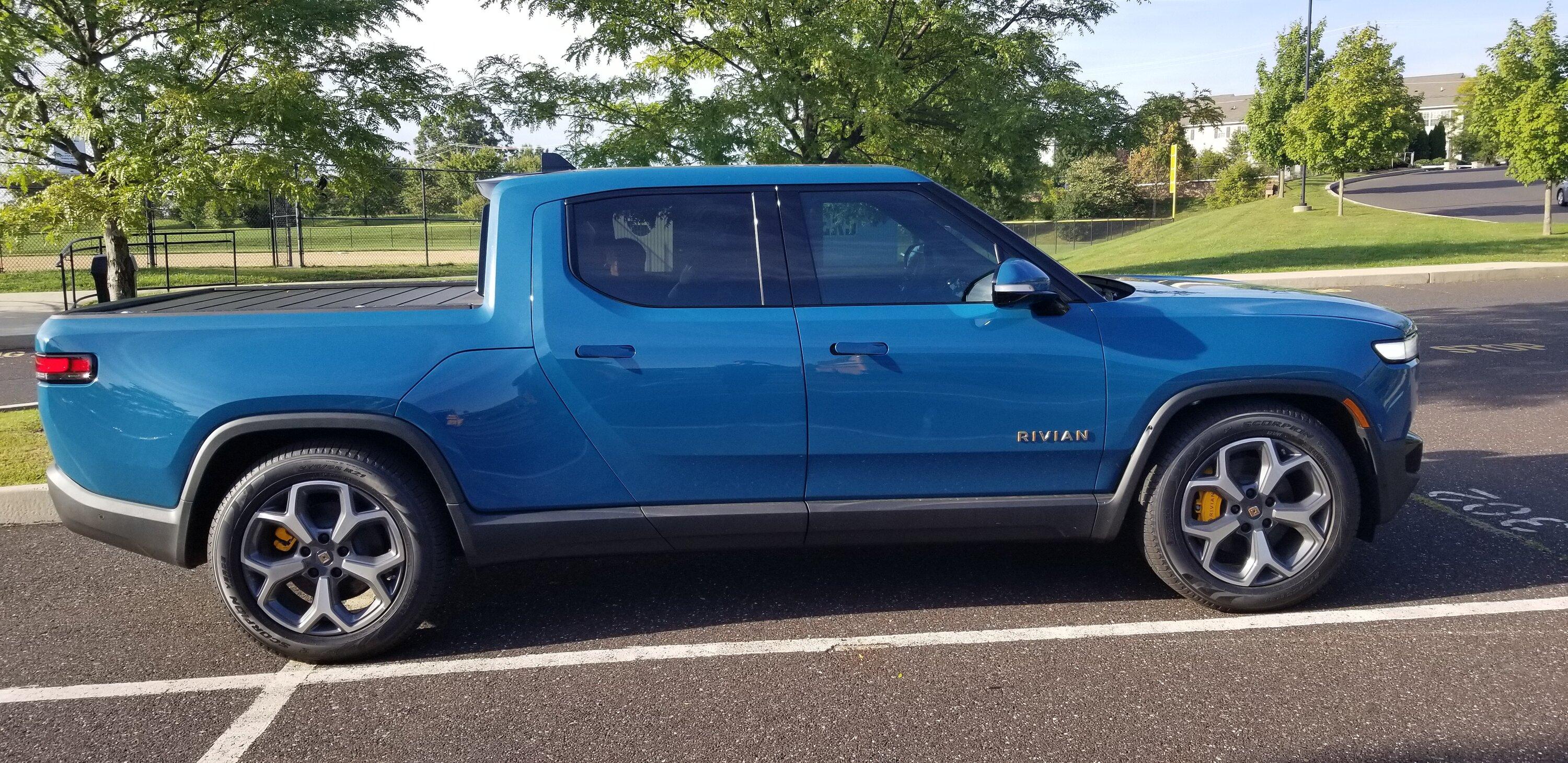

For those in the northeast US thinking about ceramic tint from any manufacturer for heat reduction, below is my experience on in cabin temperatures before and after ceramic tint.
XPEL 45% XR Plus was added to the front windows and 70% XR Plus was added to the windshield. The rear windows are stock (pretty sure they are 20%) and roof glass is untouched/stock as well.
In the same (extremely similar mother nature conditions) temperatures / humidity / physical parking spot over a week worth of comparison before and after the XR Plus, I am seeing a 15+ degree difference on average of untreated (no hvac run) in-cabin temperature.
What was 135 degrees F average without the tint, is now <120 average (closer to 115ish).
The front dash is no longer hot to touch - before tint, I would touch the top of the headrests of the front seats and then touch the dash. I would also use a cheap laser thermometer on the headrests and front dash to compare surface temps. The differences I experienced /observed are what influenced my decision to only do the front windows and windshield.
Matching the rear windows at 20% was not desired for me - past experiences with night visibility on road and parking situations combined with less desired legal issues for me is why 45% was picked for the front windows. Could have gone 70% on windows too, but thought 45% looked better for my tastes. The 45% does have a bit better light reduction in the various spectrums. For XPEL, I believe the 45% is 1.5mm thick and the 70% is 2mm thick.
There were a lot of discussions on heat reduction and tint. These are my experiences, with my data, and my choices. However, I hope this can help others who were or are trying to decide what may work best for them and their tastes.
(I'm located in south east Pennsylvania)
(I'll try to add some pictures soon as that may help as well)
Edit: picture added with full light / sun low in sky
Rivian R1T R1S XPEL XR PLUS temperature report 20220921_171225
