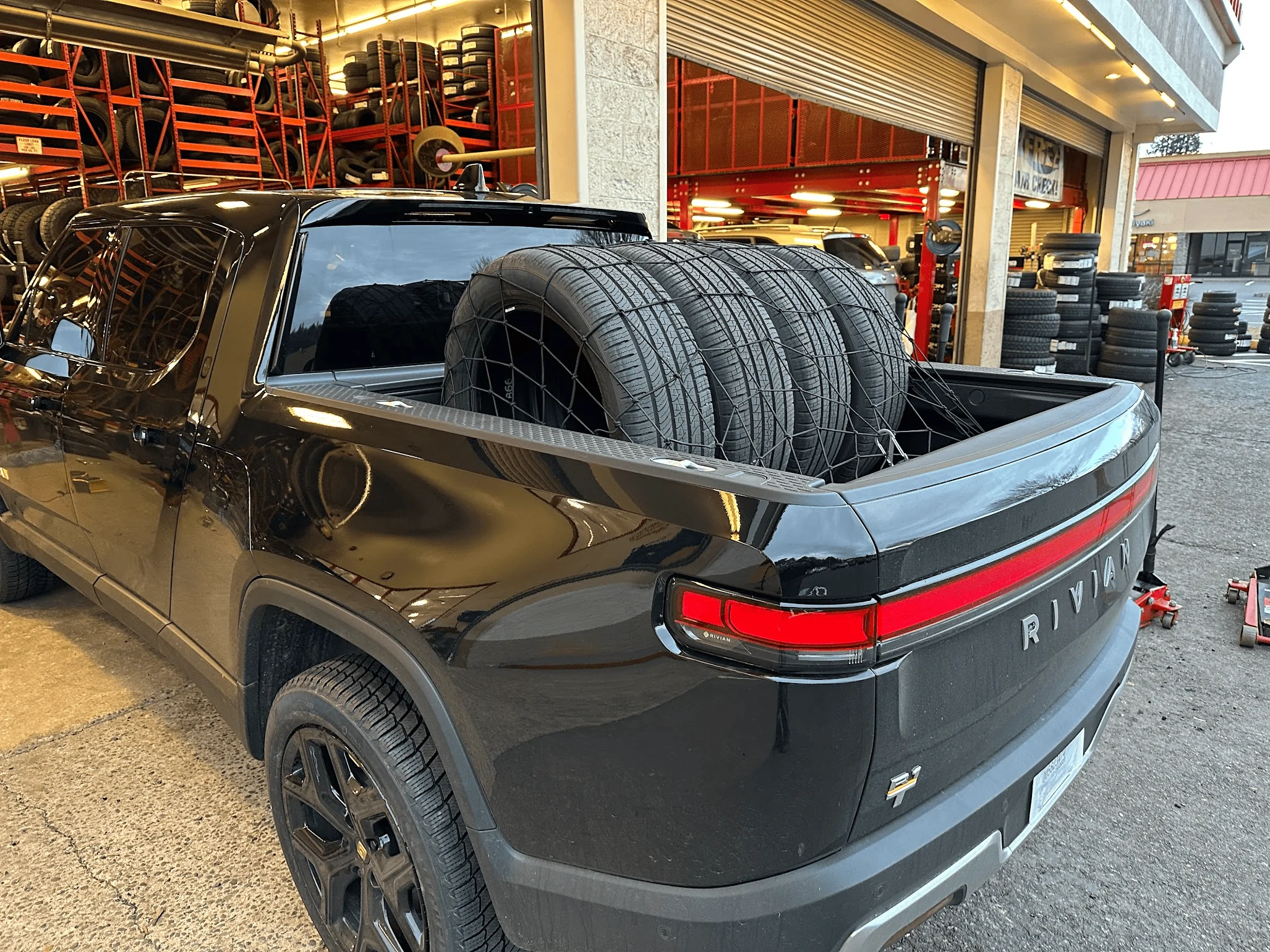

I have option F or are we up to G now. I have the 22" dark wheels and have dedicated snow tires (Michelin X-Ice) ~$257/tire from Discount Tire that I picked up last December. I do pay $80 to dismount and remount my factory all seasons each time, but over 5 years (2x mounting and dismounting), that is still less than $1k, cheaper than another set of wheels. (Snow tires mounted in this pic)
What size are your winter Michelin X-Ice? Looks like a good option.
