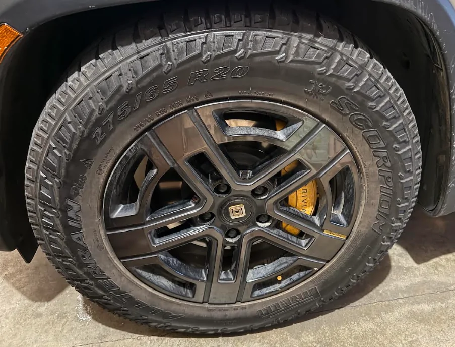

The Michelin Defender LTX M/S 2 are amazing - I didn't realize a tire could make such a difference in the drive quality. Of course, I'd never had ATs on any vehicle either. I do miss the look of the ATs. Here's what I went from:
Rivian R1T R1S Weird issue (resolved) anyone seen before? Maps, Cruise, Settings not working right 1769302921452-x9

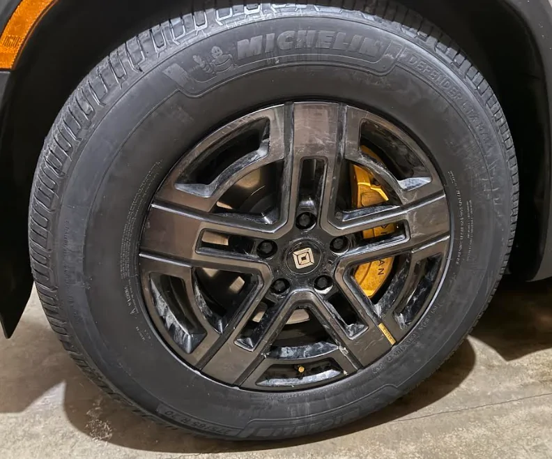

And here is the Michelin:
Rivian R1T R1S Weird issue (resolved) anyone seen before? Maps, Cruise, Settings not working right 1769302972787-d2
I went from TIRES that screamed "I can do anything" to tires that don't catch your eye. Worth it? Absolutely! I still miss looking at the ATs when I walk up to my Rivian, but as soon as I start driving it's so much quieter and the ride so much softer that I just smile.
