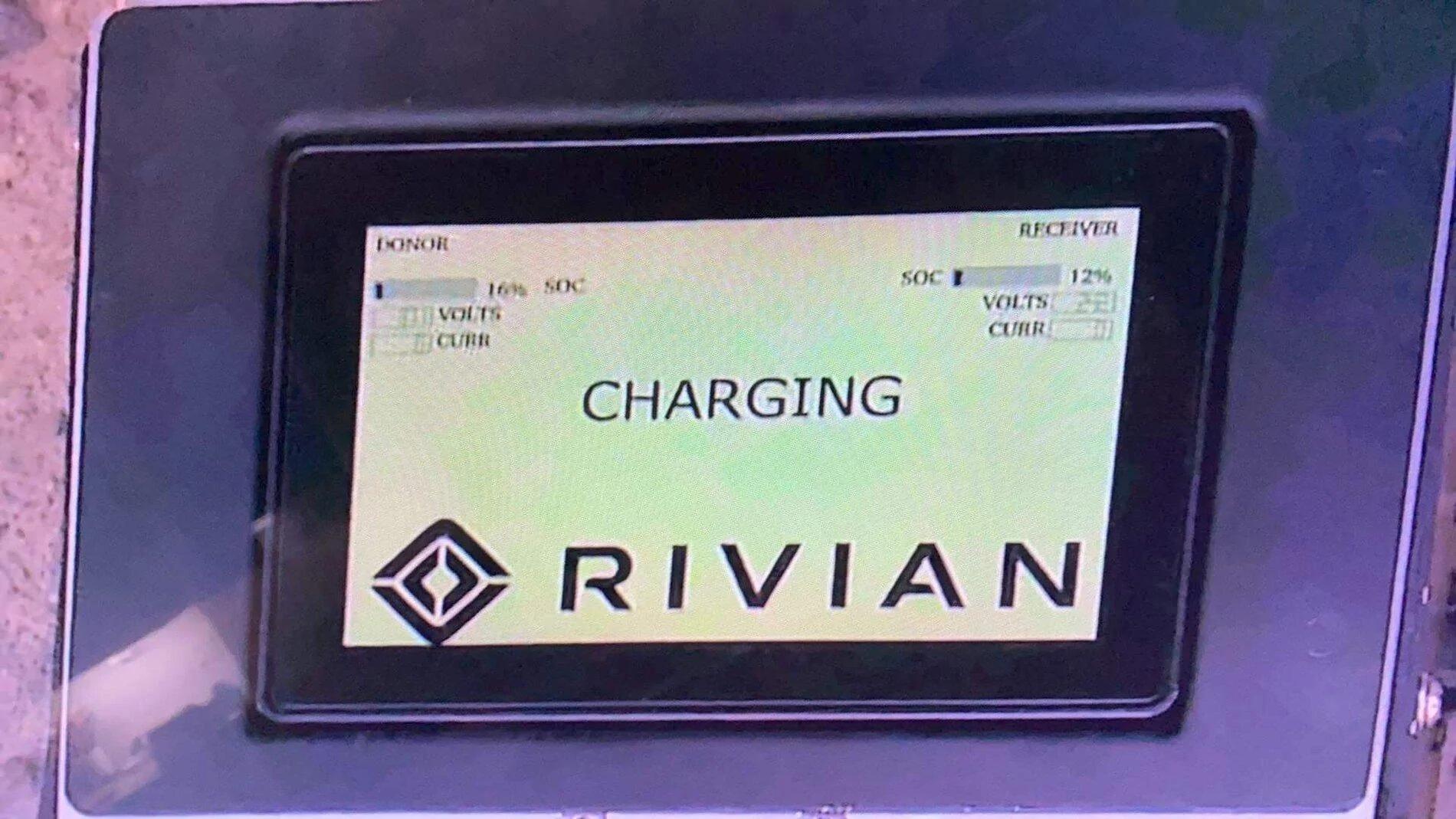

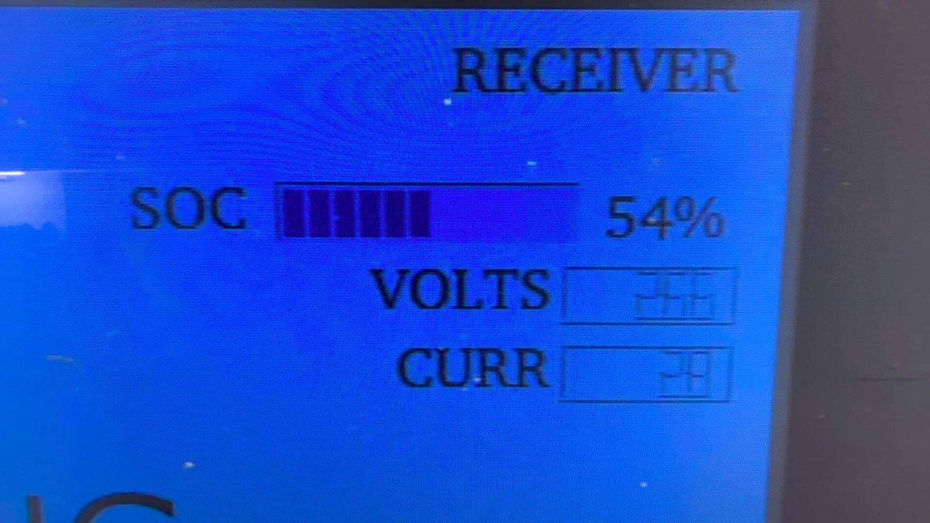

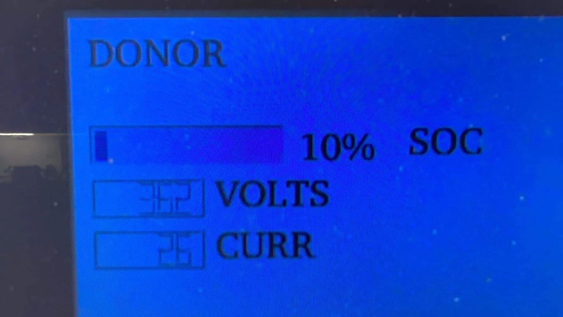

skyote
2,725
5,647
Austin, TX
Pics of the charger from Long Way Up.
Rivian R1T R1S Vehicle to Vehicle charging received_367386514381152
Rivian R1T R1S Vehicle to Vehicle charging received_2758882494394530
Rivian R1T R1S Vehicle to Vehicle charging received_362150851650988
