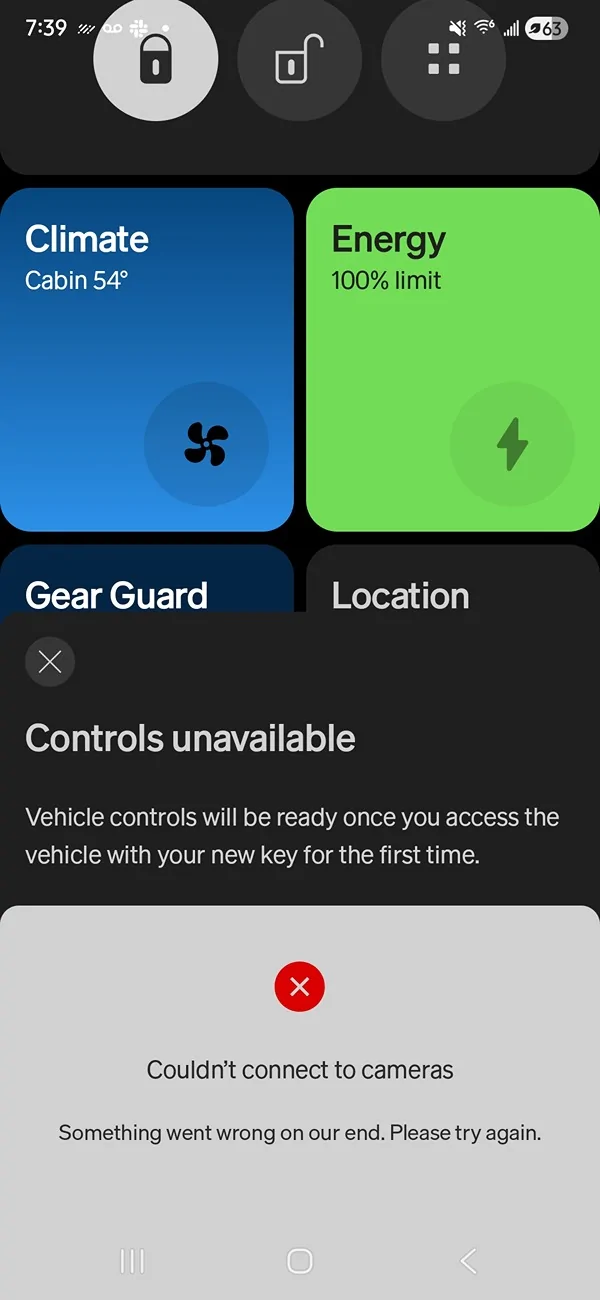

I have a gen 2 R1S. After installing update 46, I successfully created a digital key (note, I am a Samsung user). After doing so, my original phone key was removed. With the digital key, proximity locking/unlocking works, but the remote access stuff is no longer working in the Rivian app. Remote lock/unlock, climate/comfort settings, open/close hood, lift gate, and charge port door are all inoperative now. It acts like it is performing the selected function, but nothing happens. Also, it seems that I cannot revert to the old style phone key. I have the latest Rivian app version, and I have power cycled my phone. Anyone else experiencing this? Any solutions?

The digital key creation is almost forcefully done. I didn't even have the option to lock/unlock the icons they literally were overridden by Get Digital Key. I just used my wife's account to check on the car it works just fine. Ever-since I got the key remote viewing is gone. Another service ticket.
While you can't revert that key, you may have luck (and extra work) by setting up another Rivian account (non-owner), and never inviting it to use a digital key. However, you will have to reset all your personalization settings if you go this route. And you'll log in and out of your old (assuming it's the owner account) and new accounts in the app several times to complete the transfer of any NFC cards or fobs.
I've gone this route, and appear to have my "old" functionality back. Summarizing:
  • Owner account: no keys assigned anymore
  • New account:
    • NFC key transferred
    • No digital key invite sent
    • PaaK works as old bluetooth key
(see also this thread)

Hmmm, so once you download the update, it sounds like you’re pretty much stuck going the digital key route?
I don't think so. You choose to install the digital key, but once you've done that then you're stuck with it.

Yup, nothing remote works even though I've used the key already.
Thanks for sharing your similar experience. Please report to Rivian via "Feedback" in the app.

Out of curiosity, are you Apple, or Samsung?
Samsung Galaxy S25 Ultra. I do have a 2nd phone and Samsung Galaxy S24 Ultra I can use with a 2nd number that still has my account. This is a pain though opposite of the convenience.
