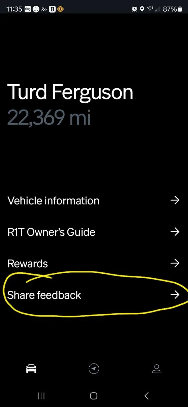

Also, where can I report bugs like this? It almost seems like they don’t want to be aware of such issues because there’s no convenient way to report them.
For this particular problem, I have a scheduled service appointment in December. ?
That's the only way, I've used the service request feature for previous bugs and they said keep using that way. They assign to software folks who later mark it resolved when they log it.
That's the only way, I've used the service request feature for previous bugs and they said keep using that way. They assign to software folks who later mark it resolved when they log i t.
You can send in bug reports in the app...
