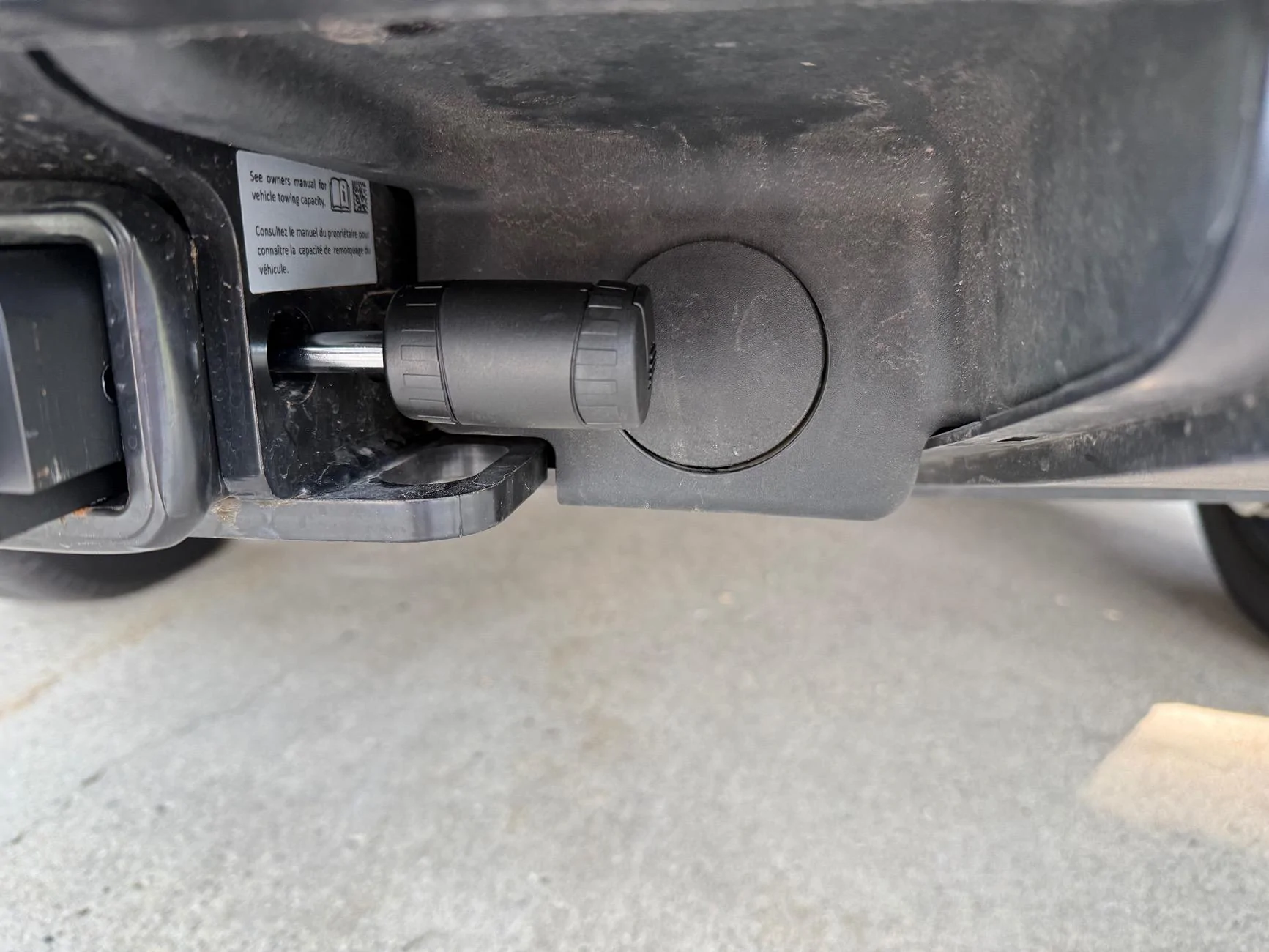

Several problems. First, the 12V jumper wires are attached to the battery somehow, but no 12V is detected when Rivian is powered on. So will have to go into the bed or further forward to get 12V. Why Rivian only put 12V in the gear tunnel is beyond me. Could somehow wire a 120 to 12V converter to outlets in the bed. Second all 'hot' pins needed (brake, turn, running) in the 7 pin connector are at 13.5 V while truck is on. Something needs to be plugged into the 7 pin, i.e. a 7 to 4 pin adapter with something attached (a load), to get the pins controlling the turn (brake) signals to drop to 4.35V (goes to 13.5V when lit). So if nothing is plugged into the 7 pin there is no signal (amp/voltage change) for the Tekonsha to trigger off of. So that means going into the tail and brake light wiring harness in the bed.

The 12V battery jumper wires behind plug opposite the 7 pin.

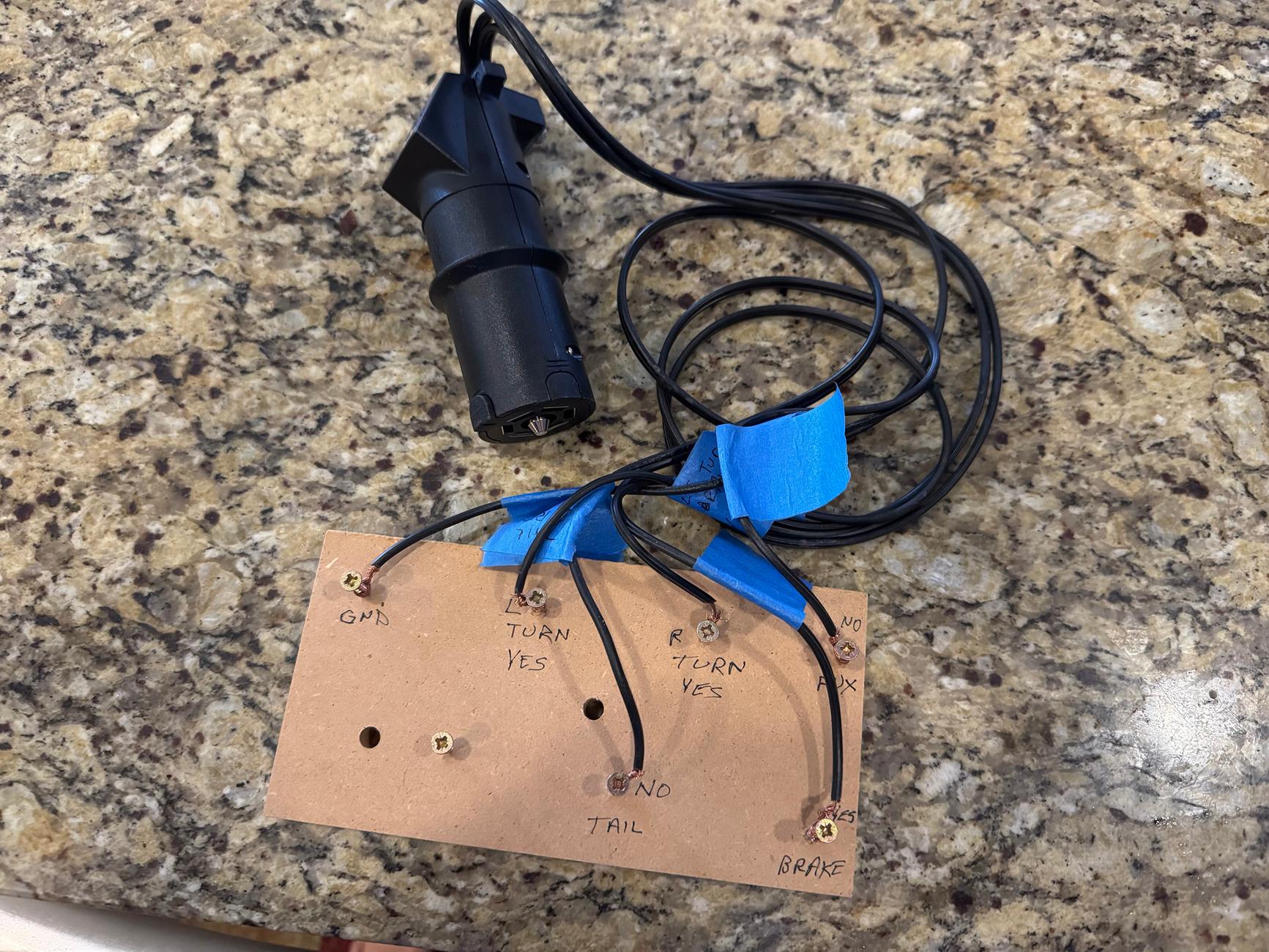

Oh, gotcha. Well, you can do that or use the 12v from the trailer plug. I've tested it extensively to determine what will or won't trigger the lockout. I tried fooling it using optocouplers which have a basically infinitely tiny load; it still senses it on the lighting wires.
But again, the ZCI is a no-go. I've considered getting a generic CAN decoder with some relays to trigger the trailer lights, which would work.

I get so frustrated with Rivian‘s timidity I could just scream.
100%. I would not choose Rivian, and don't recommend it, unless you really need a truck and aren't willing to put up with the stupidity of the other EV trucks. We really do need a truck and the others are a joke in some way.
Here is my test rig with the results. Yes means lockout if connected.
