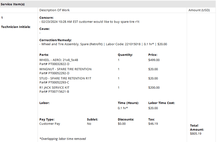

Here is my work order from the Gear Shop to give you something to compare to as you build out a spare tire kit:
Rivian R1T R1S Suggestion on spare tire / wheel for R1T? Spare Tire.PNG

Thank you! You are lucky you have 21" wheel which would be cheaper than my 20" dark wheel.
