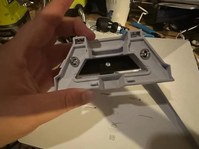

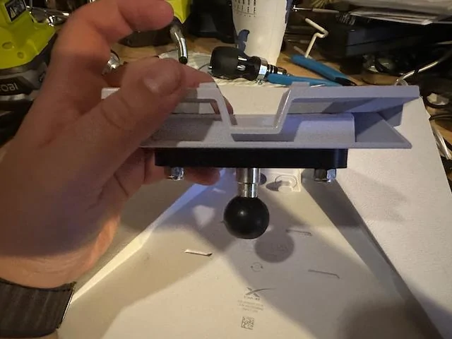

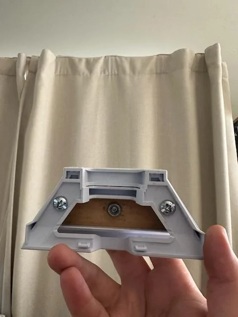

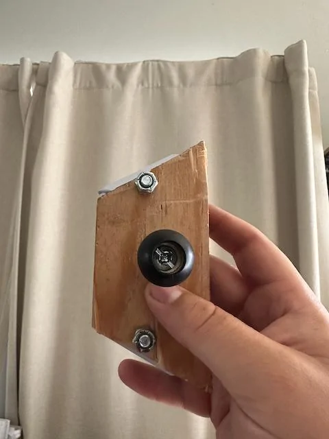

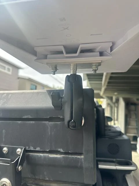

I mocked up a mount adapter with scrap wood first:
Rivian R1T R1S Starlink Mini Custom Mount IMG_1733
Rivian R1T R1S Starlink Mini Custom Mount IMG_1734
Rivian R1T R1S Starlink Mini Custom Mount IMG_1736

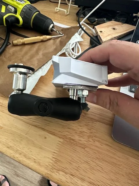

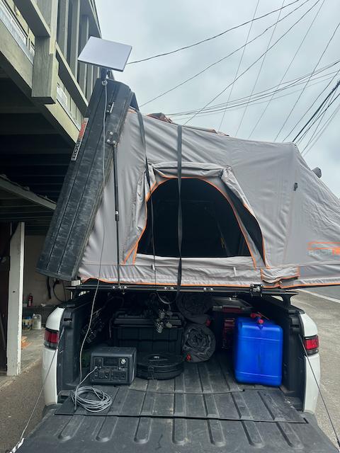

I liked how it was coming so switched to some flat aluminum scrap I had, and added some ram gear to mount it to extrusions on my tent:
Rivian R1T R1S Starlink Mini Custom Mount IMG_1749
Rivian R1T R1S Starlink Mini Custom Mount IMG_1744
Rivian R1T R1S Starlink Mini Custom Mount IMG_1748
The Ram mount is super simple and lets it work with the tent closed or deployed.
Also, the adjustability of the Ram ball means I can get the exact tilt angle and alignment to give the dish exactly what it wants to be happy.

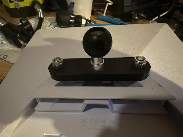

I decided to work up a basic adapter in CAD to make a usable 3d model, 3d Print it, and send a final version to sendcutsend for a high speed titanium or anodized aluminum piece, just for fun.
I still don't know if I want the final piece to be threaded, or rely on nylock nuts
I only had one length of machine screws so I may run to ace to get a longer one, or two shorter, depending on what I decide on.
(currently not using this in motion so vibration isn't a huge concern)
Rivian R1T R1S Starlink Mini Custom Mount IMG_1753
Rivian R1T R1S Starlink Mini Custom Mount IMG_1754
Rivian R1T R1S Starlink Mini Custom Mount IMG_1752
Also of note, the Mini needs 70W to fully boot up.
My blietti EB3A claims o have a 100W usb c port and a 10A DC barrel plug, but unfortunately wasn't strong enough to run the Mini.
Not sure if it was cables or power bank issue, but for now, the standard plug works fine.
