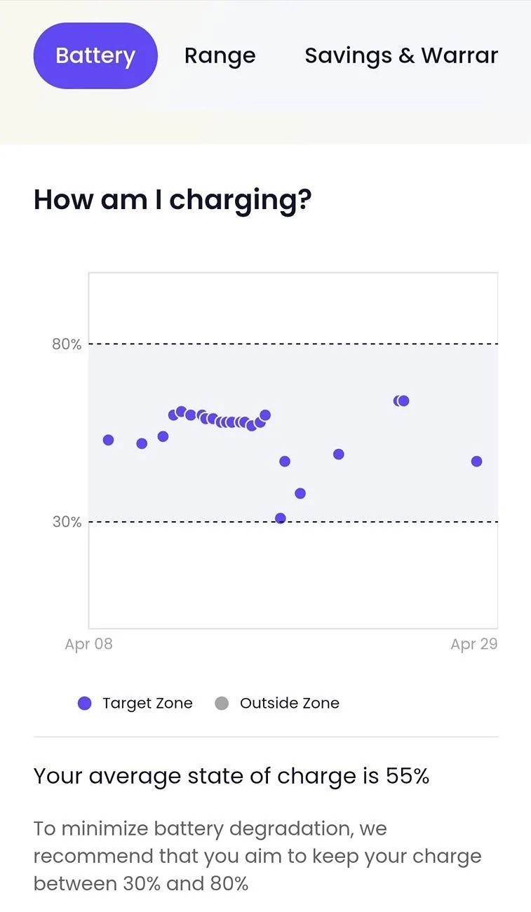

Same approach here. If truck is just being used around town I try to have it sitting between 30 and 60. Top off before trips, but try to avoid long charge sessions leading to high battery temps.
Rivian R1T R1S Rivian vs Tesla - battery degradation Screenshot_20250428_170604_Chrom

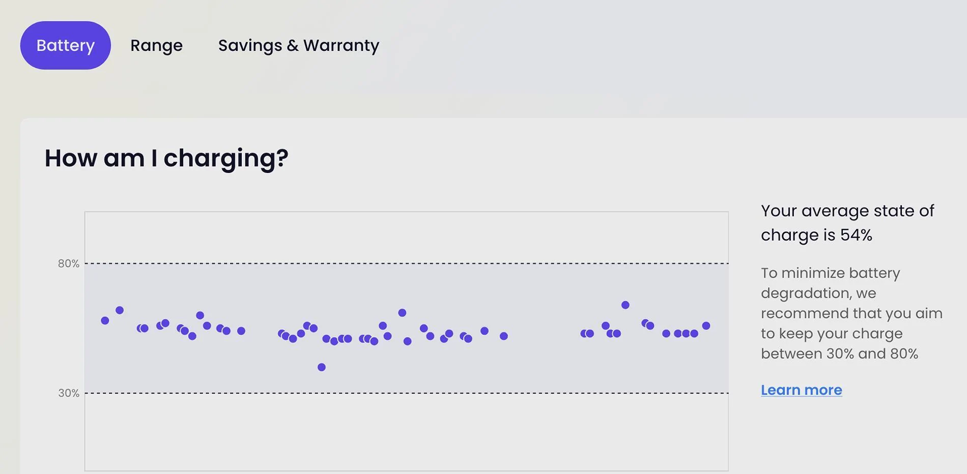

Pretty similar to mine. :like:
Rivian R1T R1S Rivian vs Tesla - battery degradation 1745875338926-71
