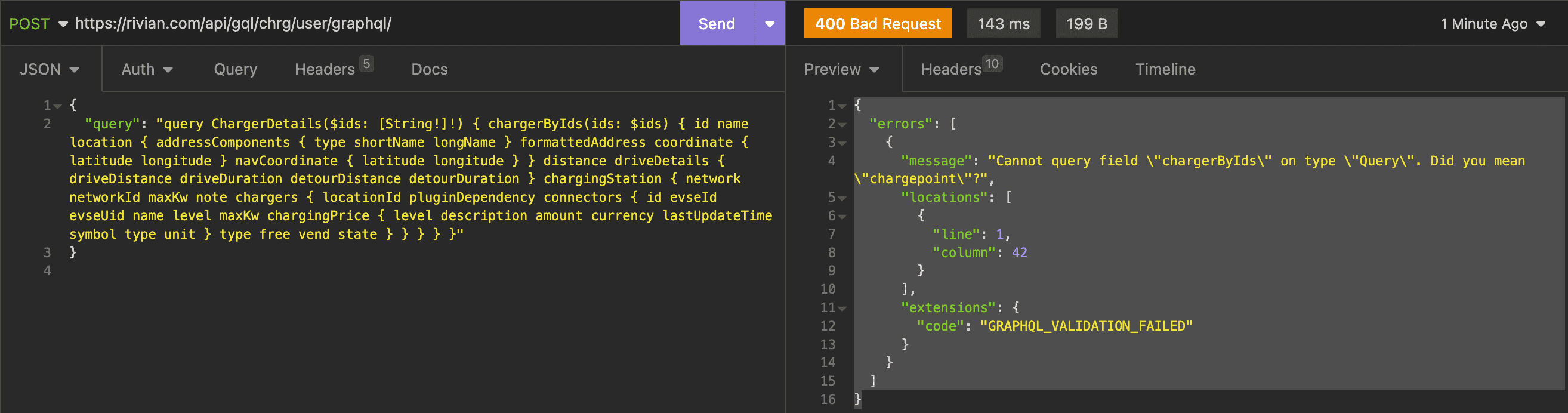

Is there a way to programmatically read the status of specific public chargers?
I'd try something along these lines.
Code:
"query ChargerDetails($ids: [String!]!) { chargerByIds(ids: $ids) { id name location { addressComponents { type shortName longName } formattedAddress coordinate { latitude longitude } navCoordinate { latitude longitude } } distance driveDetails { driveDistance driveDuration detourDistance detourDuration } chargingStation { network networkId maxKw note chargers { locationId pluginDependency connectors { id evseId evseUid name level maxKw chargingPrice { level description amount currency lastUpdateTime symbol type unit } type free vend state } } } } }"
For a bunch of charger related APIs from Rivian, see:
https://rivian-api.kaedenb.org/app/charging

I tried running that but got this error:
Code:
    "errors": [
            "message": "Cannot query field \"chargerByIds\" on type \"Query\". Did you mean \"chargepoint\"?",
            "locations": [
                    "line": 1,
                    "column": 42
            "extensions": {
                "code": "GRAPHQL_VALIDATION_FAILED"
Code:
    "errors": [
            "locations": [
                    "line": 1,
                    "column": 42
            "extensions": {

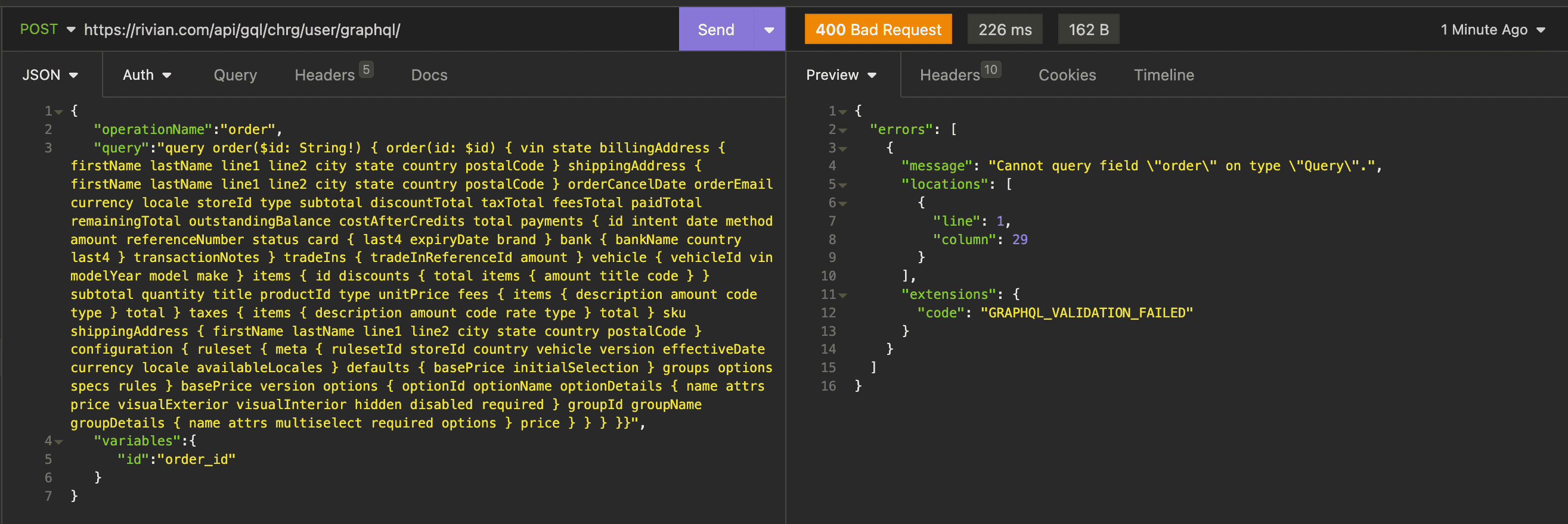

You'd have to include the operation name and variables in the query if you're not already, like:
Code:
query = {
"operationName": "order",
"query": "query order($id: String!) { order(id: $id) { vin state billingAddress { firstName lastName line1 line2 city state country postalCode } shippingAddress { firstName lastName line1 line2 city state country postalCode } orderCancelDate orderEmail currency locale storeId type subtotal discountTotal taxTotal feesTotal paidTotal remainingTotal outstandingBalance costAfterCredits total payments { id intent date method amount referenceNumber status card { last4 expiryDate brand } bank { bankName country last4 } transactionNotes } tradeIns { tradeInReferenceId amount } vehicle { vehicleId vin modelYear model make } items { id discounts { total items { amount title code } } subtotal quantity title productId type unitPrice fees { items { description amount code type } total } taxes { items { description amount code rate type } total } sku shippingAddress { firstName lastName line1 line2 city state country postalCode } configuration { ruleset { meta { rulesetId storeId country vehicle version effectiveDate currency locale availableLocales } defaults { basePrice initialSelection } groups options specs rules } basePrice version options { optionId optionName optionDetails { name attrs price visualExterior visualInterior hidden disabled required } groupId groupName groupDetails { name attrs multiselect required options } price } } } }}",
"variables": {"id": order_id},
I tried the code you have and received a very similar response. Other basic API functions are working as expected.
So you have to pass in the order_id, you're passing in a string "order_id" at least from what I can see. The example I shared didnt have order_id quoted as its a variable containing the order_id.
