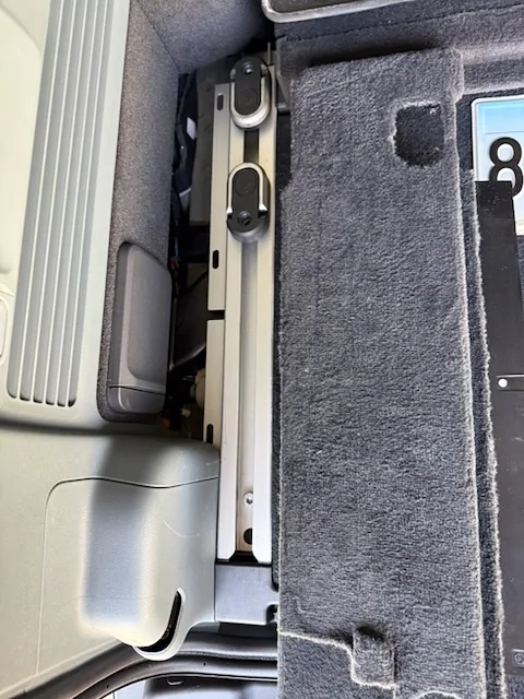

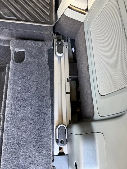

I'm currently in the middle of doing this. I purchased a set of rails from eBay, which came with 2 sliders, but I bought 2 more sliders so I could utilize the cargo divider and also strap some down.
To complete the project, I need to create/use a part of the removed carpet/plastic that fills between the rail and the side of the car.
It was not hard, just remove the D-Ring bolts, tailgate flap, spare tire liners, and lastly the carpet/plastic board where the D-Rings were. All holes line up when you are placing the new rails in.
This is my progress so far:
Rivian R1T R1S Retrofitting R1S cargo rails and adjustable tie‑downs. Anyone done this? D-Ring-to-Cargo-Rails-left
Rivian R1T R1S Retrofitting R1S cargo rails and adjustable tie‑downs. Anyone done this? D-Ring-to-Cargo-Rails-right
