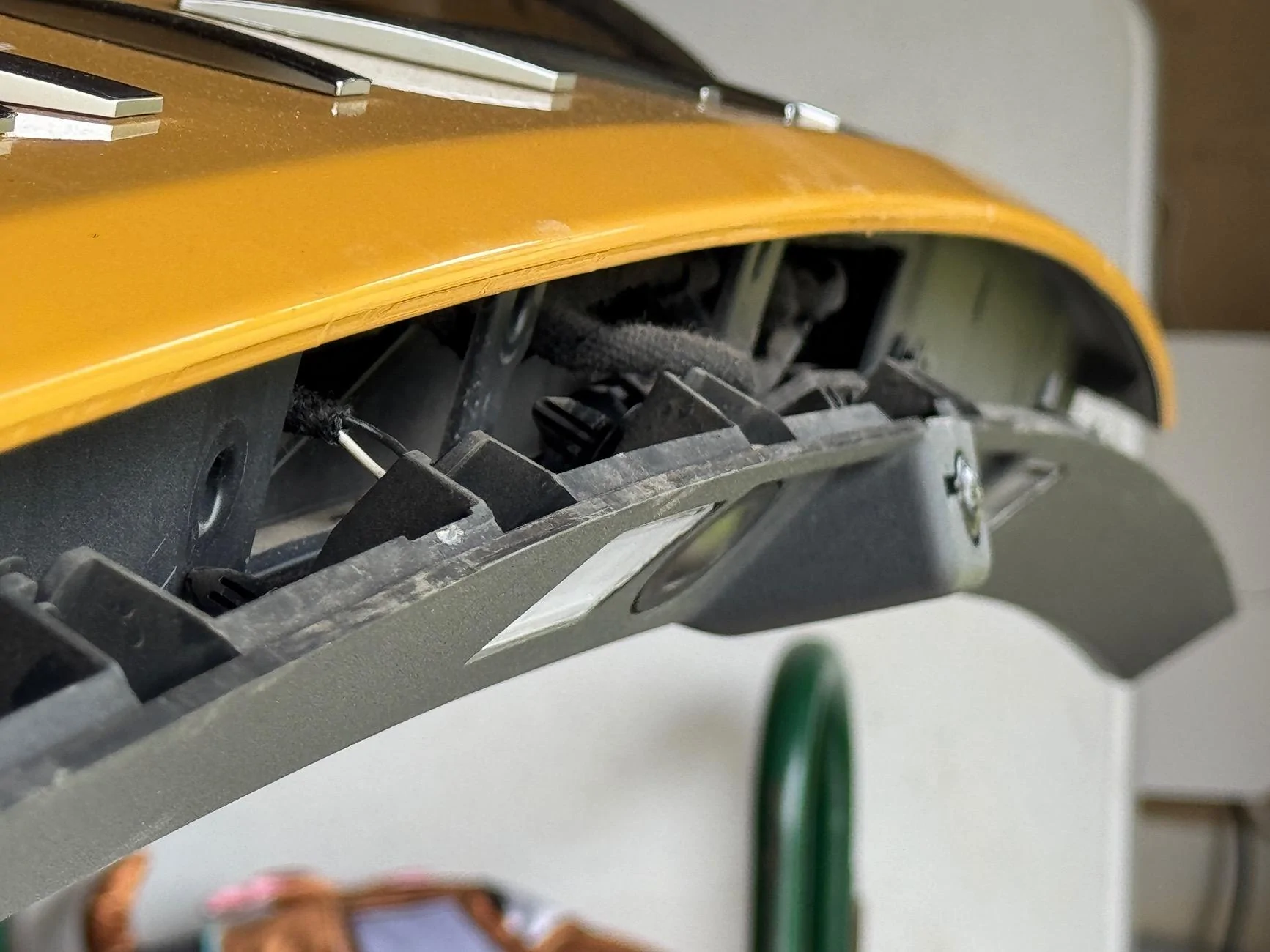

For the R1S it’s about 10 clips and 2 screws. Pretty easy to access imo, @Polar also had a pretty breezy time I think. It’s the same on gen1 and gen2.
On the R1T, though, it’s a bit more difficult. More clips and more screws. We are still trying to see if there is an easier way to do it, but regardless, it’s definitely doable.
Use of trim removeal tools is VERY helpful.
@Soju1
In the below image you can see the clip locations and mount designs. When I have a moment I’ll pop off the panel again to get a better image of the locations. The camera is just two torx screws (and two clips - coax and hose) to remove from the panel itself.
Rivian R1T R1S Rear Camera View Swingaway Relocation IMG_4837
@Soju1
As a part of the kit I’ll be adding some spare clips too in case they happen to break when trying to remove them.

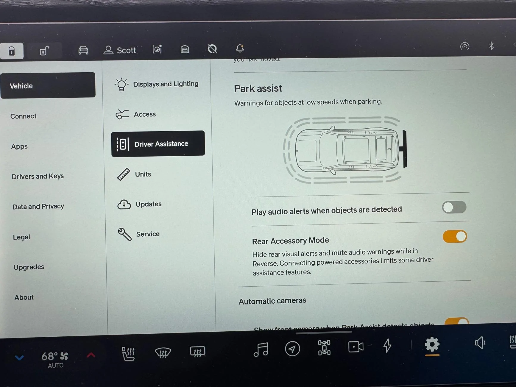

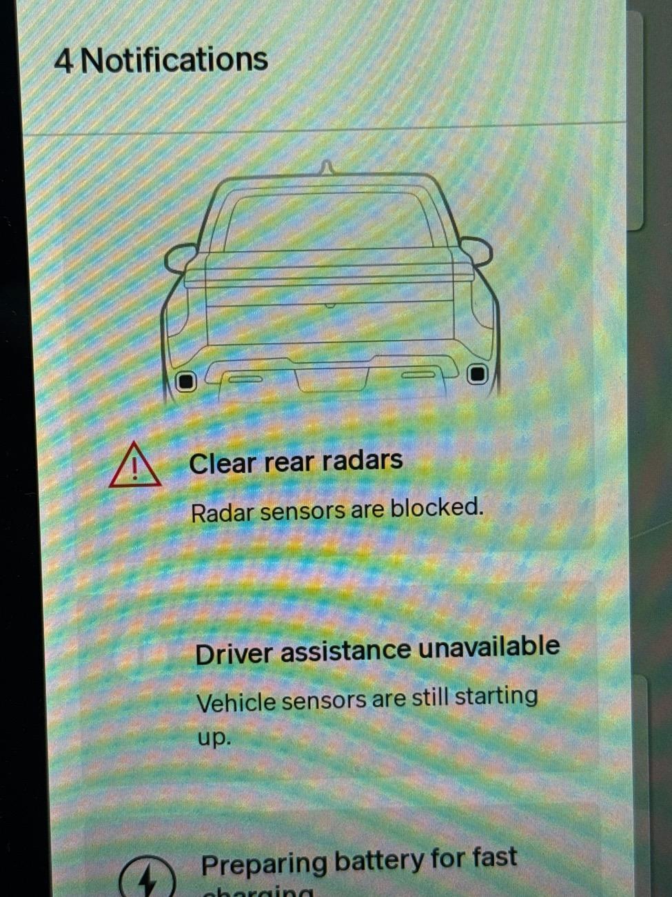

Sorta related.. just got the rigid swing carrier for my R1s. It blocks the reverse sensors and camera, but does anyone else get rear radar errors also? Could you all lmk its driving me nuts and want to make sure its not a actual issue!
thank you!

This camera thing is great!
thank you!
changing the below setting is what cleared that error for me
Rivian R1T R1S Rear Camera View Swingaway Relocation IMG_5138
