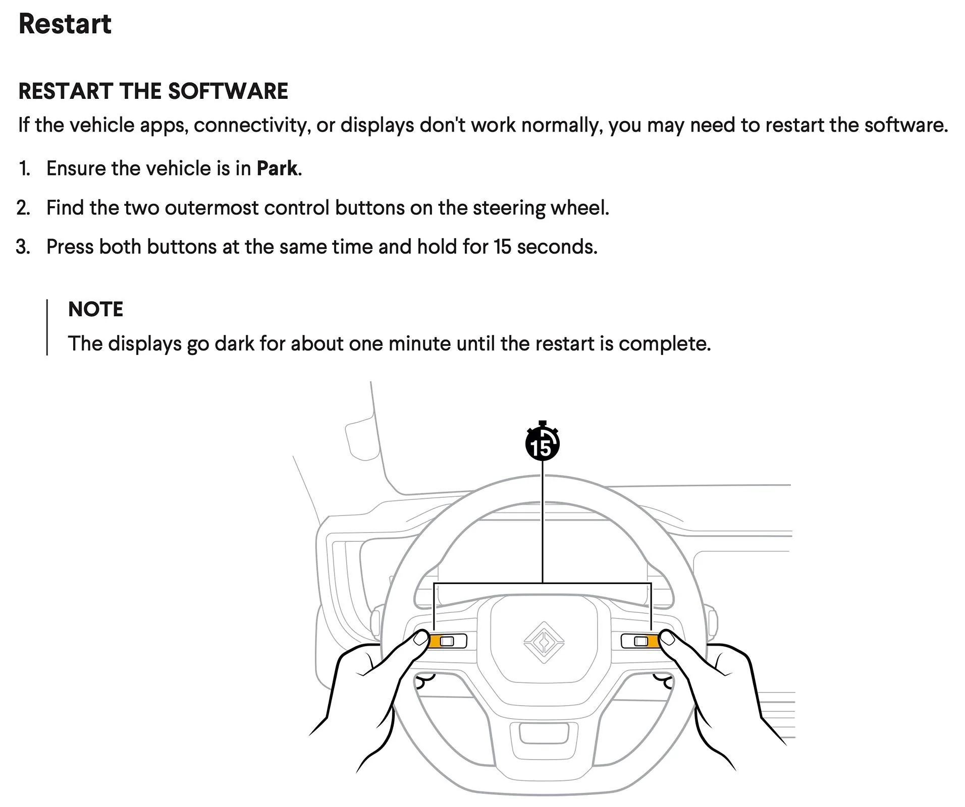

I'll claim ignorance here & don't know what a two button infotainment reset is, anyone point me in that direction?
34,494
Rivian R1T R1S RADIO NOT CONNECTING Image 1-30-24 at 10.50 AM

You're a lifesaver, it worked immediately. Thx
